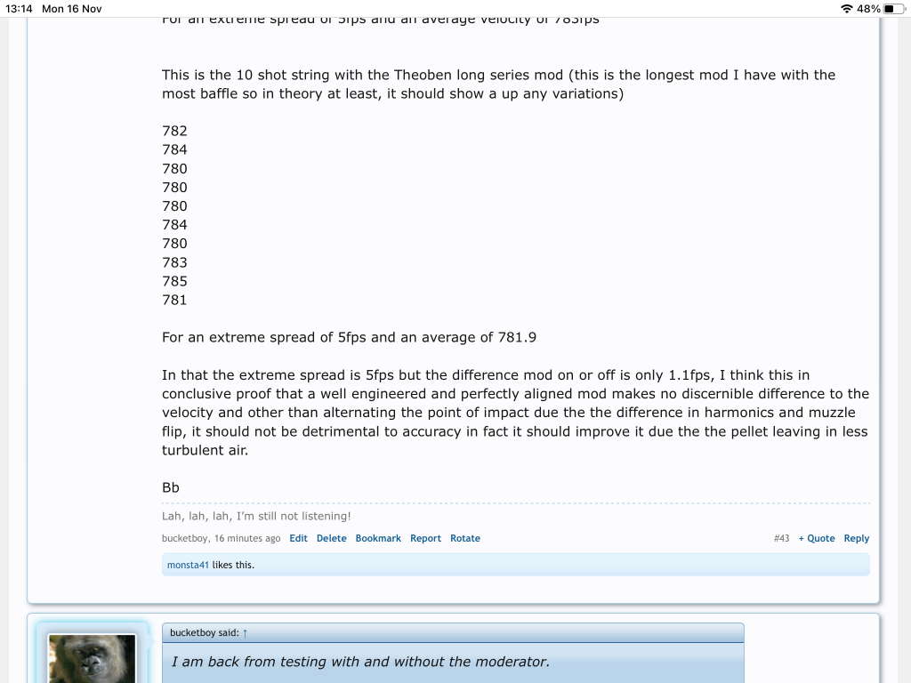

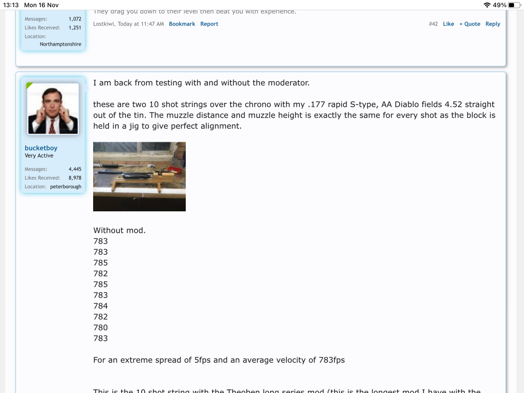

I stand by my statement “all things being equal” there shouldn’t be a poi shift.

Bb

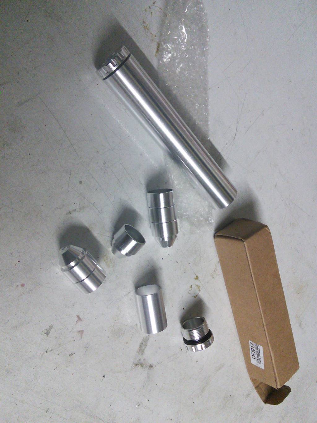

(For baffles I am intrigued by low cost alu oil filters shipped in via the Silk Road ...)
