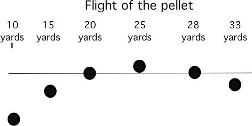

I watch a lot of pesting videos and I've noticed that some of these guys (from the rangefinder readings on the screen) are using a 'dead on' hold at ranges from 8 yards out to 50 or so yards. With my Benji .22, I'm sighted at 20 yards and at about 10 yards I have to hold at least 2" low or I'm just "Buzzing the Tower" so to speak.
Does my rifle have that much of a rainbow trajectory, or are their rifles shooting that flat? Could they be making scope adjustments off camera or am I 'missing' something else?

Hello one major factor in regards to pellet trajectory is hight of optic above bore line and what distance you zero your gun at. If you use one of the online ballistic calculators you can find your flattest curve. You will need the hight of optic above bore line, muzzle velocity, pellet weight, and pellet coefficient. Then just play with the zero distance till you find your flatest curve. Then shoot at each distance to confirm. One other thing make sure you set the program for one yard intervals. Hope this helps you Eric.
poi will be about 1" low at 10 yards if zero'd at 20 yards. Not high "buzzing the tower"

I can't comment on every pesting video, but the majority I watch like Air Hunters, and Matt Dubber mark the elevation turret ahead of time, range the shot, adjust the scope off camera, then hold dead on or nearly dead on for shots. You can also use the ATN and similar optics. What velocities are you shooting? At air gun ranges, going from 650 fps to 920fps makes a huge ballistic difference. Also, watching shows with slugs versus pellets will give you the illusion they are getting better ballistics with pellets. Pellets shoot about half as flat as slugs because of the Ball coefficient, but that is really more relevant beyond 50yd.
