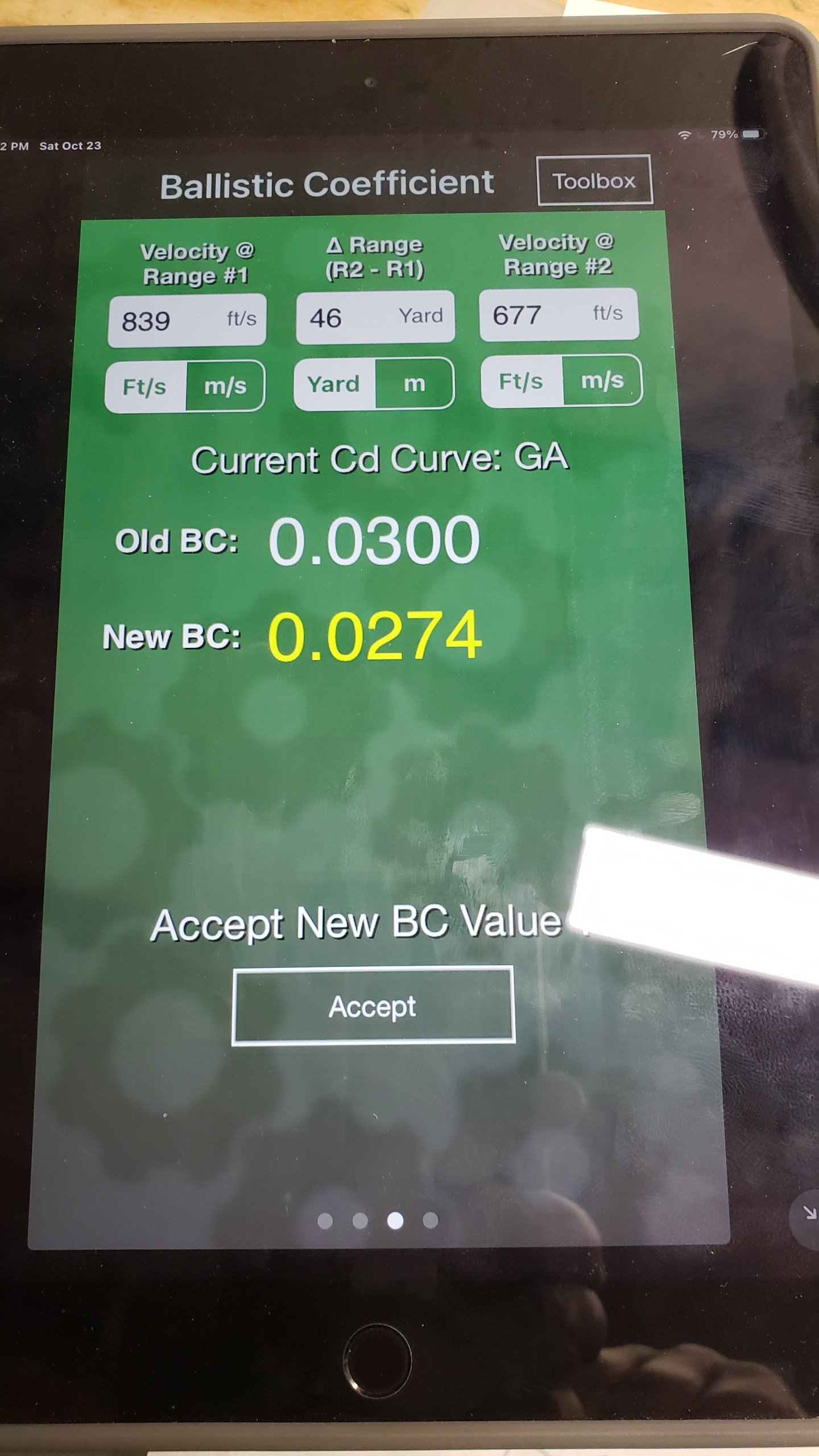

I tested pellet BC using my rifles and two different chronographs spread out 30 yards or more. Some were close and some were far off the advertised value. For instance H&N states the 20 cal FTT has a dismal BC of .015. That's worse than a 7 gr 177 dome. That was concerning given my then increasing interest in 20 caliber. I tested them at 46 yards apart from my R1 and the actual BC was 0.0274. That's a huge improvement over the advertised BC. Using the Actual BC from my rifle the calculators work well within shooter error.

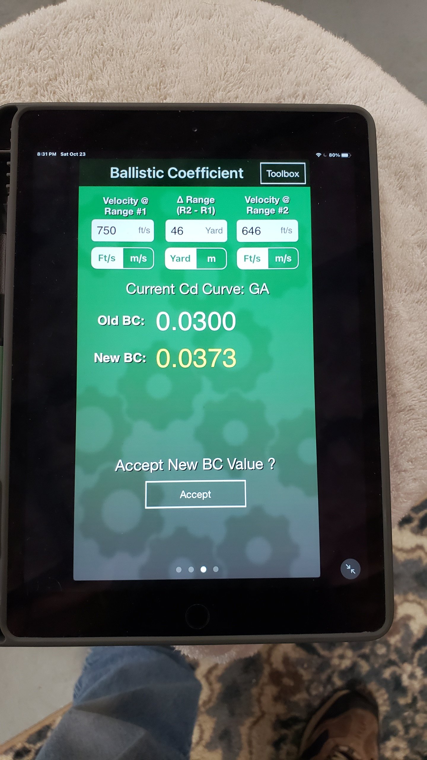

Fwiw the JSB 13.73 20 cal tested to have a much better BC of 0.0373

The app I used to calculate the BC was Chairgun for IPad. I have it on my Android phone as well. It's very useful for comparing trajectories and energy levels. However nothing beats actual field testing.
