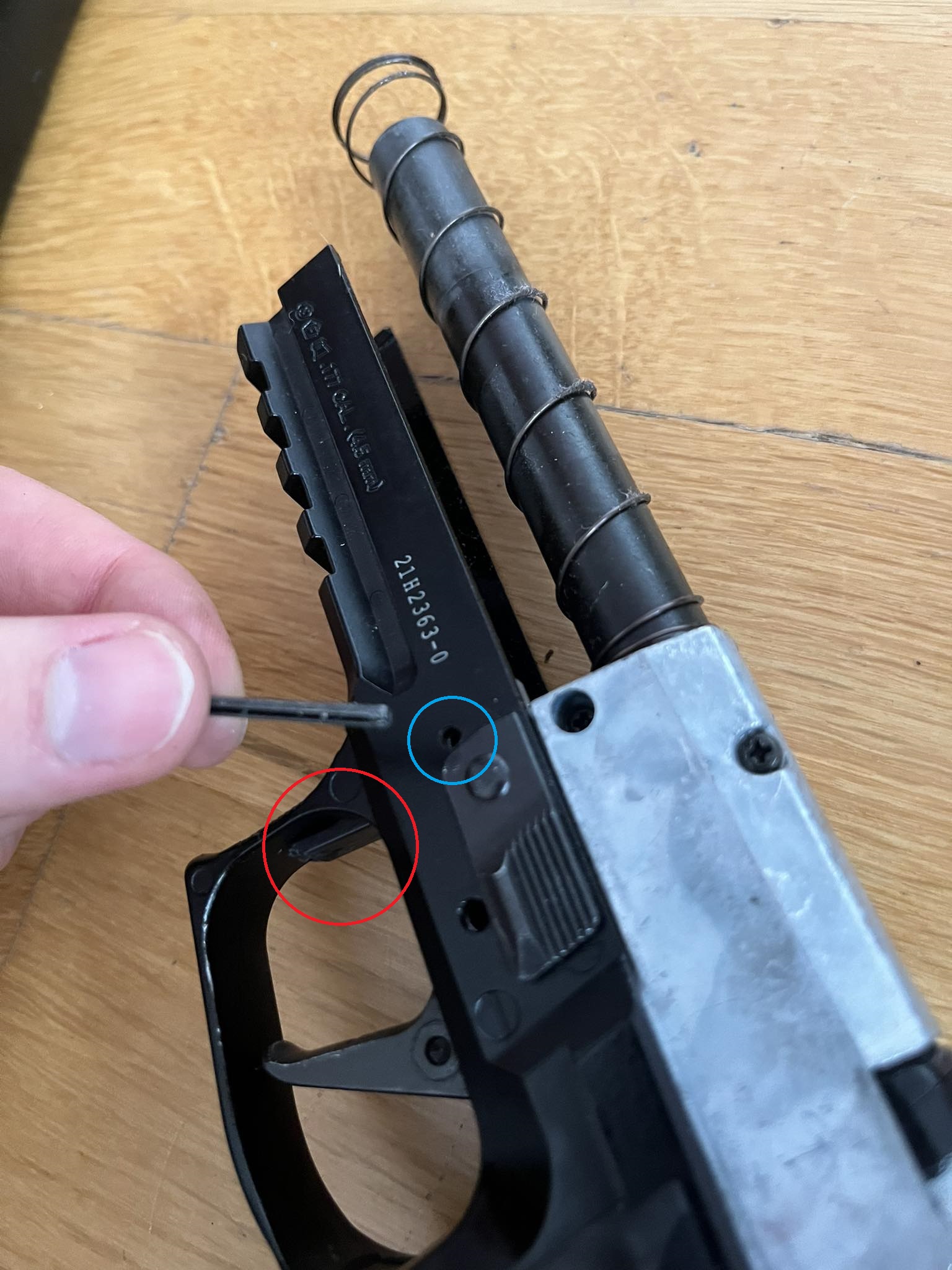

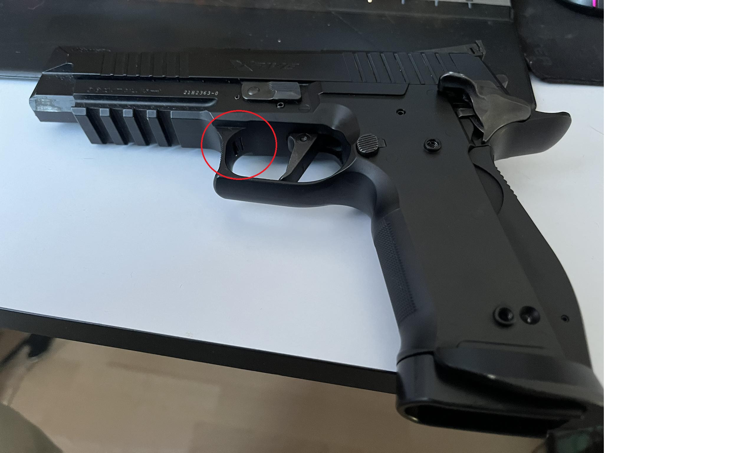

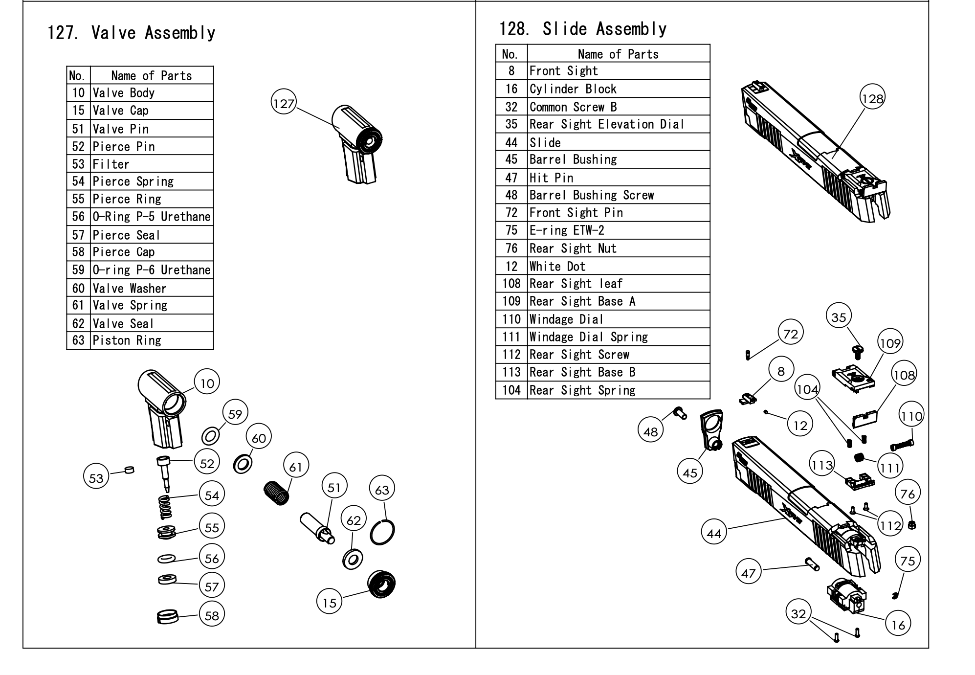

Hey, I got a problem with stuck pellet and I tried to disassemble the gun.
From another post, I know that removing the slide probably has to do with the pin marked in the picture.
But I can't knock this thing out. Any advice how to do it properly without damaging it?
Solution

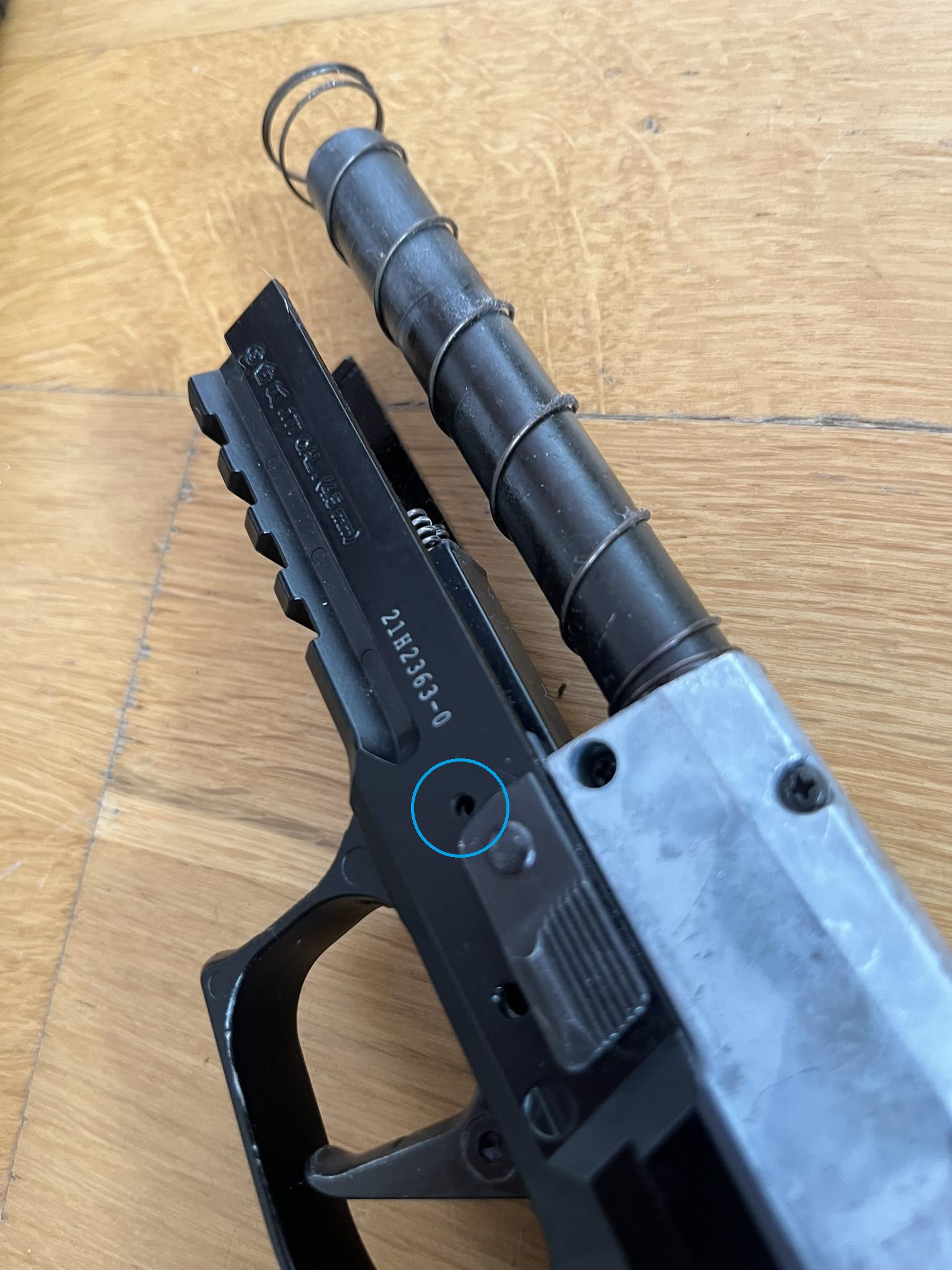

Ok, I wasn't familiar with this type of "hollow" pins, I assumed there is nothing in these holes. But it's exactly like dv8eod said, the pin is in the smaller circle next to the dummy take down lever. Knocked this out from right to left, and the slide blocker dropped from the area marked with red circle. Here are additional pictures that show how the slide blocker works. Thank You!
