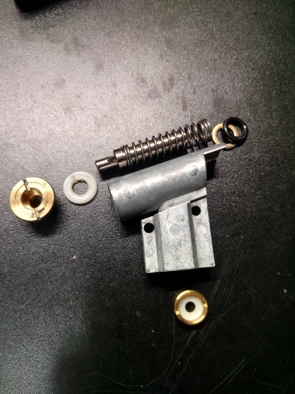

I decided to start my adventures on my SS P226. I've gotten down to the valve body so far but can't figure out how to remove the white nylon washer/retainer to release the center valve/reed and spring(see pic below). I've tried spinning and lightly pulling but it's in there pretty well. Any ideas?
So I used a little pick to pry up-and-out the nylon seal/retainer to release the reed valve and spring. There's a copper and rubber o-ring as well. You can see in the picture I may have damaged the nylon ring. I wonder if heating it in hot water would help remove the gouge I made or would sanding it work better. I think I'll see what I can find online(Ebay) as well. Anyways, while I get that corrected; to port the inlet valve with a drill bit, would you(JJ) suggest putting the reed valve in a vice and drill in at the same angle as the existing hole is at or can I drill in perpendicular to the reed?

For the life of me I can't find the correct nylon washer i damaged. I found complete SS P226 valve bodies for sale but not just the bits and pieces. Looks like I'm possibly out $30. I put everything back together after attempting to repair the washer to see if it'll hold pressure and not leak. I'll report what happens. Wish me luck....
Edit: After initial testing, I can confirm that the system doesn't appear to leak pressure, even with the marginally damaged nylon valve washer. Next time, I think I'll try pushing it out from the front end of the valve body instead of picking it out from the rear. With the valve pin hogged out(using dremel and carbide bits) and removing the brass balls filter from valve body housing inlet(falls out), I can report the difference is significant! It bucks like a 9mm now! So much so, it knocks my lower picatinny light/laser combo off! I can't wait to try these mods on my MCX next.
