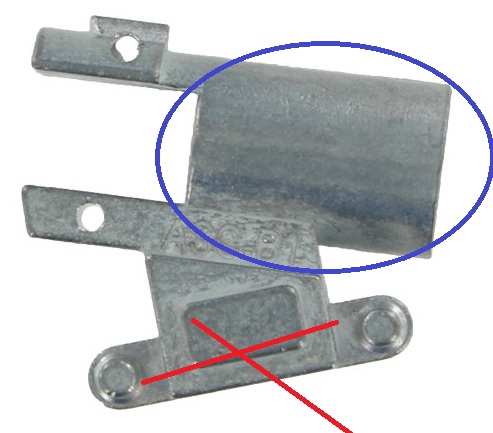

is this part that you drill ?

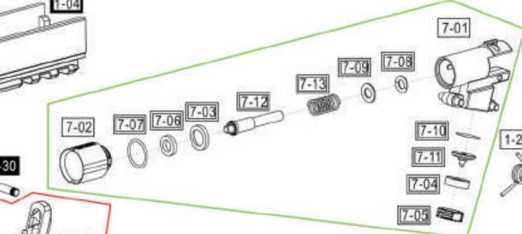

I added an explosion diagram of the pistol.
Can you explain by giving the corresponding part numbers?
