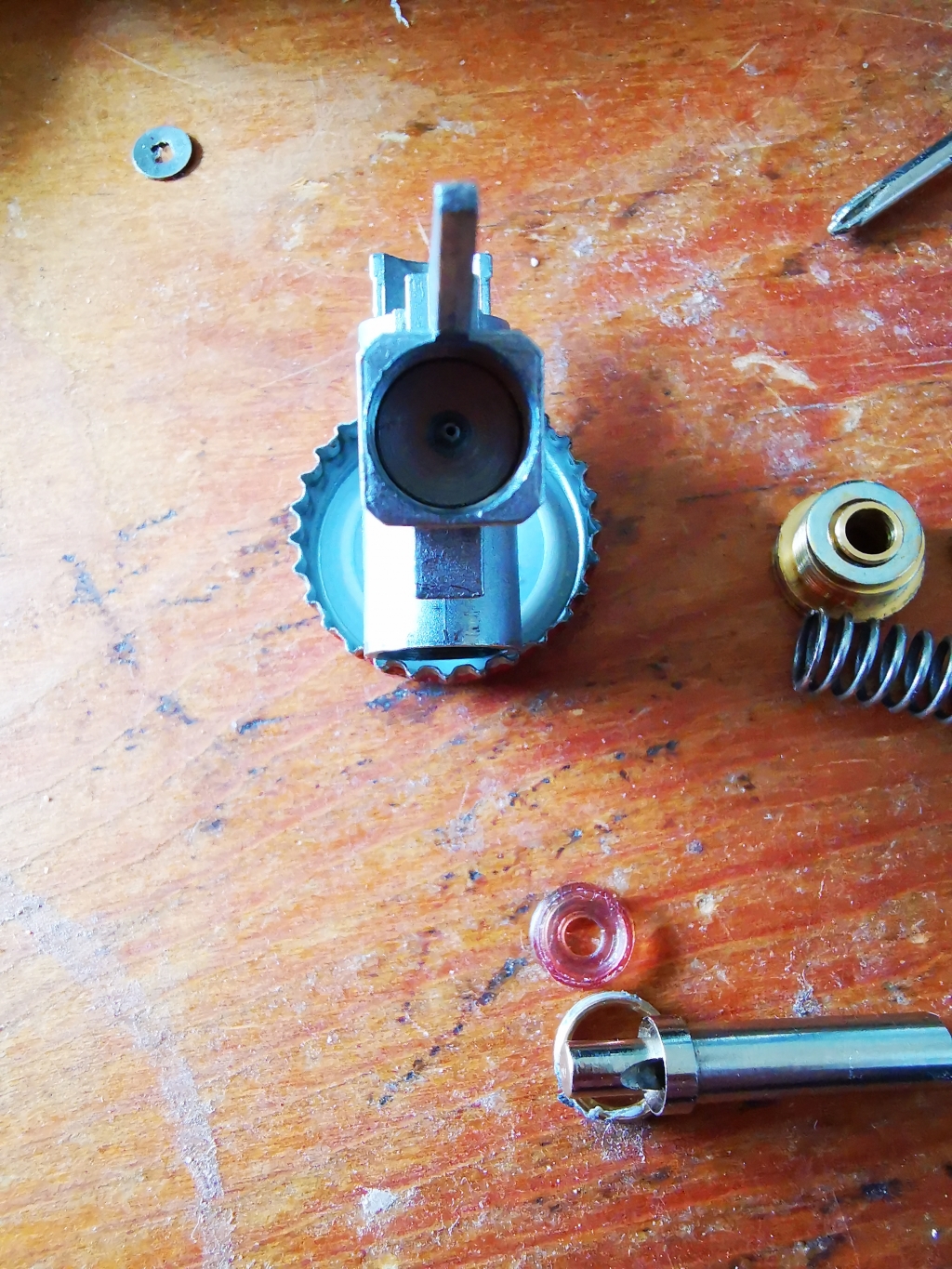

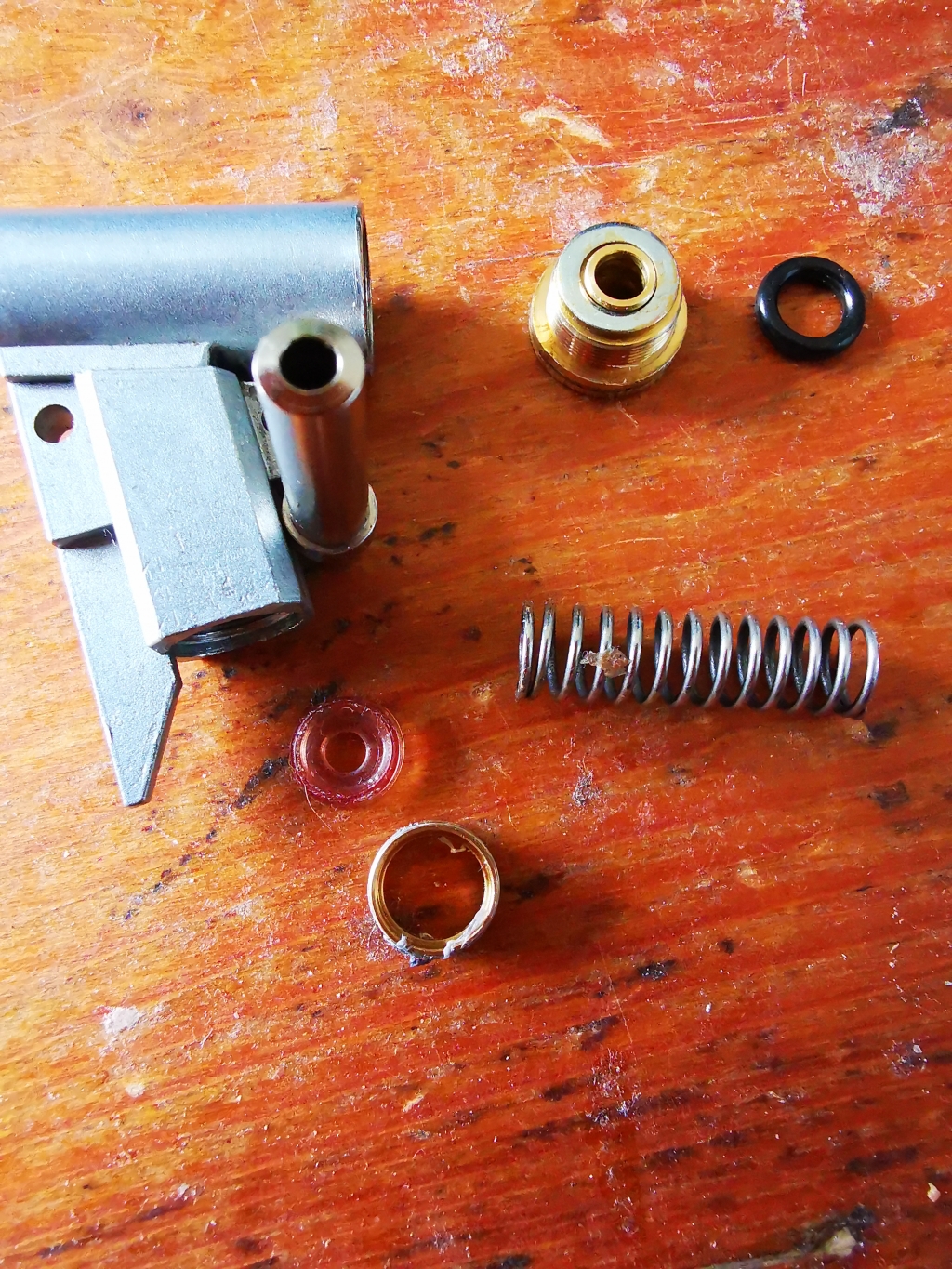

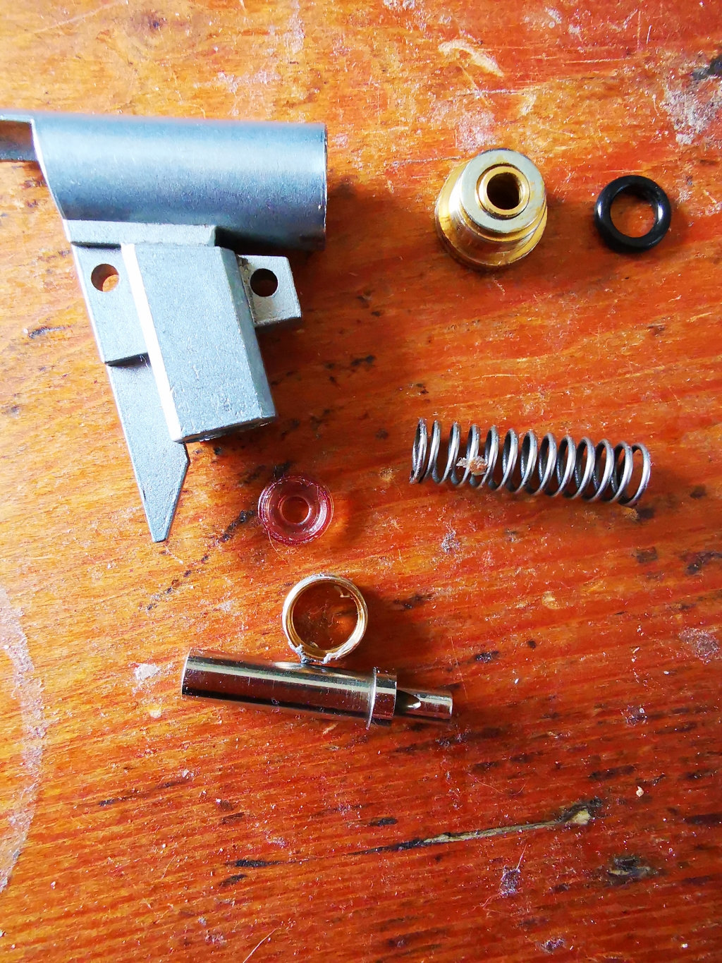

Hi, sorry to bother you again, i have sn old valve from my beretta px4 storm, i presume they are all similar? So i took some photos and hopefully you can tell me which areas need worked on, thanks.

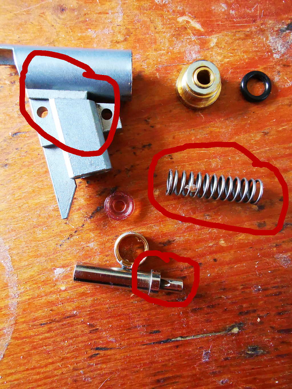

I put red circles around the areas of interest. You will need to bore ( drill ) out the valve body inlet which you can see is the large circled item in the picture. On the sig the body is separate from the c02 inlet so it will make sense when you pull the sig apart. The valve is all one unit and self contained. Secondly you can bore out the valve stem. This is the second piece circled that is a chrome cylinder shape. Be careful when doing this, if you go to large it wont seal.
Next, the valve close spring controls the dwell ( how long the valve stays open after the hammer hits ) if you can find a spring the same length but with less tension you can add extra power from this. I put in a spring with about half the tension and it worked good. This allowed like 1/3 more c02 to get through each shot. Less shot count but WAY more power. What you are basically doing, because its c02 and you can not up the pressure, you are trying to flow as much c02 through as possible.
Finally, when you take apart the sig you will see the big blow back spring. After the above modifications you can put a much more tension spring in there. I think the blow back on those are way to loose. But in stock form the gun doesn't have enough poser to cycle with a tighter spring.
