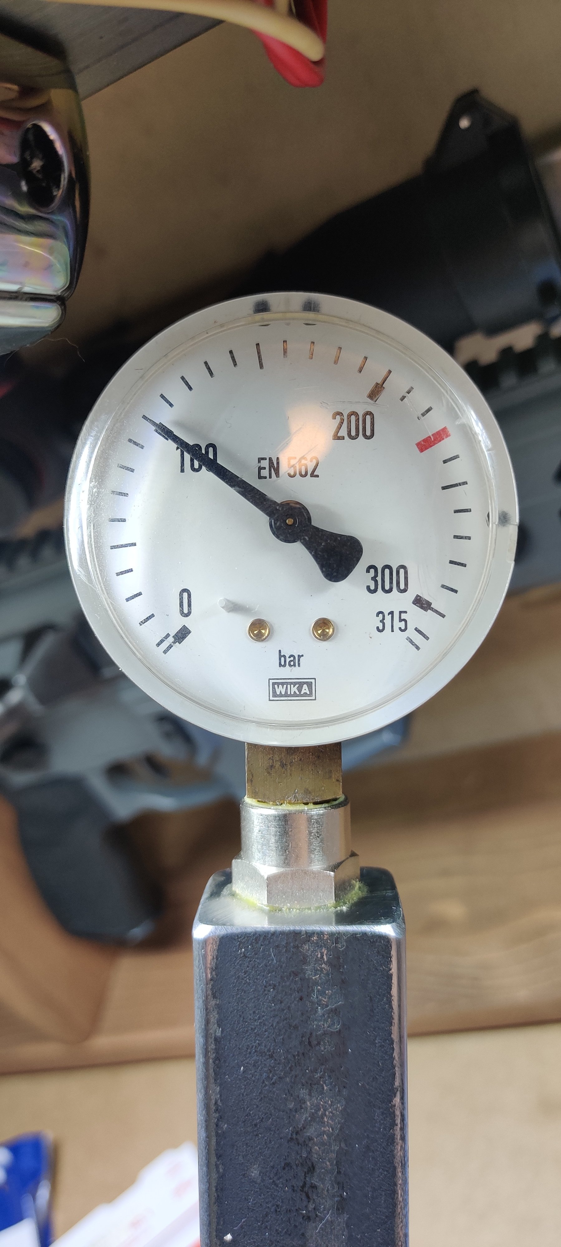

I bought an adapter which makes ASA airtanks to fit a 88g co2 cartridge thread. As if wanna put the airtank on a co2 rifle.
But instead I took a bar of steel and drilled straight thru it. Then made rhreads at both ends. The adapter in one end - and a gas pressure gauge (from a welding gas tank regulator) in the other end. Kind of an DIY pressure tester. Has worked well, and the quite large gas gauge gives quite well readable readings..
Sorry. No pic of it fully. But it is just a bar of iron with a gauge and the adapter threaded in..
