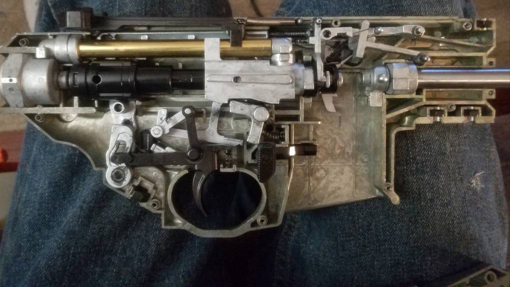

I snapped a photo while I had it open. The biggest thing to be aware of is to try and make sure that when you separate the two halves you don't get parts that want to stay with the top half and some that want to stay with the bottom. It could be a bit of a mess trying to figure out location and orientation of some of the smaller parts.

Thanks for the pic. I belive the gun is made by Tokyo Marui. The size of air tube and inlet looks large enough to handle any TP increase.
I have picked up a .22 semi auto since I bought the Sig .177s so I will see if I can tune up one of those first. Thanks for the info, hopefully I can reciprocate once I crack it open. I have the set up to make parts if I need to. I will also see if I can get some seals, gasket, oring...from Marui or a US outfit. I appreciate the info and pics.
