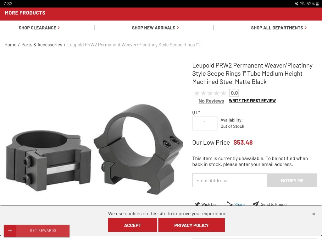

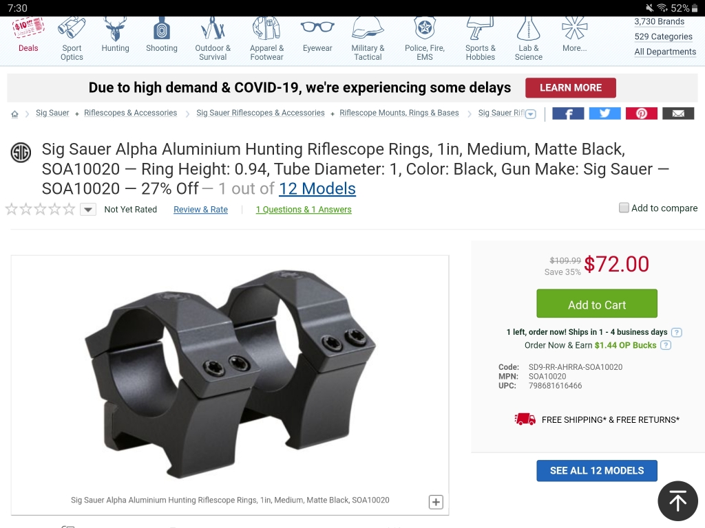

Hi Glen ! So you now have the Whiskey3 ASP scope on your ASP20? What do you think ? I had the windage dial keep coming loose on mine and some change in POI issues with mine. Sig sent me a brand new one. I haven't mounted it yet. Sig representatives told me that the standard Weaver style rings with the round cross pin are still subject to movement in picatinny notches. They recommend the square cross pin type that fully fills the picatinny notch. They recommended a few that were steel and one aluminum set. Here are a couple that I'm interested in. The steel are cheaper but I'm concerned about adding additional weight to the already heavy ASP20.
Aluminum Sig
Leupold steel

Edit....and I hate to say it, but I'd probably go with the aluminum. Even though the weight difference will be negligible when compared to the overall weight, I'd still like to think I'm shaving unecessary bulk, even if the actual benefit is psychological
