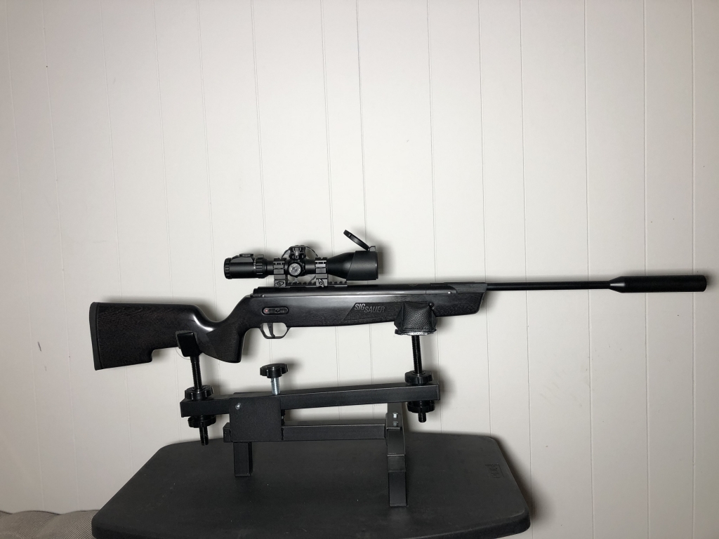

I consistently get 22-24 ftlbs out of my .22 SiG asp. My personal taste would be the ASP because I love the stock, fit and finish.

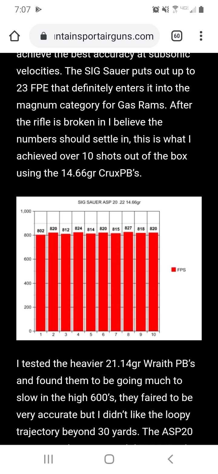

Glen....at what temperature did you shoot those velocities? The reps at Sig said they based their velocity/ energy figures at 70 deg. The Sig facility is at 100 ft above sea level. Also, my tin of the Sig Crux lead pellets had very few that were 14.7 gr. Say 10%. The bulk of them were in the 15 to 15.2 gr range. In warmer weather my Sig shoots 15 gr Crux pellets @ 835 fps. I also shoot the 21.14 gr lead Wraith in the 685 fps range. Have you tried the Wraith alloy pellets ? Very accurate!

Hey!
Those aren't mine, remember I have the dreaded .177 (just kidding, i do love it, but if i were to do it again I'd go .22).
I am getting around 917 fps with the .177 in 10.65 grain putting me near 19.9 FPE at arounf 70degrees F and 196 ft elevation.
