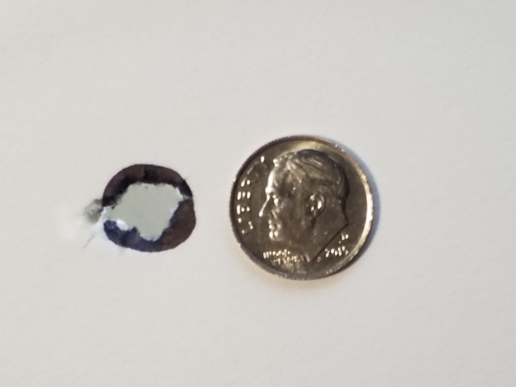

I love mine in .22cal. Have yet to try any longer range accuracy testing but from my 30-33ft tests the gun shoots as accurate as any German springer I have owned. This 5 shot group was at 32ft with the 14.7gr Sig Crux lead pellet. I pulled the last shot to left. My bad! 865fps at muzzle.

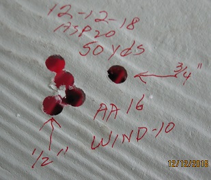

The cocking effort. Sweet ! As advertised! I agree that you can't make a sole decision on this review. There are several reviews on the ASP20. So check them out.
