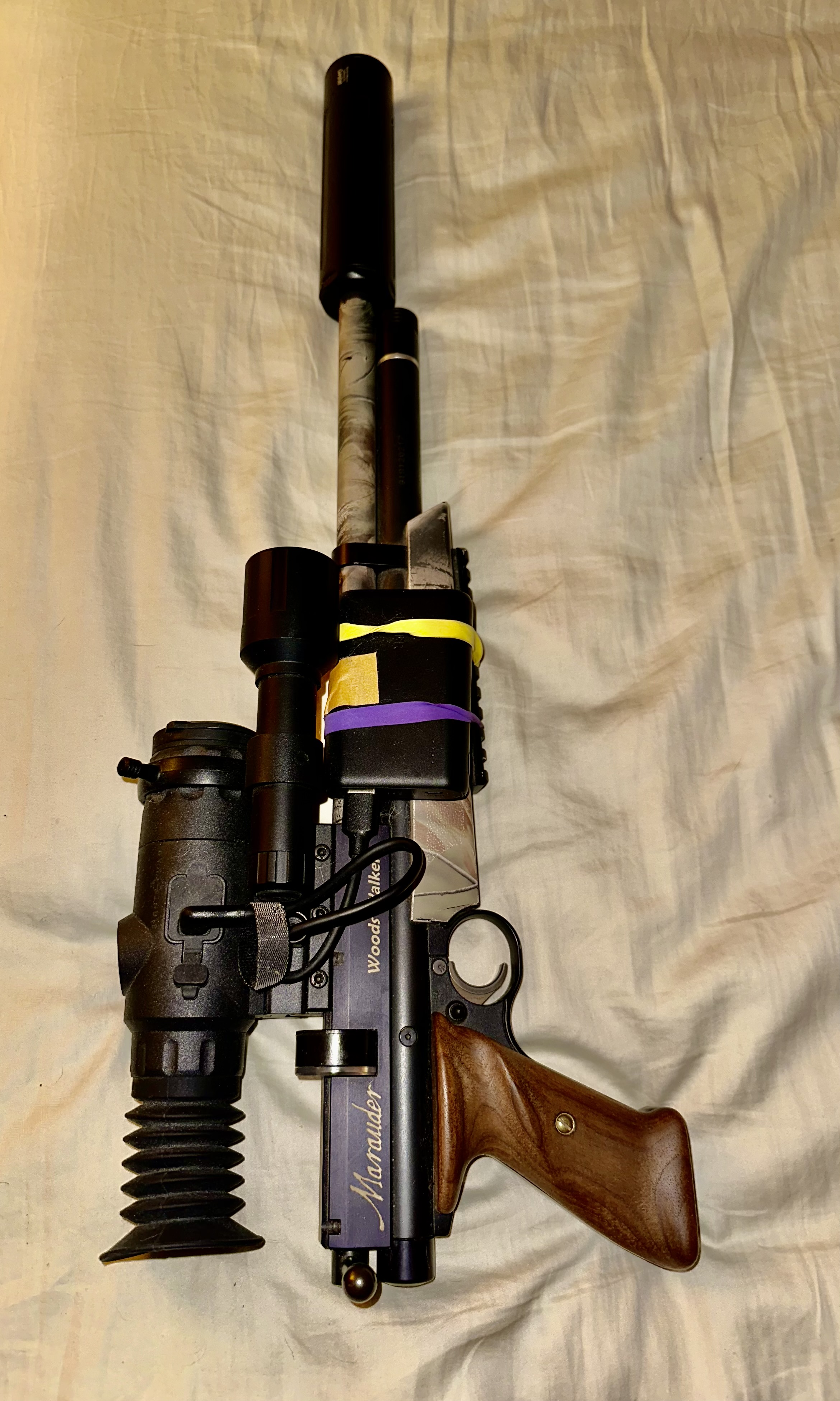

I think that my GK1 is the bomb, but if I’m wearing my sensible hat, I’d take one of several other guns to do any of the things on your list. Especially if I wanted to be stealthy. The GK1 is a noisy beast even at low power with the most effective mod, out of >15 that I’ve tried. It’s a novelty gun, super fun to shoot but numerous quirks, including not really being able to make it safe for backpacking. I’ll likely get flamed by the crew for dissing it. I second Leon’s suggestions and, if you can live with a detachable stock and a bit of tuning, this little thing is proving to be great:

I bought a folding stock attachment for this and a nice stock but it all had so much wiggle in it that I want to make sure what I get is solid. I’ll check out the Ranger and Pathfinder. I know I like the looks of the Atomic.
I believe you can get a detachable, solid stock for your Prod… A much cheaper option than buying a new gun. The usage scenarios you describe beg for a small, discreet gun. I had a Wraith Mini atop my Atomic XR for a short while, it was a killer setup. Am presently awaiting delivery of an Arken Zulus.
I have the plastic detachable stock that the prod comes with but the cheek weld is too low and the eye relief is wrong for my scope. I thought about building a new one out of some wood I have but the overall length would be getting long. That’s why I started thinking a Bullpup was my best option.
