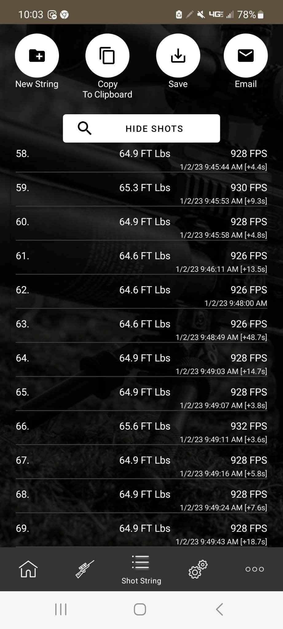

I have mine tuned right now for 33.95 , this is with 4-7 mph cross winds, 34 rounds at 77 yards. The rifle will out shoot me, I was also looking through a digital scope setup for hunting, this is a hunting rifle, if I had better glass this likely could be tightened up but this is phenomenal for that many shots. I am only filling to 4100 psi, getting 2.5 magazines per fill. I just bought the huben hand pump and I am going to pump it to 5000 psi and get total shots per maximum fill.

70 shots per fill with that power is enough for a hunting trip!!

So that is .25 caliber so 2.5 magazines (17 rounds per mag) off 4100 fill comes out to 42, and I only counted that when I was shooting them over 1000 fps, Id suspect at 5000 fill and tuned where I have it in the chrono picture id say 3 to 4 magazines but I will 100% find out and report back.

I look at the picture of your string that why I said 70.
