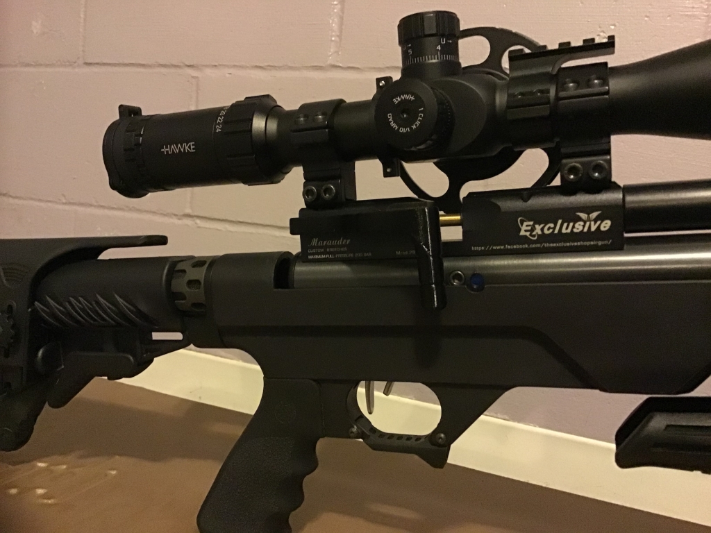

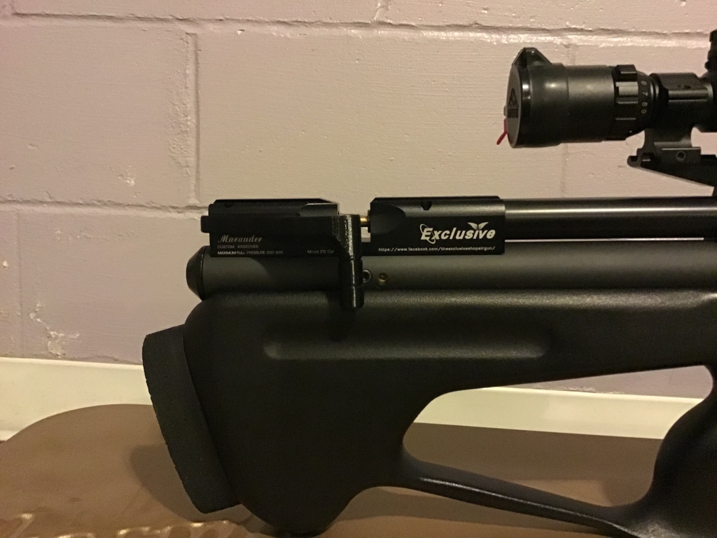

Yup the Custom Air unit it is not for the Prod but is a far better breech than the Exclusive which suffers from the usual Chinese fitment and fastener issues. Still in the end it does lock up tight and werq fine. Kind of like comparing a VW bug of the 60's to a new Cadillac though.

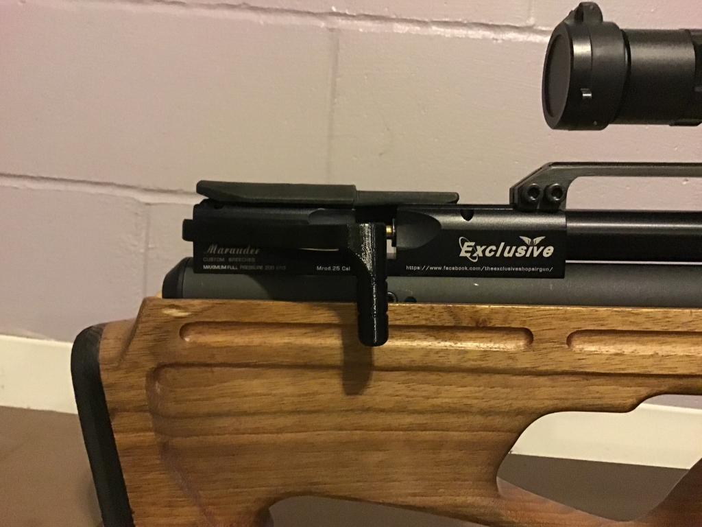

As I posted earlier, the Exclusive breech is decent on lock up and cocks a heavy hammer spring like butter. I personally asked for the biathlon lever from Suriya but didn’t wait for it to come out. I had Papy_Yosh (Eric) custom print me some. I also told him (Suriya) to make some for the rifle in .22 cal too, and laser etch some of his .25s for .30 cal. I also suggested he make a breech with a picatinny rail. Time will tell if he makes more changes. Save yourself some money and buy direct from him through his Facebook page. 3 days shipping FedEx Express from Thailand. Here’s pictures of the 3D printed levers from Eric.

I bought one for my prod. I switched it to lefty, tightened the sidelever.
I at first had the air coming back and a loud discharge noise, I refused to believe it was the barrel o’ring as it did not make that noise with the oem breech. Fuzzygrub convinced me to replace the o’ring. I did and it cured the air and noise. The breech has also stopped the frequent double feeds caused by feeding a pellet, but not cocking. The lever is so positive you just do not have the feeding and cocking problems.
I love it.
