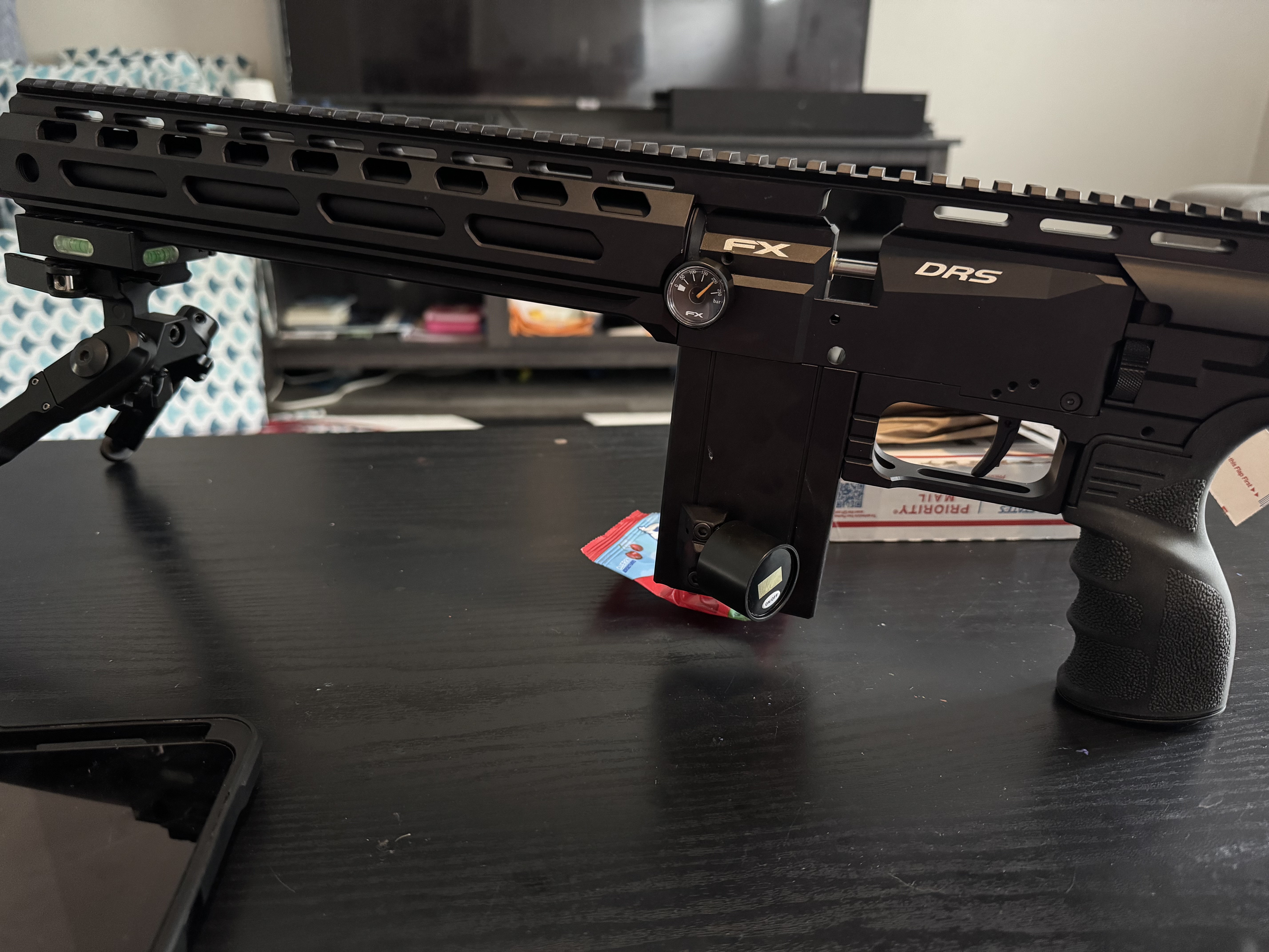

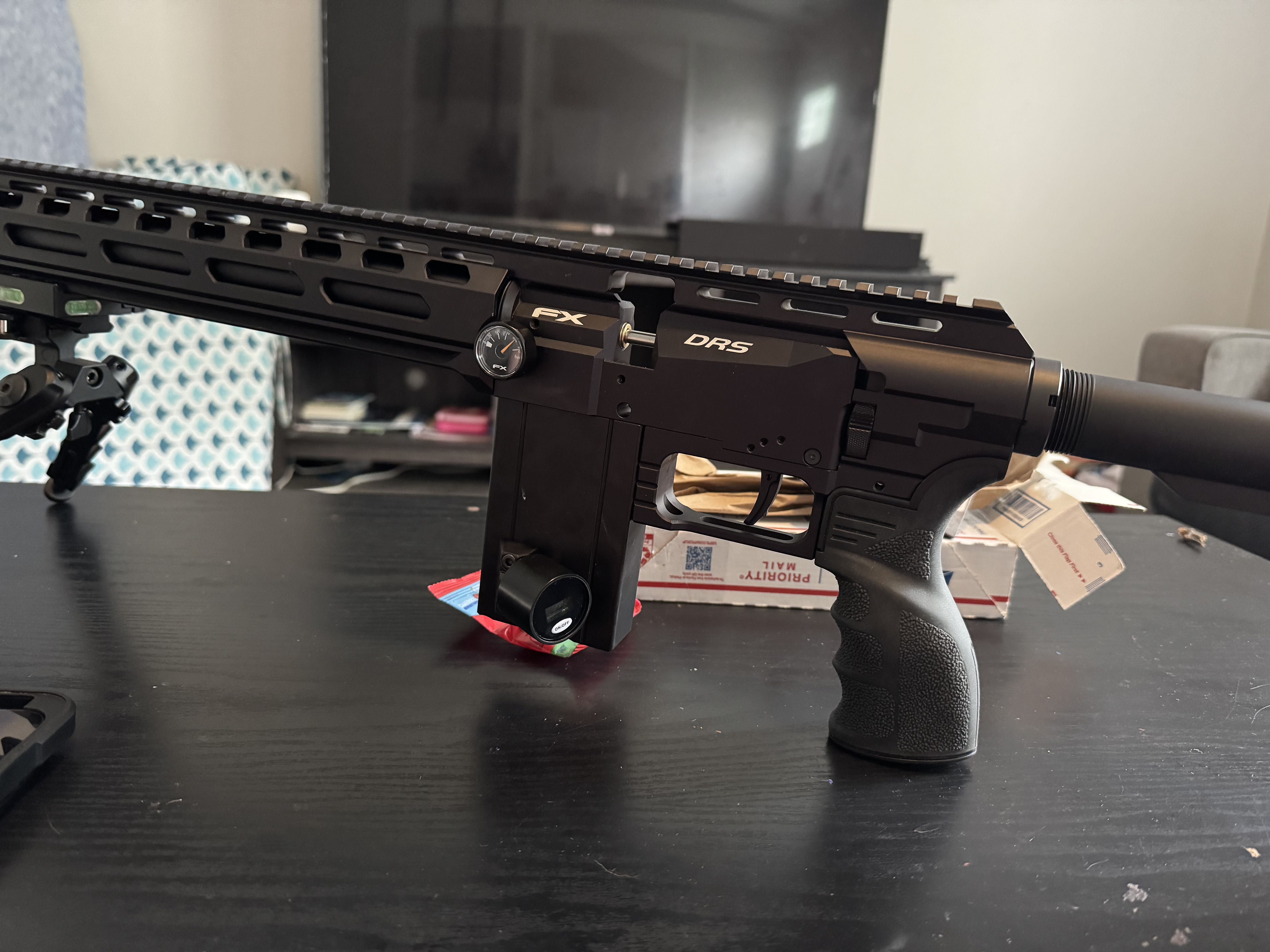

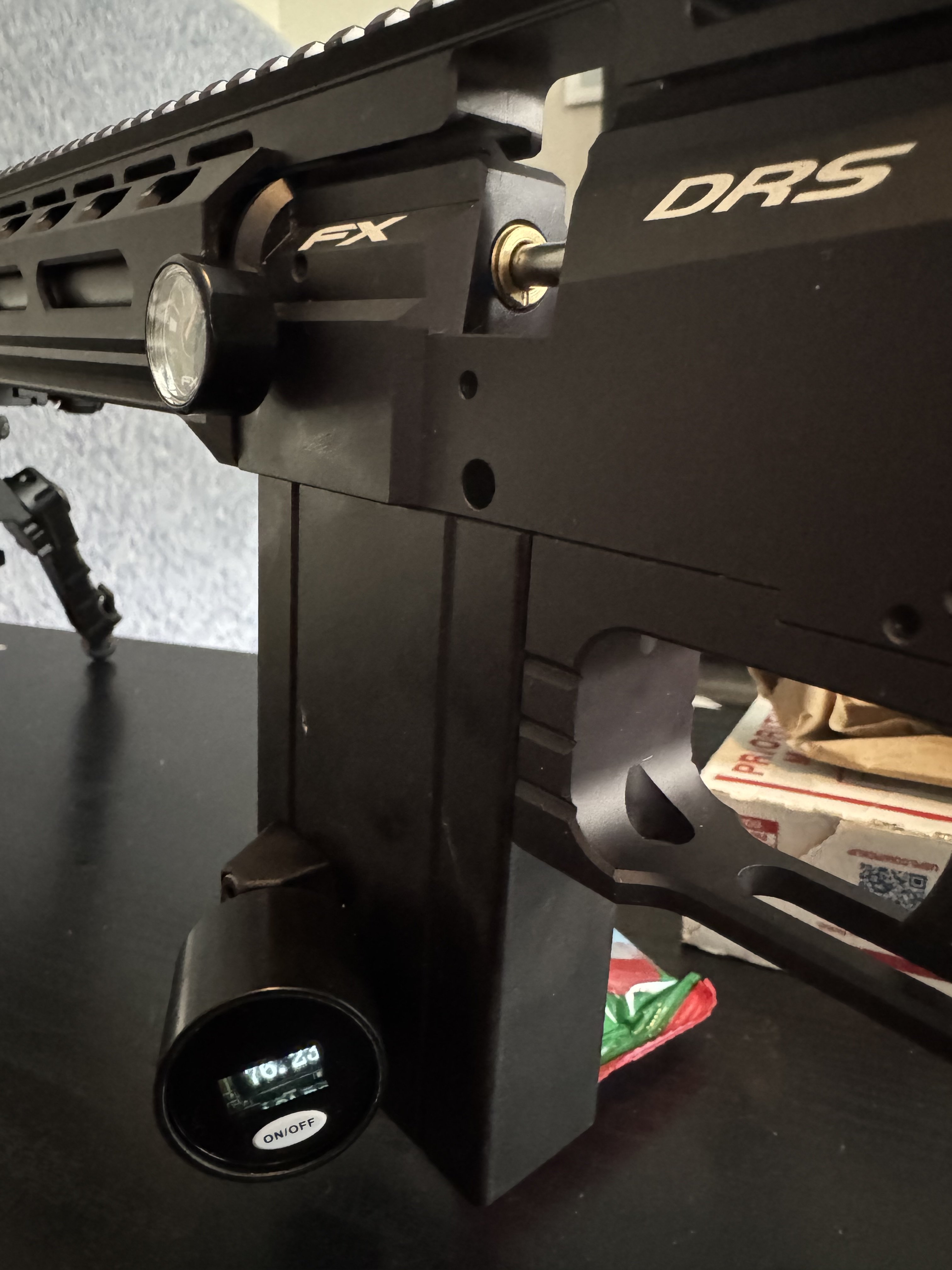

Game changer in my opinion! The SHP plenum attaches with no problem to the DRS tactical. Provides a lot more power capabilities and easy to view reg pressure with the angled gauge. Just wanted to let y’all know
Very true. I had a classic and was not fond of that problem. The tactical solves that. I’m really liking it so farI like my DRS Classic, but dislike that a plenum/regulator pressure gauge cannot be installed without creating the stock removal issue
Which tactical do you have (caliber and barrel length)? And what kind of performance gains do you see? Thanks.Game changer in my opinion! The SHP plenum attaches with no problem to the DRS tactical. Provides a lot more power capabilities and easy to view reg pressure with the angled gauge. Just wanted to let y’all know
I agree completely but this is on the drs tactical. You don’t need to remove the angled gauge to adjust reg or hammer spring. Also this is adding much more plenum volume. I only have the reg at 98 right now and have the 21g javelins zooming at 950fpsI won't deny the good looks of a nice wood stock, nor the PITA that the angled gauge becomes when wanting to remove the stock.
In my use, I've set the reg pressure using the angled gauge, and then removed it. Problem solved. If I need to re-adjust the reg, I'll re-install the angled gauge.
was this plug and play no modification to put ?Game changer in my opinion! The SHP plenum attaches with no problem to the DRS tactical. Provides a lot more power capabilities and easy to view reg pressure with the angled gauge. Just wanted to let y’all know
very cool how much power can it get out of it with that plenum lets say turn it up to 160 bar with something over 30 grains im very curious and how many shot counts you would get@daigo - No modifications. Take off the old one and replace it with the SHP. Just remember to put the stock on before you add the 2nd guage (with the DRS classic... I can't speak for the DRS T)
Nice ain't had time to shoot minesGame changer in my opinion! The SHP plenum attaches with no problem to the DRS tactical. Provides a lot more power capabilities and easy to view reg pressure with the angled gauge. Just wanted to let y’all know
I live down in South Florida, and we have tons of iguanas and it makes quick work of themNice,i have so many dont get time to shoot them,I have the pro too. Will do some shooting when I get back
