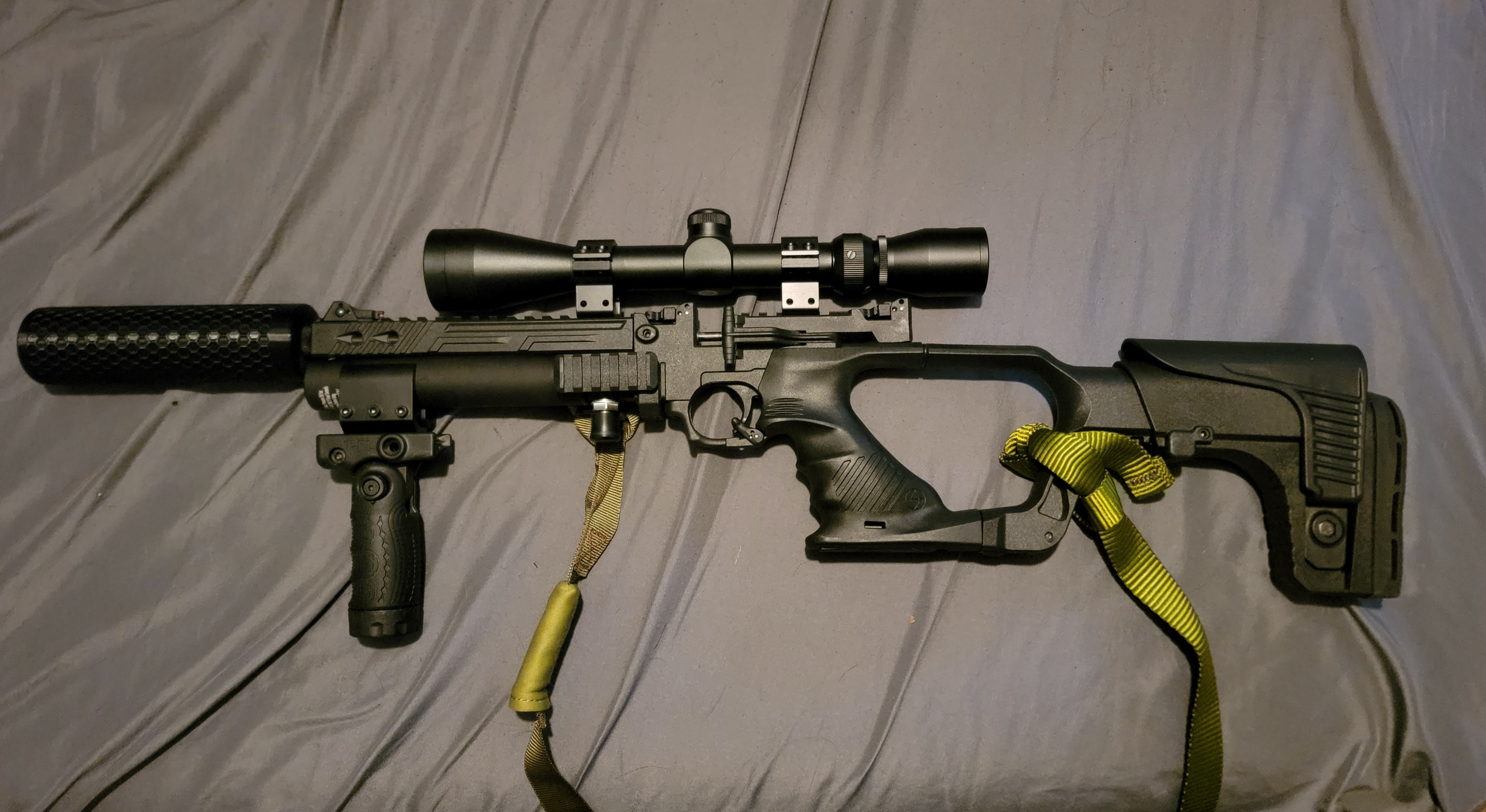

Bringing this back up since our season is about to end and I'm working on my next season's gun. I wanted a thumbhole stock for my mini 25 mega I made and the only one Kral has is for a bottle gun. I had the mega stock already, and almost sold it off, but kept coming back to the idea of bonding the 2 stocks together.
It needs to be finished up, but I just got it pinned together and fixed with fiberglass resin. Probably going to finish it up this weekend and smoothed out. Most likely matte black finish or go with a camo job.
Tuned for 24 shots at 800 fps with polymags and they stack out to 50 so far, which will be my limit anyhow with this gun. This is also the only gun I've ever had shoot the crow magnums with accuracy. It's actually giving me one hole groups with them as long as I sort the pellets. Those are going to be nasty hitting a squirrel's noggin!
She's all of 33.5" long and under 8lbs scoped with bipod. Quiet enough to not alert the neighbors either.
You do some really cool work with the Krals! If you ever want to do a writeup on that mini bullpup you did, I'd love to take a look at making one for my wife.
Pretty simple, you just gotta buy 2 or 3 guns to make one out of and have a bunch of parts scattered everywhere!
Really though, you need an np03 and a breaker. Swap tube and barrel on to the breaker and cut the stock down for the length of the tube. I cut 1.5" off the butt as well to get it as compact as I could.
You could run the breaker shroud and tube on the np03 after, just need another short barrel if you want baffles vs a moderator at the end of a 20" barrel.
Best option is wait til they pop up cheap in the classifieds or refurb on PA. Can make one for $300-$500, depending where you get them both.

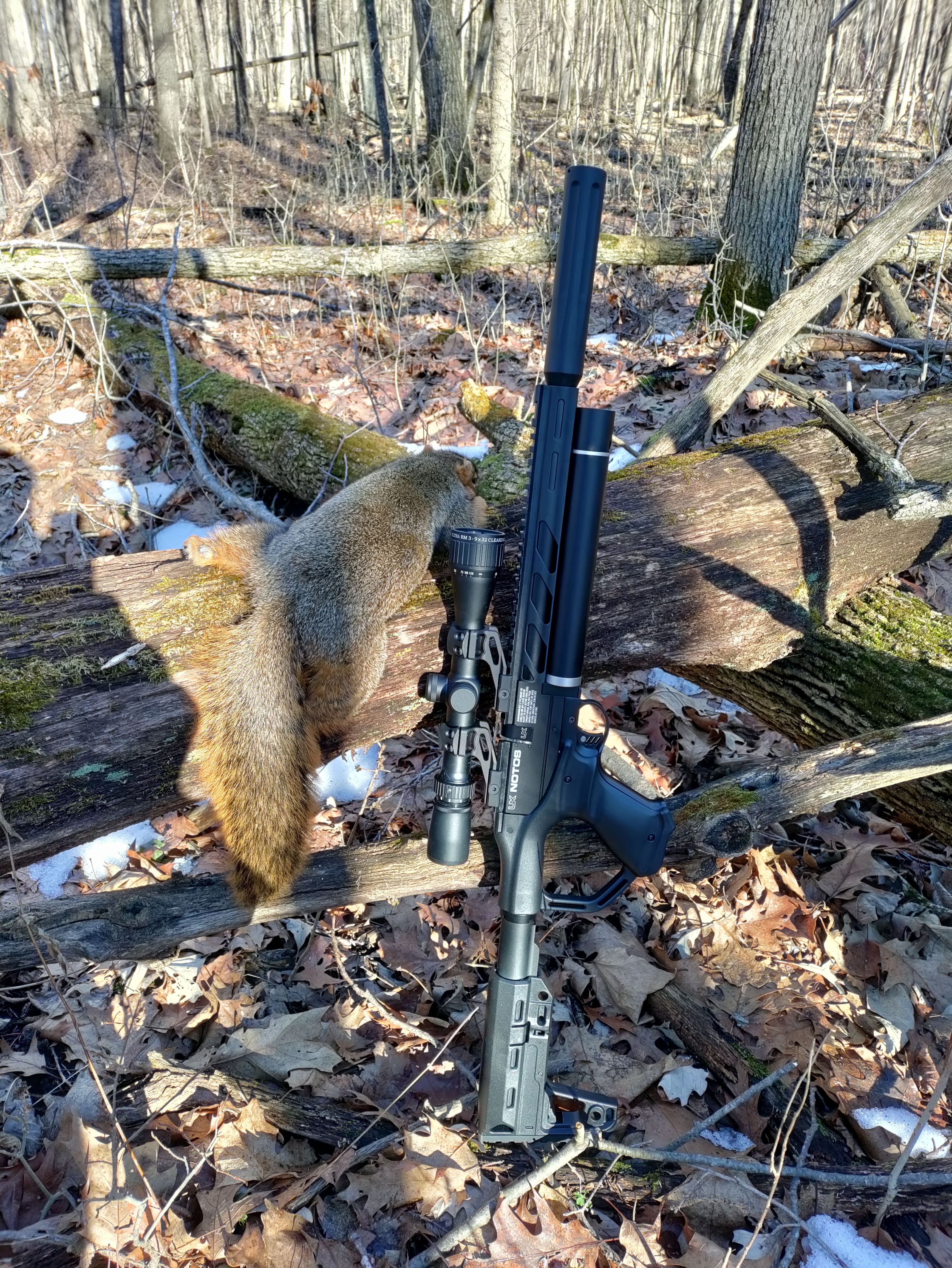

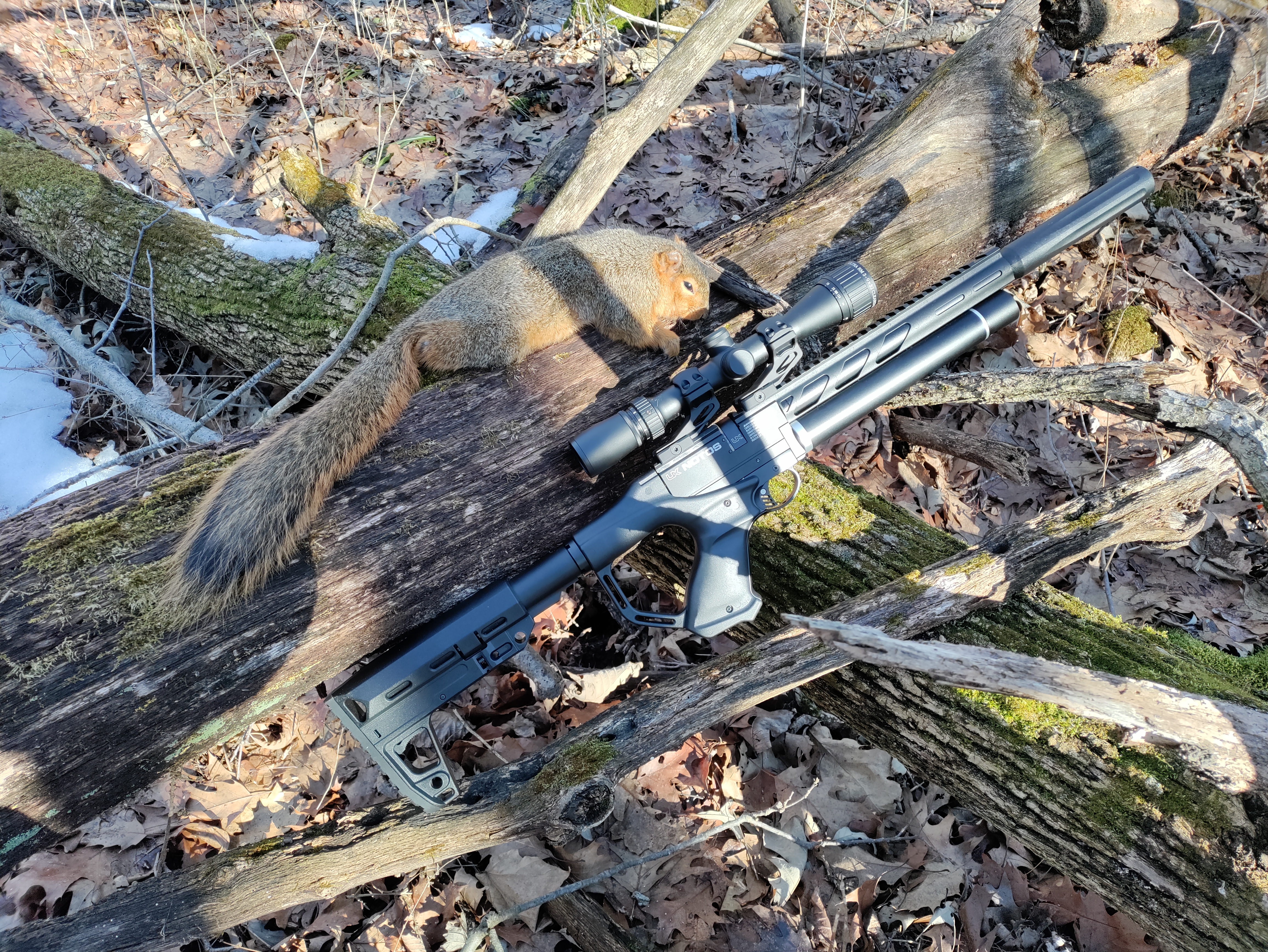

Just added another to the list today of my squirrel getters !
Notos is no slouch with some old stock 16 grain JSBs. Just keeps impressing me the more I shoot it! 😎👊🎯
44 yards today with one
mil hold over!
Zeroed at 30.
