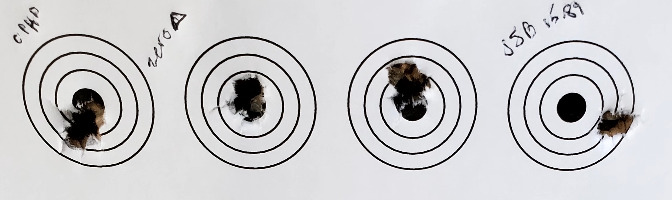

One last try to see if I can figure this out without voiding my warranty. I cleaned the barrel, filled to 200 bar, checked the barrel screws (thanks @hushpuppy ), double checked the scope and rings, kept it at the same tune as before for 850 +/- fps and here's the results. The left target is shooting Crosman 10.5 gr pellets and the right was shooting H&N 13 gr slugs. Same aim point, zero wind, 50 yds. Two of the 14 rounds with the Crosmans weren't even on paper. But just like last time I had a few that grouped very nicely but the rest were way off. One shot I actually saw fly an arc to the right and hitting about a foot off the POA. I sent an email to PA and I'm hoping they'll do the right thing and take it back without too much fuss.

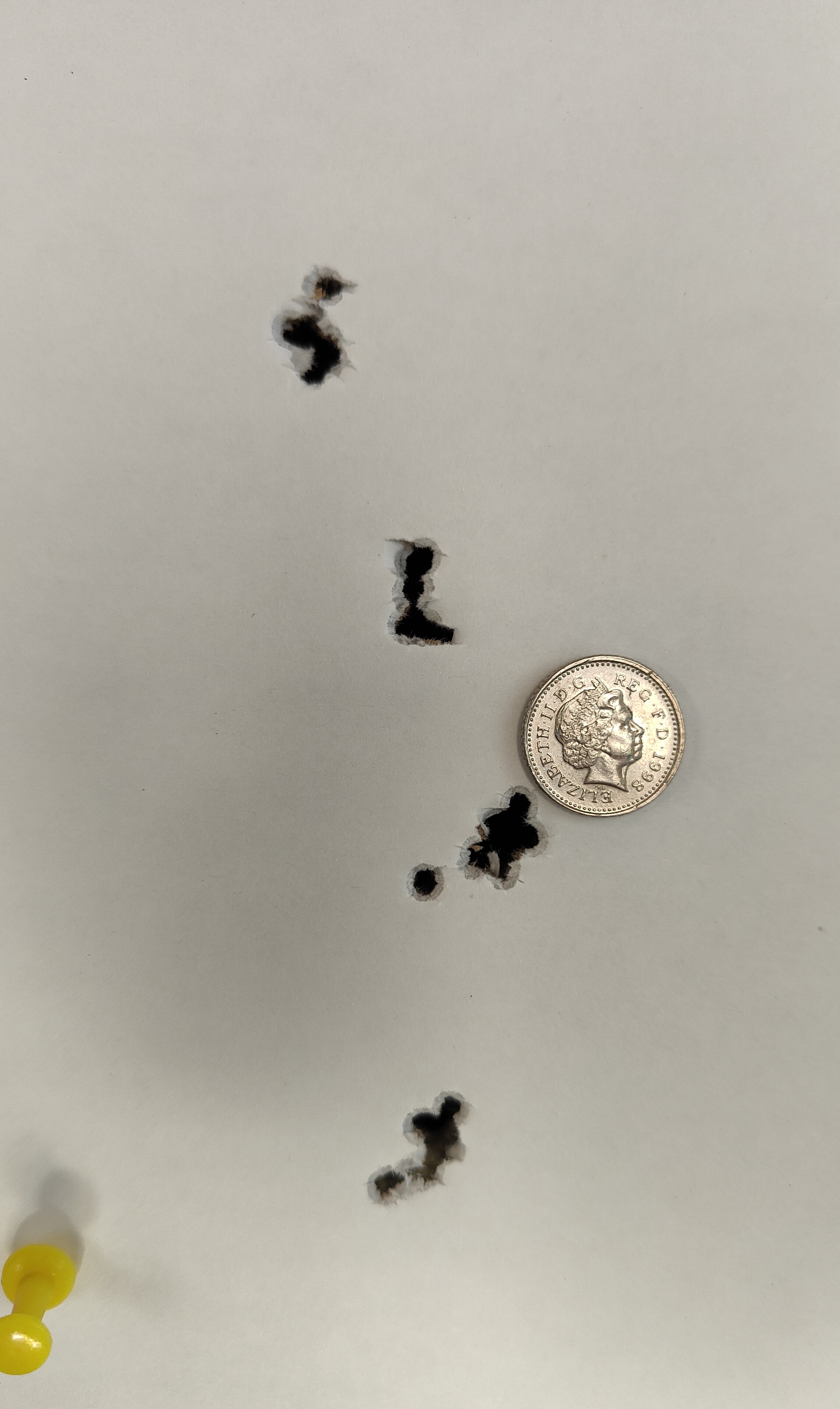

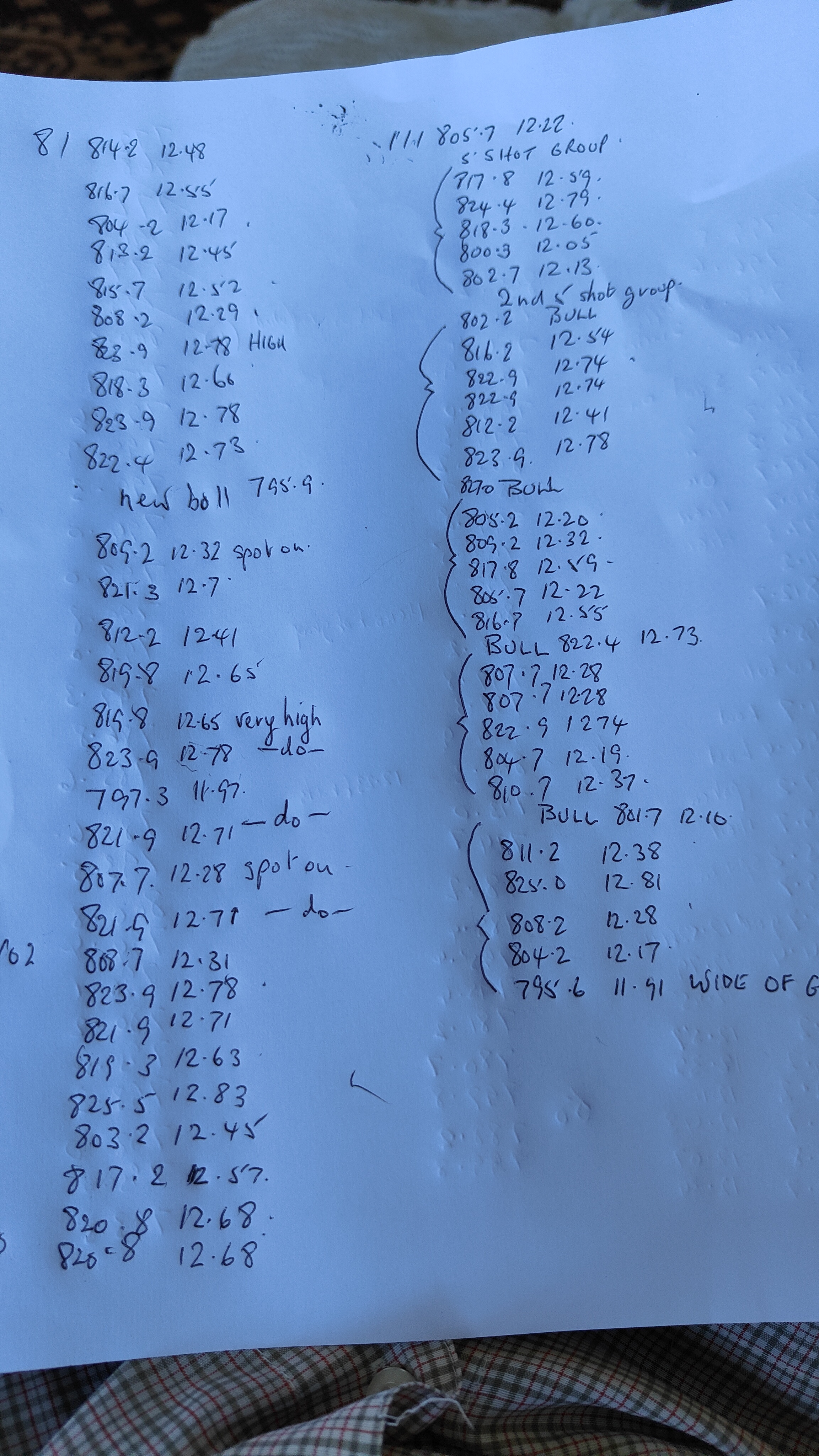

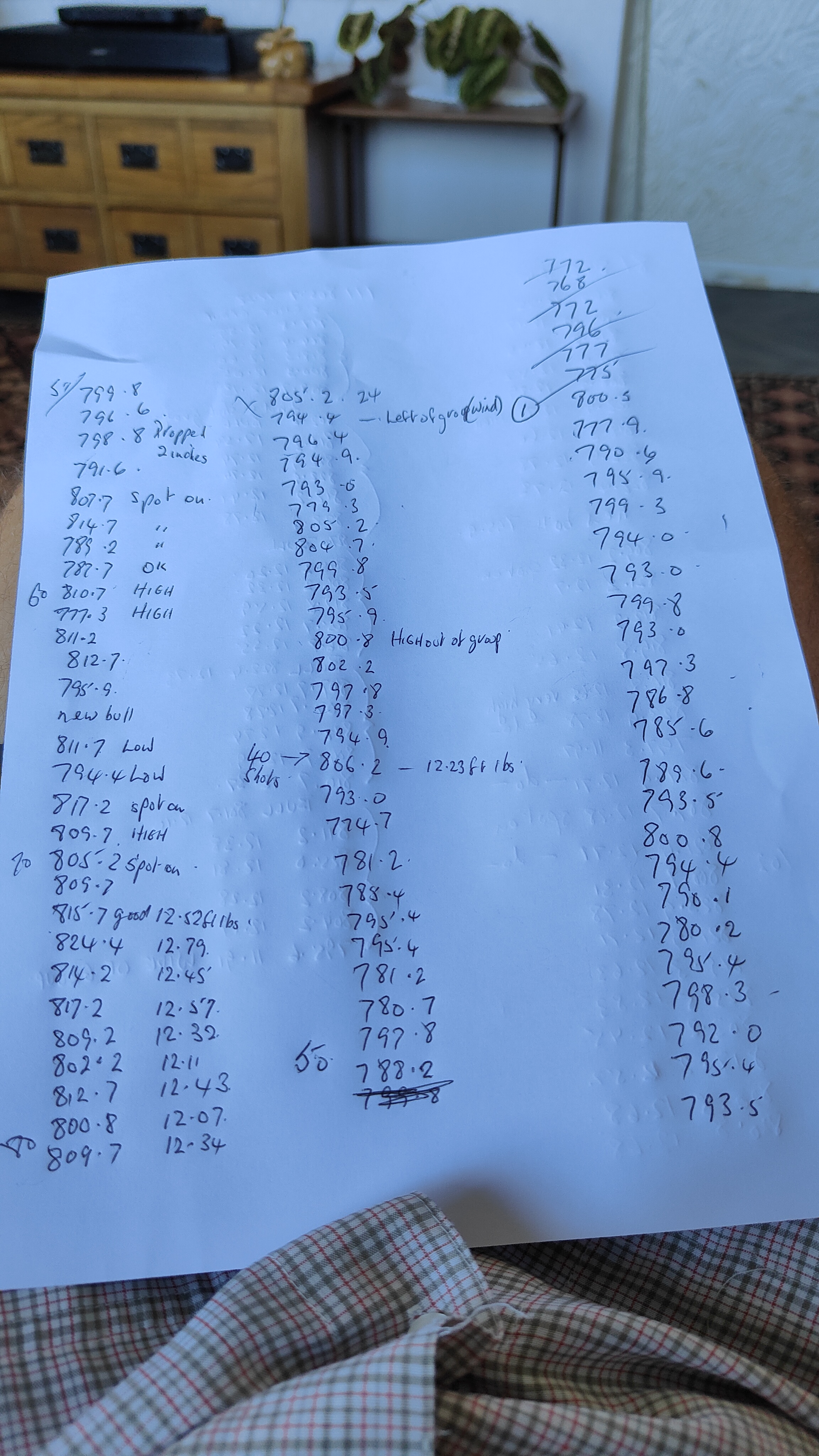

Hi Paul I spent a very interesting day yesterday. I did a very big session shooting through the chrono. I hope you can make sense of it. The list of three columns is where to start. The extreme right column top is shot number one. I started just recording the speed but at shot 72 started to put the ftlbs in also. When I reached shot 111 I decided To shoot five 5 shot groups but I continued to put the info next to the shot. I also enclose the groups. The lowest speed recorded was 777.9 11.39 and the highest was 825.5 12.83 The five groups were the end of the test. Groups were shots from shot 112 to 137. I dont know it there is a clue there. I will put this on the forum. Regards Pete.

Sorry about this mess refers to my above post I couldnt face the typing again hope you can make sense of it. I sent it first to my Pal Paul (aroundlocks) Then made a mess of it trying to put it on the forum. Any help appreciated. The problem is intermitent frequent Flyers that are definitely Flyers. Pellet is QYS Domed 8.48gr. Distance of groups is 25 yards. Lowest reading was 777.9 11.39ftlbs. Highest was 12.83ftlbs Total 135 shots approx. Hopefully there is a clue there. As far as the groups go 25 yards rested in a lively little wind.

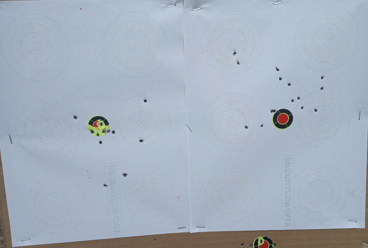

Crosmans, and today, Gamos. Sadly those were what Walmart had so not the best quality I'm sure. I tried to stick with 10.5 gr pellets since I've already tuned for them. I'd be surprised if I got 1 MOA accuracy, much less sub MOA with el cheapo ammo, but I would expect them to be able to stay inside a 8 1/2" x 11" sheet of paper at 50 yds, and none of the pellets did.
Today I repeated the same test as yesterday. Cleaned the bore, filled to 200 bar and shot in near windless conditions to 50 yds. Same type of target as yesterday. Today I used the single shot tray. I shot roughly 15 rounds at one target and another 15 at the other. Accuracy got progressively worse with each shot. My first 5 rounds were within 2" but the next 5 filled the entire sheet of paper. I tried different speeds, no change, the accuracy was abysmal. I'm 99.9% certain it's an issue with the barrel (probably the crown) but I'd rather not risk voiding the warranty on a rifle I've only had a few days.
I'm calling PA tomorrow.

Hi stretch
Fair play for trying again
You should not have to mess about with a new gun .
And if you are not happy your well within your rights to return it.
The British guns have anti tamper so you cannot even remove barrel without voiding warranty.
I personally would try an exchange gun if you can and give it another go.
It's a shame bud and good on you for persevering.
Let us know how you get on

@Telephonepete
That string looks pretty good. The groups are not terrible either but I would want better too.

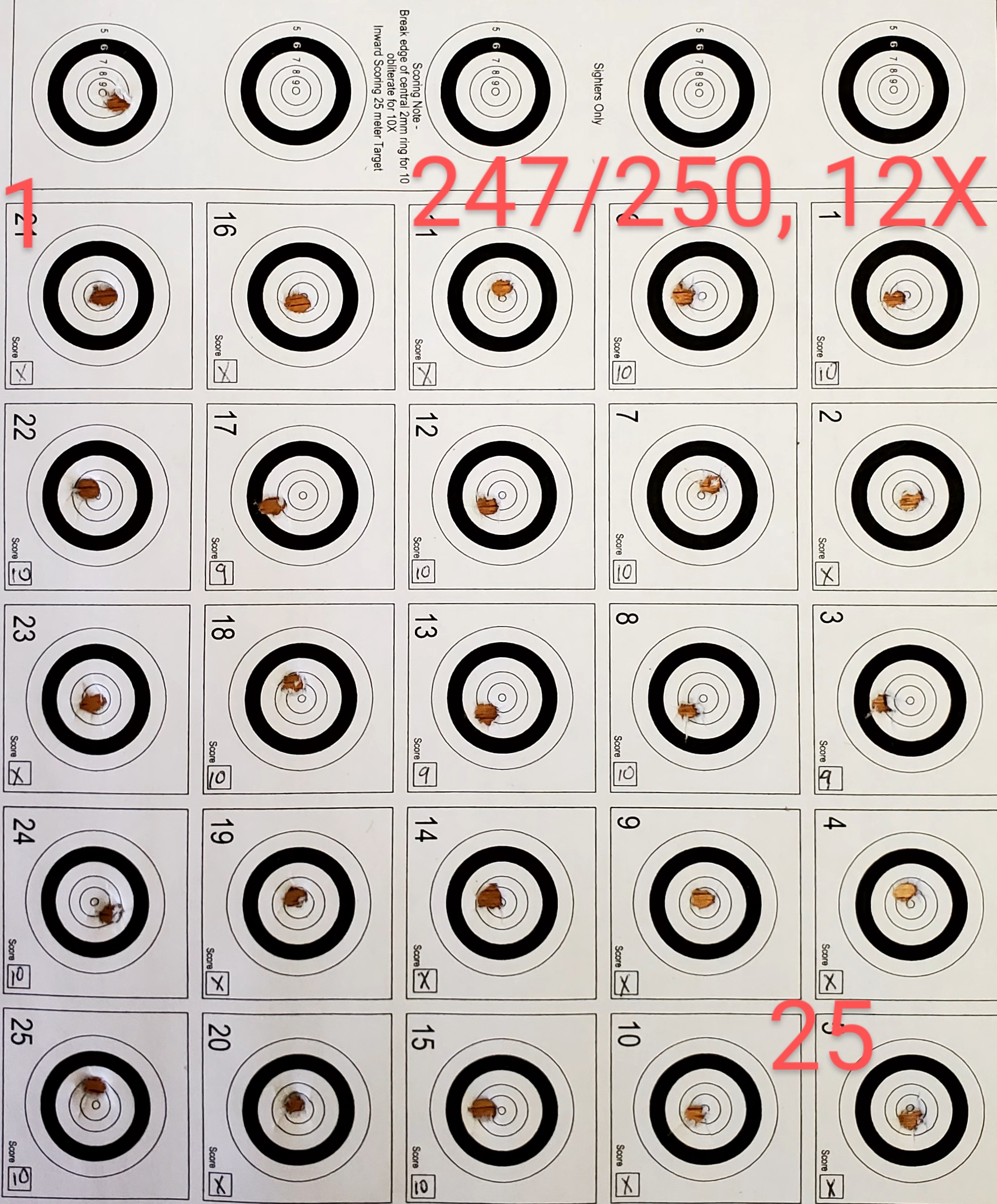

There's a lot of things to try out, but to help narrow it down if you haven't done so, I like to shoot at competition cards with a single shot per bull. That way I can see any patterns clearly throughout the fill. For me, that helped to reveal that some ammo was not as consistent as I thought. This also helped to figure the optimal start and end fill pressure for accuracy.
I only have .22 Krals but they strongly favor JSBs. Also, my Krals are most consistent from 2500/2600 psi down to 1800 psi or so.
In both of my Krals, I changed out the hammer spring to shorter and stiffer springs to give free flight to the hammer. This did help to eliminate fliers and improve the guns overall. I also polished the barrels in both of them. This also helped with accuracy and to decrease how often the barrels fouled.
From the factory, my NP03 needed the polishing more, it was very accurate for about 20 shots then the bore would get very dirty and require 7-8 pull through patches to clean. It now can do about 100-200 shots and needs 1-2 patches to clean.

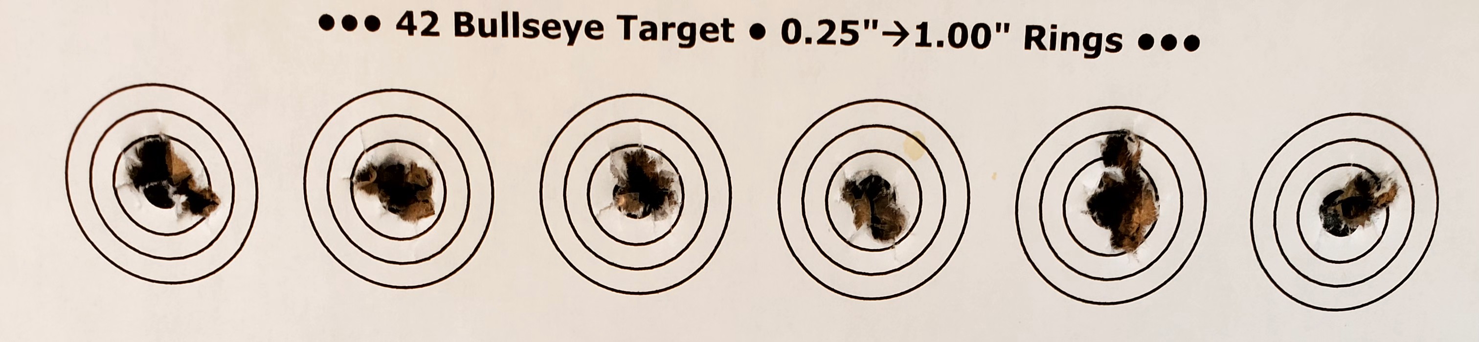

My Puncher Mega is more accurate, unsuprisingly. Below demonstrates the progression as I improved it. First pic shows 25 yard 5 shot groups with JSBs from my Puncher after changing the hammer spring. The second pic is testing different ammo after bore polishing at the same distance. The last is a 25 yard card after changing the hammer spring again and I realizing that JSB heavies worked better than 15.89s. My Mega may do slightly better now as I have a better bipod and worked on the trigger.

@Telephonepete
There's a lot of things to try but to help narrow it down if you haven't done so.
Good luck with the NP02!
Thanks very much for your reply. I am fairly competent with Springers but hopeless with PCP's. To be honest I think if I try to remove the antitamper I will really balls it up. I am close to changing the barrel. By that I mean getting my Nephew to change the barrel. The groups when I got the gun were terrible. Not worthy of the term Group. Now they are much better. I dont understand why the Chokes are made so tight. I have polished the Choke a lot and now it is nowhere near as tight as when I started. I could hardly pull a cleaning Patch through it. Even now it is much tighter that any other gun that I own. The Kral barrel is not expensive and it would be one important thing removed from the equation.
I've seen shotguns pattern better, damn.
You might have a bad barrel, but it makes no sense for it to shoot good, then go to hell like that.
