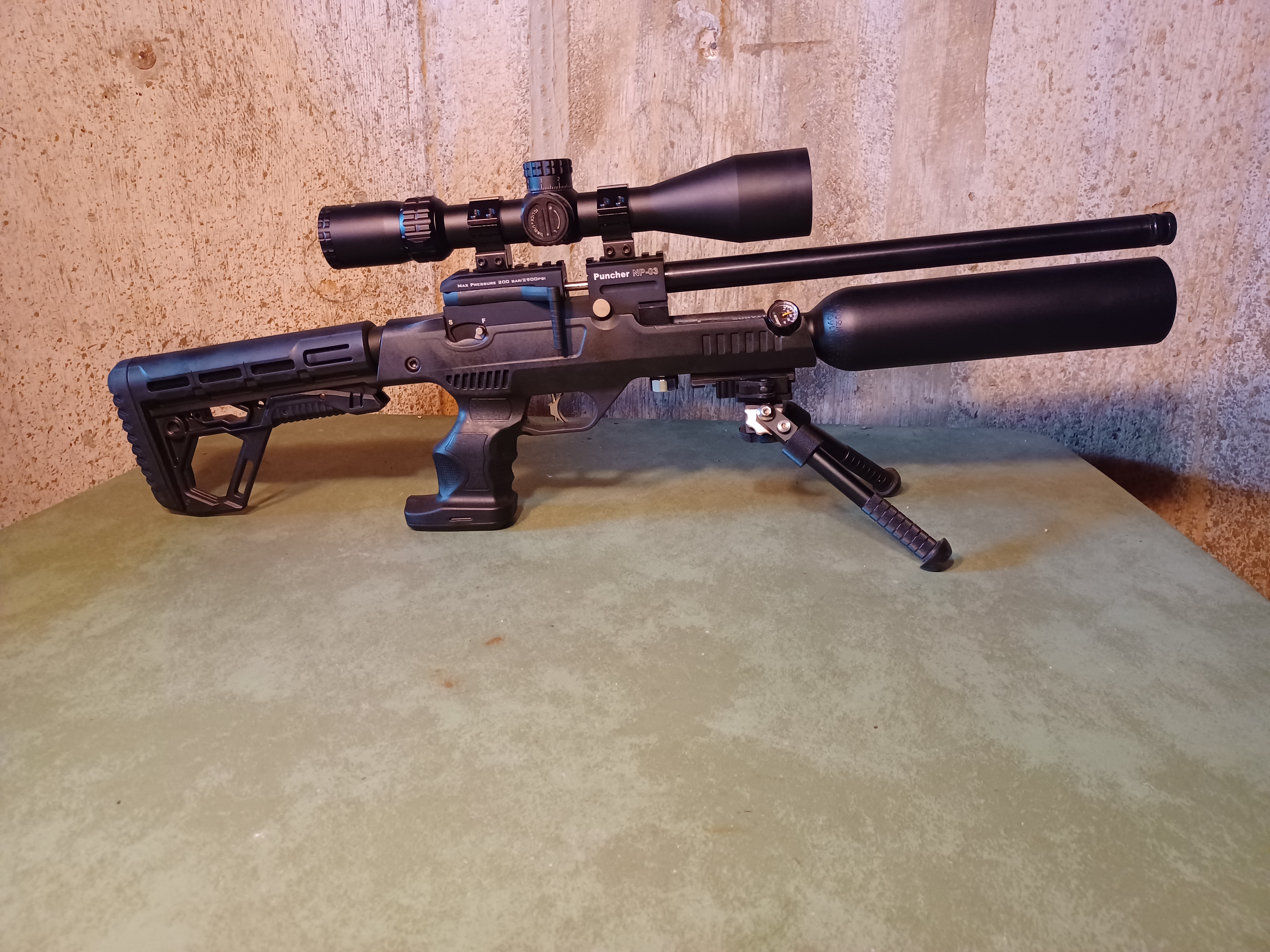

Did some chrony testing with my Kral Bighorn with the new barrel.
I hit a high of 1049 fps or 108 FPE using my cast 44.5 grain MPMolds HP bullets.
Next I will give it a barrel polish and test accuracy.
Really pleased with this beasts.

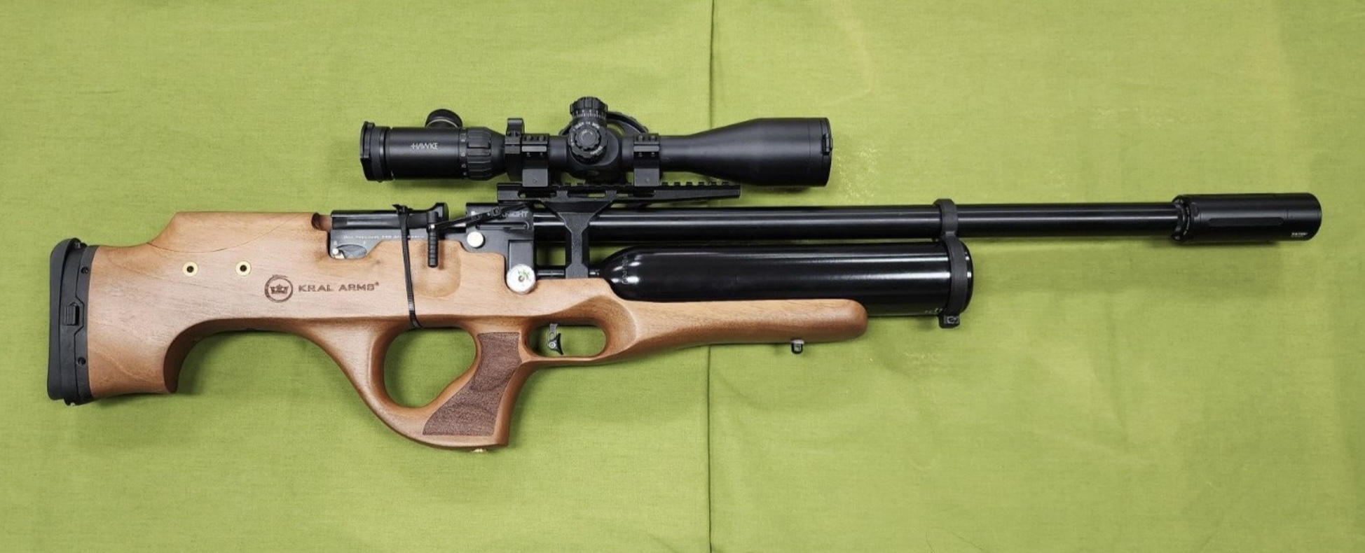

That's a lovely looking gun
Beautiful stock lines.
Kral are a very underestimated gun but with some TLC they start to sing.
Let us know how you get on with the accuracy testing
With that fpe and projectile I feel sorry for the target lol😁👍

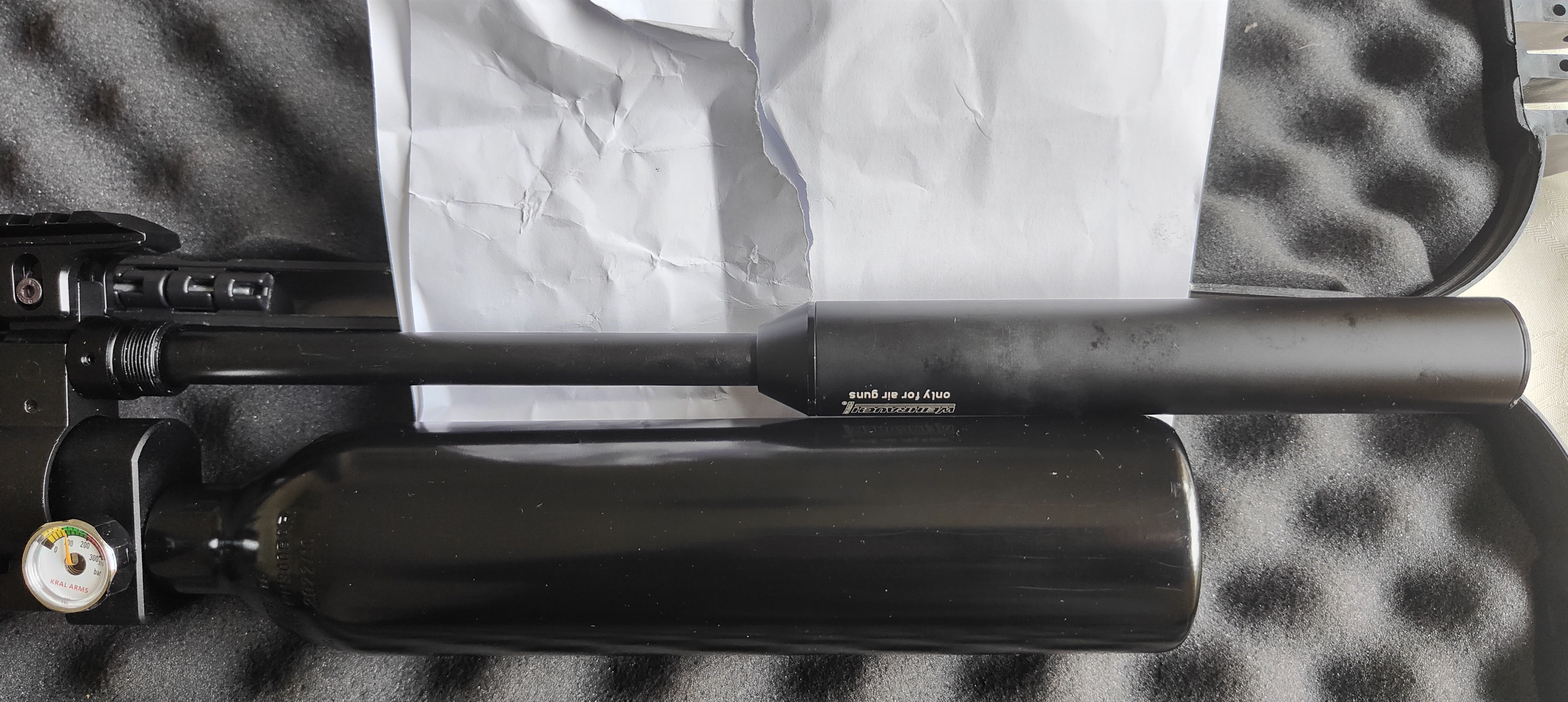

View attachment 357905This is how my np03 bottle gun turned out. Was a 25 cal with the np02 barrel. 350cc 4500 psi bottle and altaros regulator. Sold it to a forum member last year, but it was a nice little blaster. 38 fpe for 60 shots.

Np03 with a barrel from an np02. Had an np03 shroud, with 3 Mrod baffles and an air stripper to take up the length in the shroud and quiet it down some. Altaros regulator and a 4500 psi 350cc bottle off eBay. Biathlon lever off a jumbo, and some heavy hammer spring. Pretty easy build, just cut the stock to fit for the bottle.
