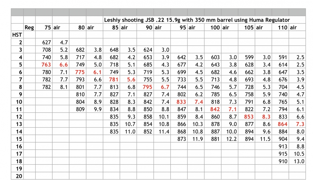

Here are some data I put together last weekend tuning my Leshiy. I wanted to have a reference on a sweet spot for for each regulator pressure setting. The number in red is 5% below the plateau velocity or knee velocity. The shots are recorded with velocity and air consumption per shot. Enjoy!

This is frickin' sweet Jack! If I'm reading it correctly the red numbers under the regulator pressure are the point at which the regulator is controlling the power 5% more than the hammer is controlling the power?
Under the air columns is that how much air is consumed for each shot?

Michael, what I did was fire a few shoot for each HST setting under each Reg setting and record the average FPS until the Leshiy plateau for each Reg and HST. The Red number is about 5% below the plateau velocity. the number next to each FPS is what was recorded on the EDMU on how much air was consumed for each shot. I went through lets of pellets and air but also learn a lot. Its a good reference.
Looking at my chart and what you were getting on the JSB Hades were very close to my 85 bar reg setting 775 FPS vs 781 FPS.

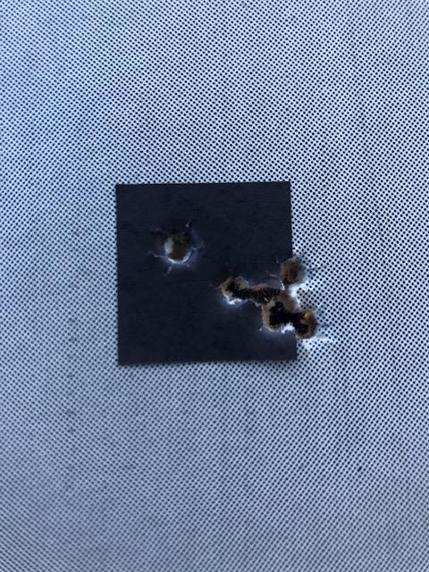

You guys are waaaaay to advance for me 😁 I was just happy with this 50 yard group before the winds came up. 6 pellets in the grouping and of course I always throw one....The square is 1 inch and the tune was 750 FPS with the 25 cal 250mm barrel, UTG bug 3X9 scope off a bi pod. Just ordered a new scope from edgun the Tac Vector Veyron 3-12x44FFP to replace the Bug.......

That's what is great about this Leshiy... perfect little truck gun to run over, pull out a shoot, or one to take apart and tinker if you're so inclined. That's 6 dead squirrels and 1 that may require a follow-up... but good enough for me. nice shooting
