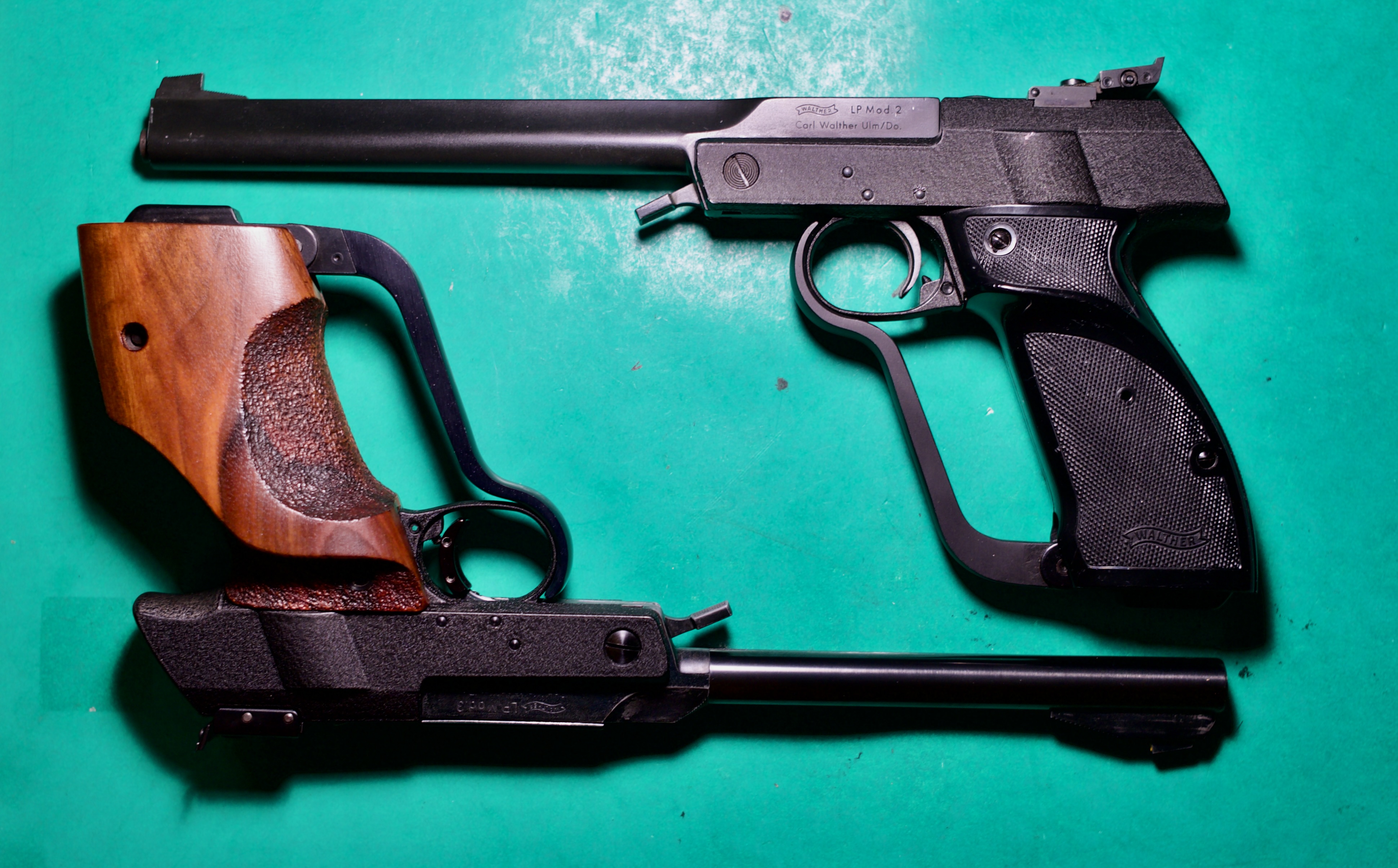

LP 53 is a springer... the LP 2 and LP3 are ssp's. Very well made but weird valves.
Walther carried on the tradition of weird valves to the LPM. I replaced mine with a standard poppet style and velocity jumped more than 50 fps.

Yup, cute to look at, very well made and accurate, but not nearly as user friendly as the same-timeframe spring piston FWB 65. I'd challenge anyone to cock these more than a few times, even if it doesn't bite your finger as they typically do!
Here are a few.

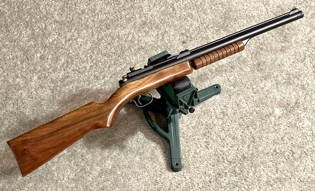

Old No. 1, LOL - my very first "real" airgun - and classic MSP - the "tootsie roll" early Benjamin 347 that Santa brought in 1968. I'm pretty much a springer guy these days...but if you can't love an accurate, slender, 5-pound, variable-power, recoilless rifle capable of 700+ FPS, you might have an issue, no? 😄
I shot the bejeezus out this little fellow as a teenager, then rediscovered its elegant efficient design in the mid-1980's. I re-did the wood myself, and had the action rebuilt and re-finished at the Benjamin St. Louis factory - not too many years before Crosman bought them out. So it sorta represents two eras of Benjamins - and still works just fine.
