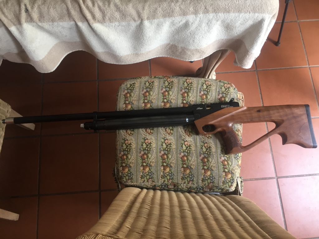

I have modified my 30 cal Jkhan from being a pellet shooter (100 fpe) to being a slug slinger (150fpe).

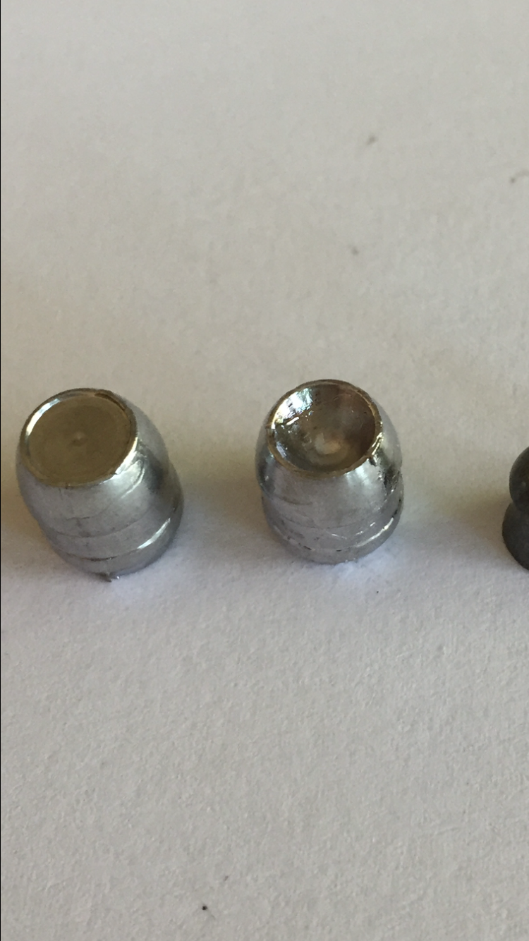

My NOE 300-68 FN mould allows one to cast HP, FN and CN(cone nose).
I plan to shoot an Impale Ram (size of deer doe) in the near future. The farmer has said if I want to take a double lung shot, the slug must exit.
Question, will a 70 gr FN @ 980 fps exit on this size animal been shot at 35 m and assuming largest bone will be a rib.
Is there a true representative test one could undertake while being in lockdown, to determine if one has enough gun?
