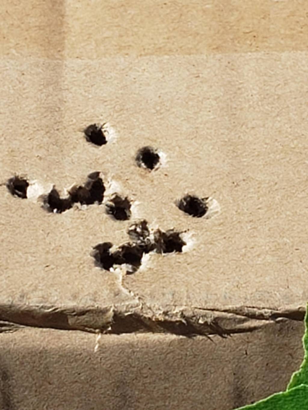

As an experiment I shot this at 100Y with my Thomas HPX. It was all of the worst pellets in the tin. .003" head size difference, .5 gr weight difference, and funky skirts, a hair over an inch tall and the rest was from wind.
The overall group size wasn't any different than the best pellets in the tin on my 100Y EBR target which scored 239.
I think if you have a good gun and good pellets the biggest detriment to accuracy are mistaken wind calls, as well as not understanding how high or low to aim when the flags change. Not that each pellet is exactly the same as the next, in other words actuality swallows up any slight differences.
