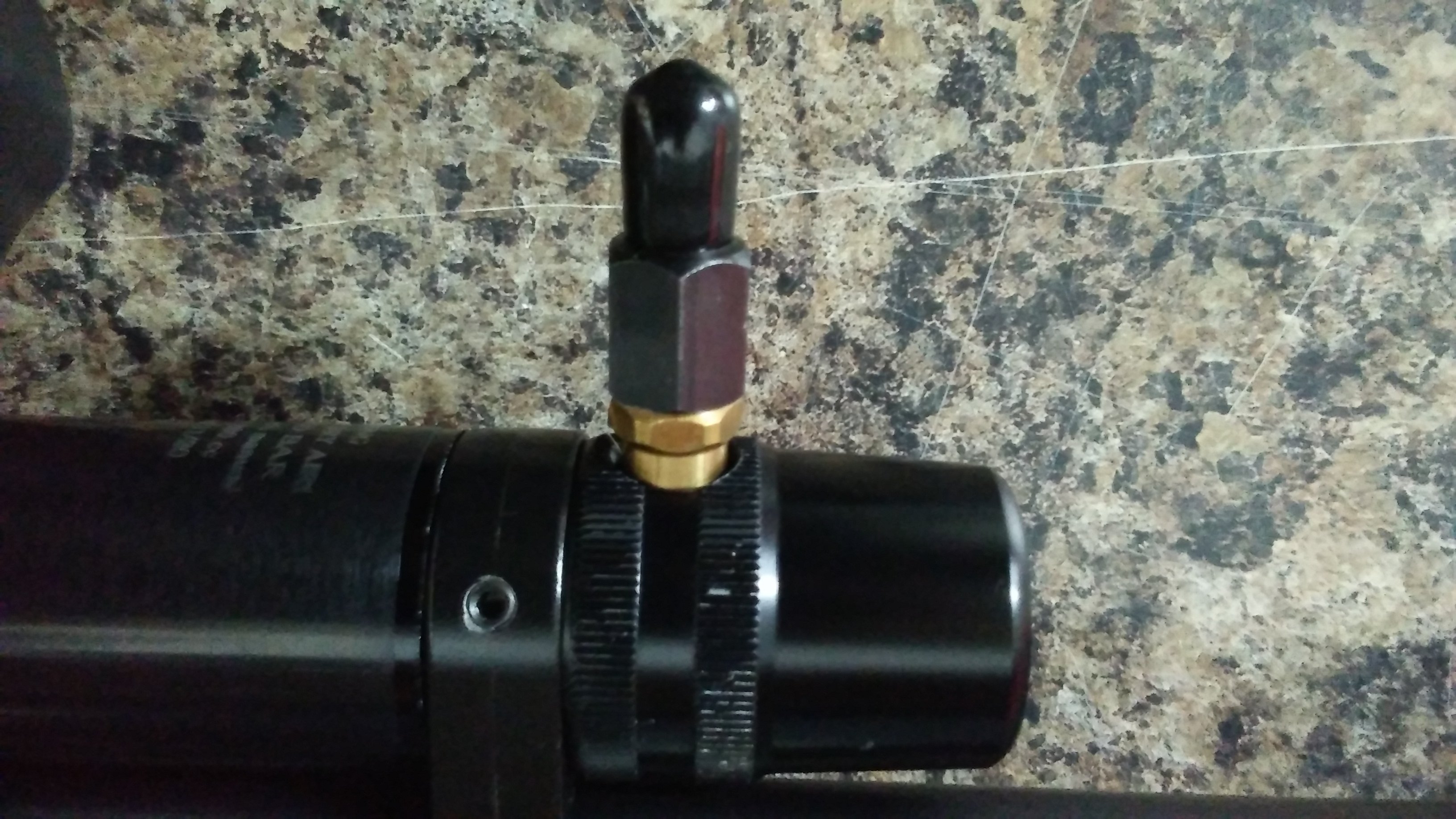

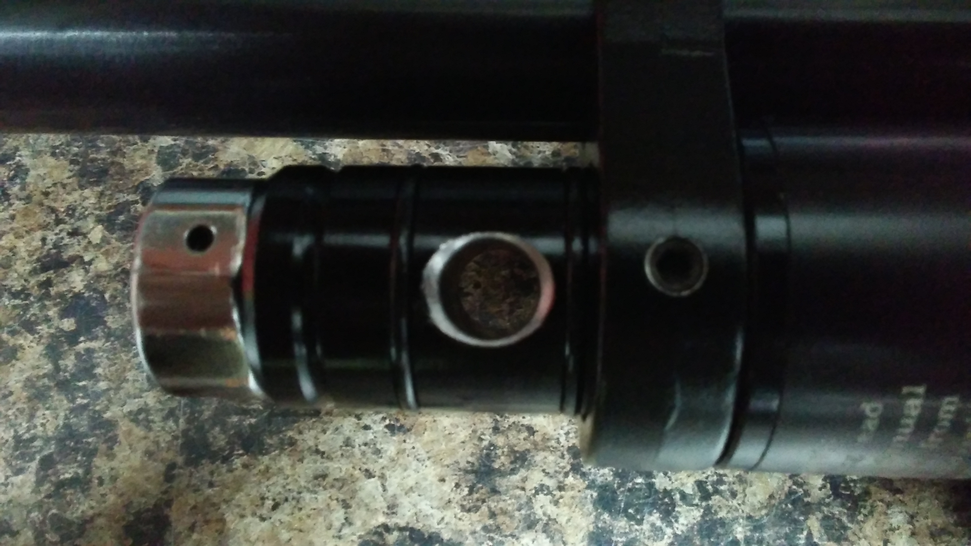

Pull the dust cover off and use a fine grinding stone to round the edges off. You can also just leave the the probe in with a dust cap on the probe -will show you a picture later.

Keep a light coat of silicone grease on them and make sure your fill hose has no pressure left when you pull the probe out. That plus smoothing out the fill port will keep them going.
