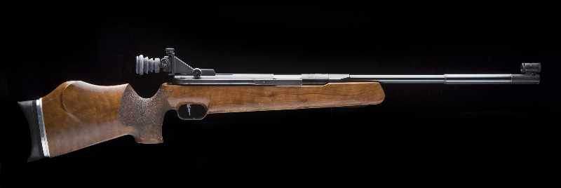

I few months ago I bought an FWB 300 with a Tyrolean stock. I compete in silhouette and this gun is what I use in Target Class. While I have a couple of high power PCP guns, I have come to really love the engineering of this gun and the incredible accuracy.
The problem is the finish is thin and the rifle is prone to quickly develop rust. There are some small pits on top of the cocking arm. My question is... Should I consider having the gun reblued? Will that hurt the value of such a collectable gun? and What about refinishing the stock?
This gun shoots 3/8 inch groups at 36 yards. I plan on keeping it, but I don't want to ruin a collectable either.... Does anyone know if the factory will work on their vintage rifles?

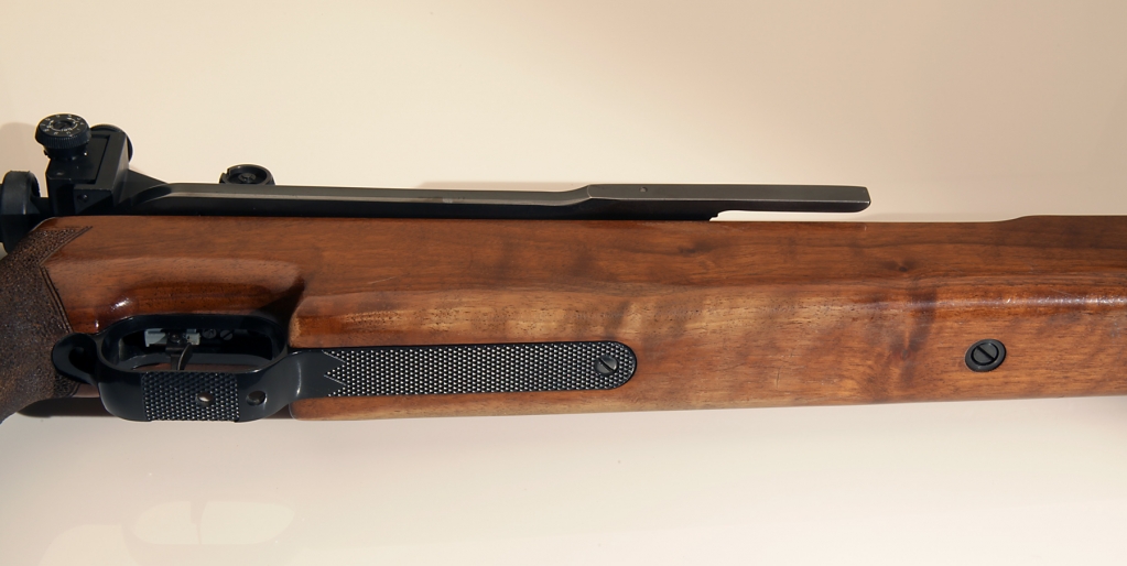

I use Glenrock Blue from Wyoming for rebluing. I've done several restorations on high end guns and it hasn't affected the value. Glenrock does an unbelievable job. However, disassembly is req
uired by you.
In so far as the stock, ask around and see who does refinishing. It isn't too bad if they don't disturb the checkering. If you end up having to do it, it can become costly fast!

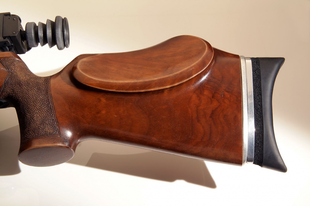

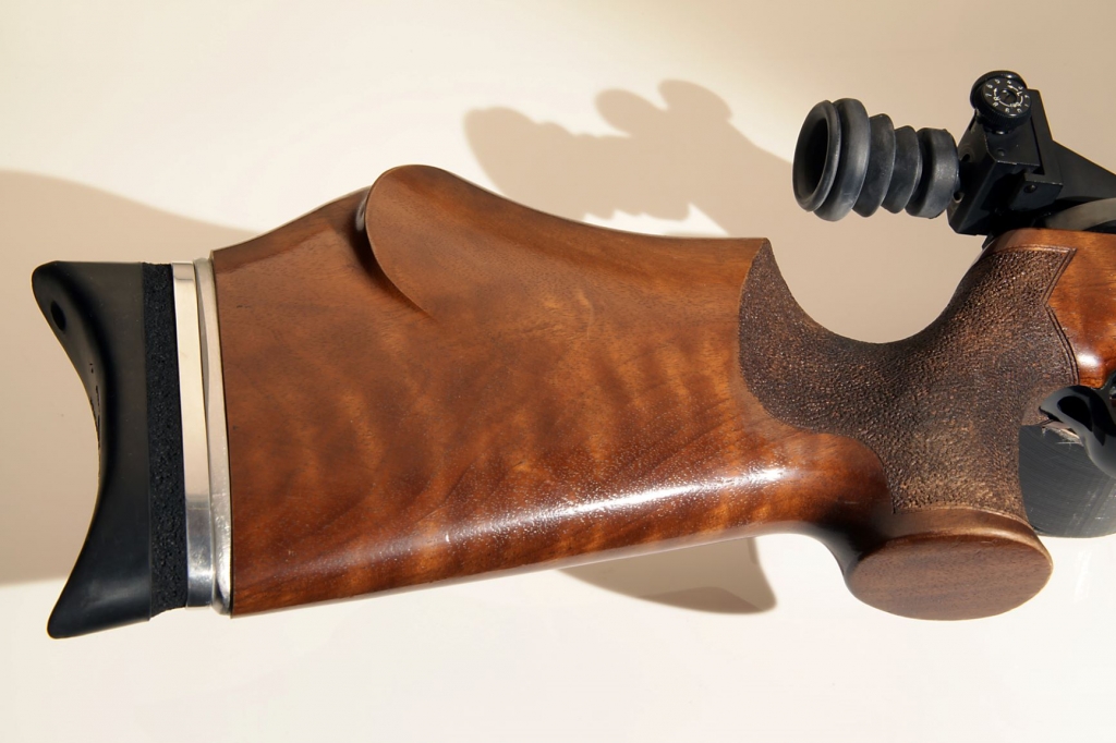

Here is a pic of a couple I ad completely redone. All new internals too. Scott Blair from Airguntunes.com did all the work other than bluing.
I have never changed the bluing on a classic air rifle, Springer or otherwise. I have refinished many of the stocks.
The factory blueing on most of them is excellent. If they have some patina, and metal is showing, it just means they’ve been used. That said, the two rifles in the post above look excellent. And I’m sure reblueing enhanced their value.
You mentioned the rust was on the cocking handle. Pretty easy to replace.
After I remove surface rust, I use car wax to keep them rust free. It seems to bring the luster back out in the bluing.

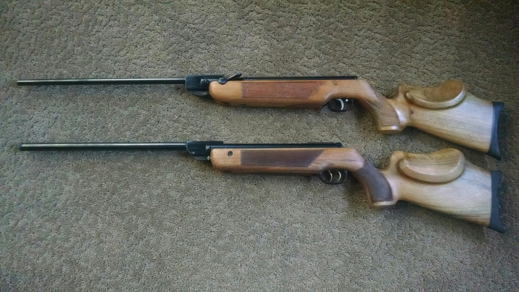

Here is a 300 and a 300S with refinished stocks, And polished up actions.

Thanks for the advice all. I think, when I consider the cost, I could almost buy a pristine 300...… I will probably go the ballistol route and shoot it. It already gets noticed and it is never gonna be a "safe queen". I use it to knock down lil metal animals. I would have to get another 10m gun to continue to compete..
I was warned this would be addictive...

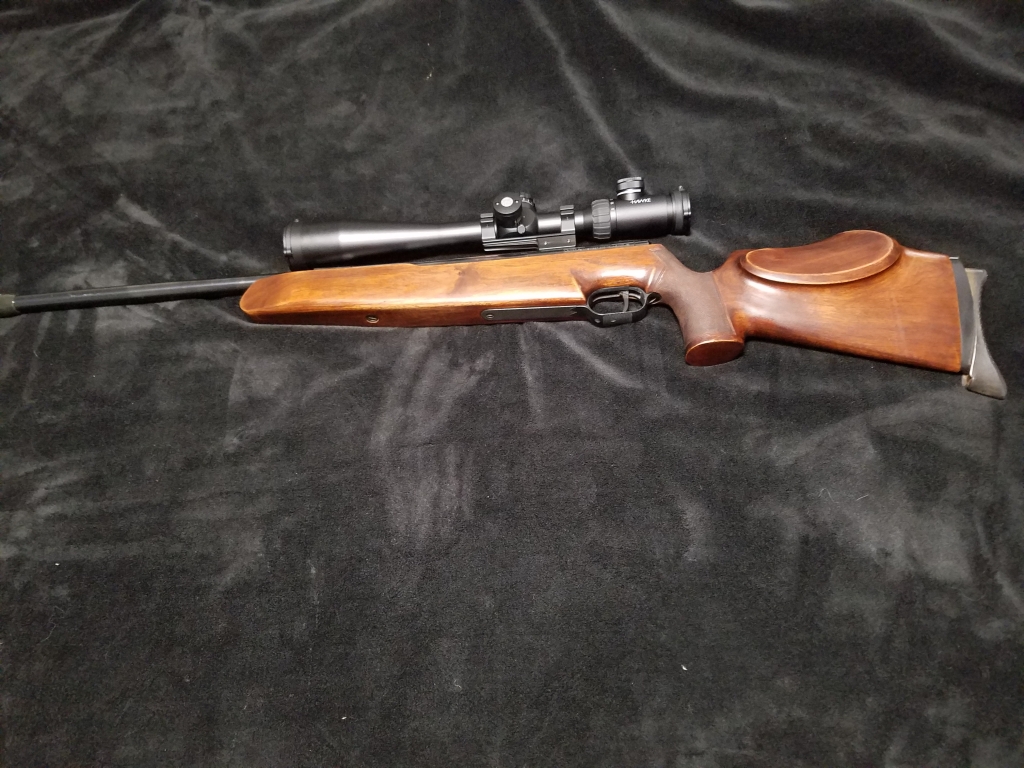

So here's a picture of one of my infections, the rifle in question. I made a fake moderator from one that came on my RAW. It just slips on to cover where I took the diopter off. I drilled it out to about .30 cal to avoid any interference with the crown or any clipping. The trigger measures 2 oz.
So I'll just get it it's own bottle of Ballistol and wipe it down every time.
