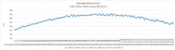

So here is a shot group from my standard Wolverine 2 .22. It should say 230 bar not 320 bar. So when I give it 230 bar you can see the beginning curve. I never go that high due to drop in fps. My sweet spot is 180-205 bar.

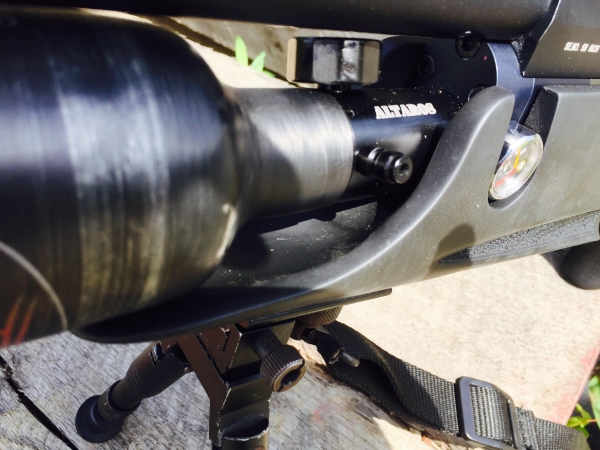

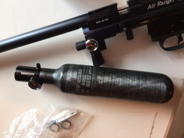

Can i put a regulator on this gun? will I loose speed? I would just like my first and 20th shoot to be the same with a 240 bar fill. I can only achieve that with a 220 bar fill and get 15 shoots with 34gr beast pellets.
I have only seen one on a wolverine 2 bottle gun, it was not a HP 60ke gun, and he took it off of I followed the post correctly.
"whitetail17"Can i put a regulator on this gun? will I loose speed? I would just like my first and 20th shoot to be the same with a 240 bar fill. I can only achieve that with a 220 bar fill and get 15 shoots with 34gr beast pellets.
I know the Huma is for tube Daystates, not bottle guns. I believe I saw a regulator at some point that went between the bottle and the block.
You may already know all this. The slingshot hammer on the Daystates are very efficient with air as you can see from the large shot count I posted above. The problem with a non-regulated gun is you get that curve. The low fps when fully charged is because of the back pressure on the the hammer/transfer valve. Until it drops a bit the fps will be diminished. Daystate claims they don't need a regulator because of the high shot count. They are also an English company that has a 12 foot pound and under law. You don't need to fill to max when you get a million shots per charge. This is why I have been hesitant other than the electronic Daystates to go above .22. Also another option, if you bench shoot a lot is to tether at a specific pressure and have a flat shot group.
