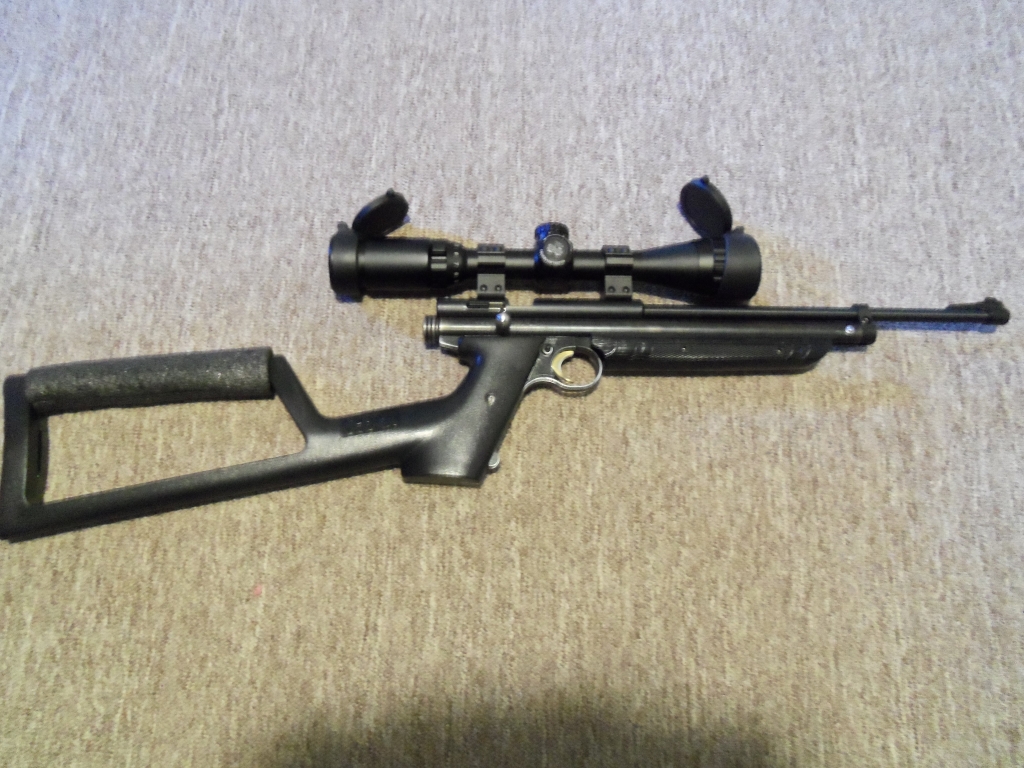

I have this rear cocker that I put a 14.5" .22 barrel on, a Baker Aluminum breech, and I gave it some more space in the valve.(shorter poppet,longer spring)
Also replaced the pivot pin, with something a little nicer. Now it's wearing the carbine stock, and a Barska 3-9
No problem punching bean cans with some FTT"s at about 35 good paces,putting them through..
A good day!
A good day!
