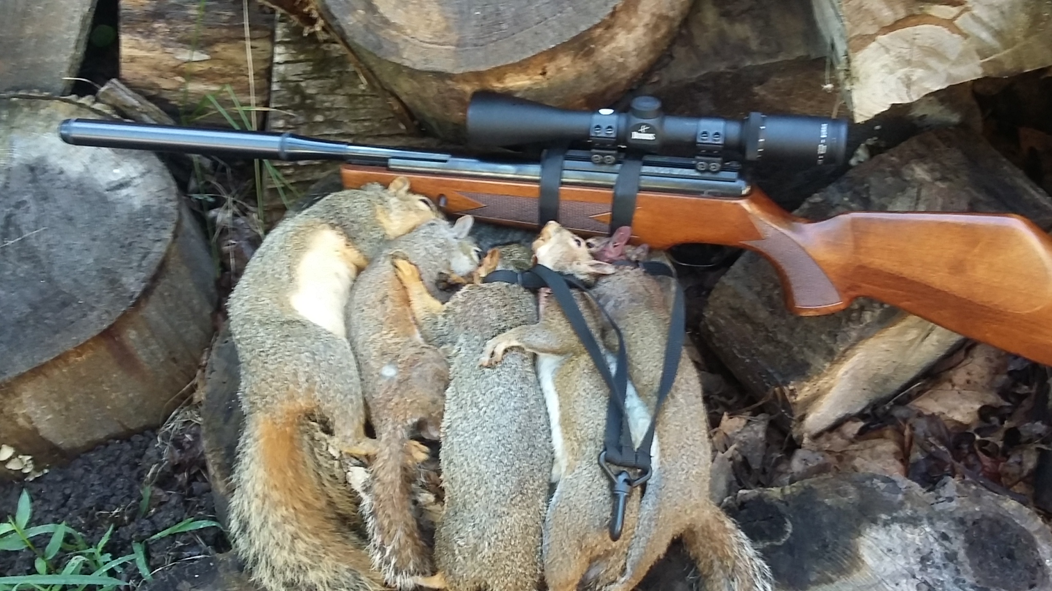

My hands down favorite springer is an R9 with a chopped and choked barrel in 177 by Steve around 14" long. It seemed better balanced to me and I didn't see much change in velocity but accuracy did improve. Most of my use with that gun is hunting ground squirrels shooting offhand or sitting. One of the few times I've shot off a bench at 50yard on the BLM land with a slight breeze using JSB 8.4 gave me a 6 shot group of 1 3/8" but taking shot # 4 out resulted in 7/8" back in 2019.

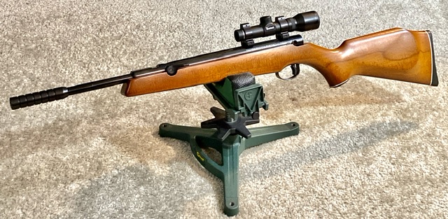

I bought a 22cal R9 barrel chopped and choked to 8" second hand (can't say who did it but understand two parties were involved). It took all my strength to simply cock that thing and I ended up putting a shroud on it to make cocking possible. Velocity was around 80fps less than a standard carbine barrel but it's accurate.
