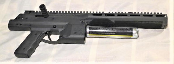

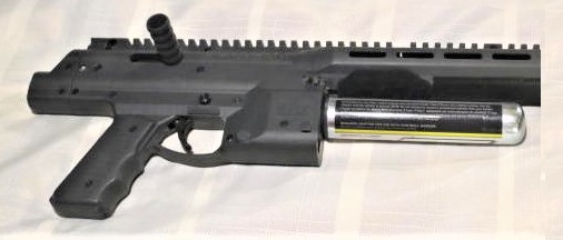

After converting a Umarex Air Javelin arrow carbine to use either 13ci HPA tanks or 88 gram CO2 cartridges, I decided to remove the butt stock and cut down the barrel by a few inches to make it onto a large arrow pistol. The carbine is 32 to 35 inches long and has a 12 ½ inch barrel. A shortened pistol version which can use either a longer 13ci HPA tank or the shorter CO2 cartridge is only 19 inches long overall with a 10 inch barrel. And a shortened pistol version which only uses the 88 gram CO2 cartridges can be cut down to only 16 inches long overall with a 7 inch barrel. In each conversion, the barrel shroud ends up about ¼ inch beyond the front edge of the HPA tank or the CO2 cartridge.

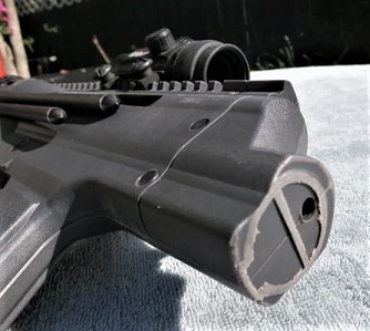

Step 1: I began by cutting off the rear of the butt stock just, about ½ inch behind the point where the narrowest section of the stock connects to the rear of the gun. There is an internal partition inside the stock at that point. The picture below shows how it looks after the hollow stock has been cut away and the outer edges filed down to expose an internal partition. The small hole in it is for the hammer spring preload adjuster.
There are good videos on Youtube showing a disassembled Javelin and where the adjuster is located within the stock. If you cut off the stock any closer to the action the hammer spring will fall out. Safer to cut about 1/2 inch back from that internal partition so you can see what you are doing, and then used a fine tooth saw and file or sander to finish up.

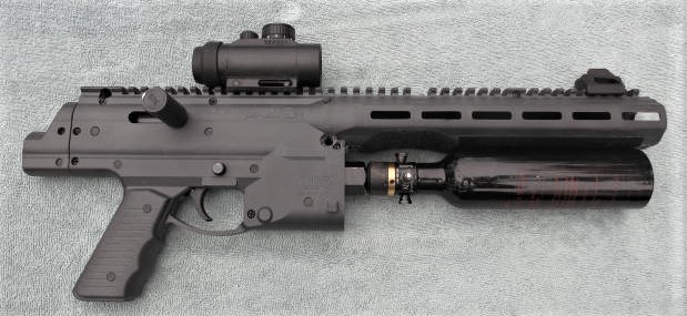

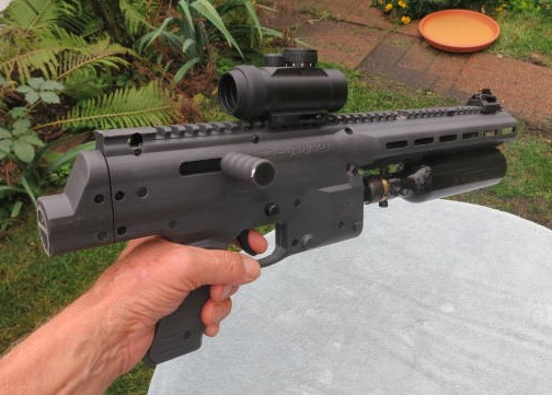

If you convert your Javelin to use a 13ci HPA tank, you will end up with a 19 inch pistol with a 10 inch barrel. This CO2 to HPA mod is described in an earlier post from a few days ago on this same forum;
And you could still use CO2 in the same gun with a 10 inch barrel;

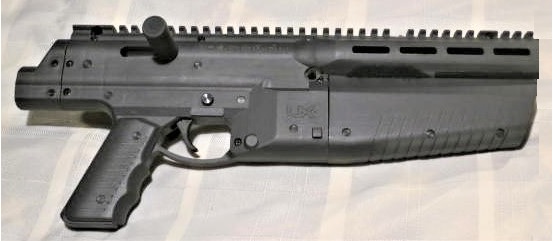

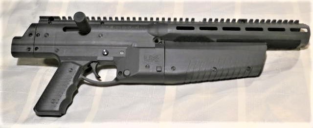

And if you only plan to use the 88 gram CO2 cartridges and want the shortest possible, the Javelin could be cut down to a 16 inch pistol with a 7 inch barrel.

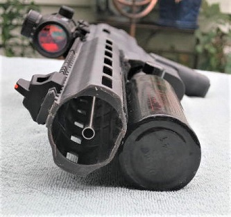

Cutting the shroud and barrel isn't very difficult if you use a cut-off blade in a rotary saw and follow up with a hand file and sander. After wrapping the shroud in masking tape to prevent scratches and to indicate the edge of the cut around the shroud, use a thin carbide cut-off blade in a rotary saw to cut the shroud but not the air tube within. Then pack foam or something similar firmly around the metal air tube within the shroud to secure it from moving around before carefully cutting it, a 5 second job. Finish up with a hand file to be sure that there are no rough edges on the end of the air tube to slow an arrow. After that, use a flat or belt sander to carefully clean up the end of the shroud.

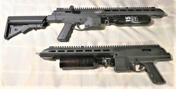

Is a pistol mod like this worth the time involved? If you have 2 Air Javelins, it's fun to have both a carbine and a pistol to compare. And it isn't a very difficult mod, just some saw and sander work. A couple more size comparison pictures to wrap it up;
An unmodified carbine next to a 22" pistol with original 12.5 inch barrel length

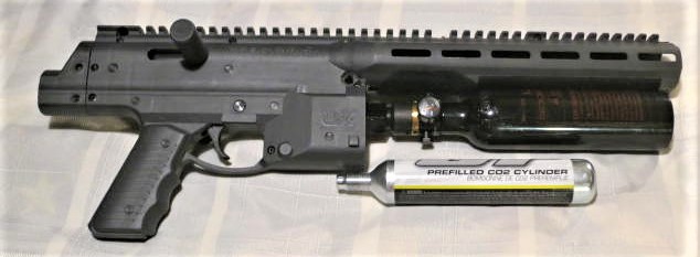

Size comparison of 13ci HPA tank and 88 gram CO2 cartridge
