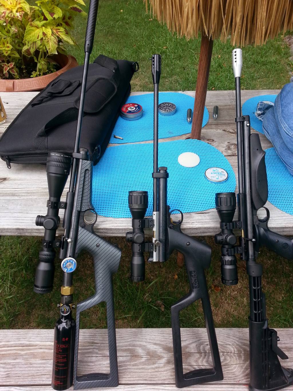

I have both of these scopes and although they are actually rifle scopes they are both on my pistols

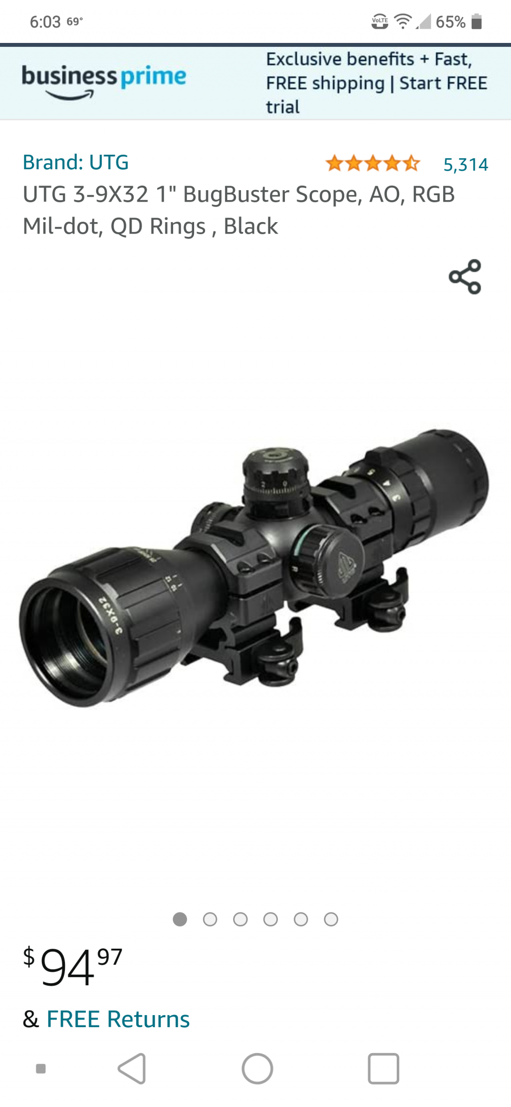

The 3x9 bug buster fit the bill.
Thank you all for your responses, they are very much appreciated. My internet connection was damaged, then I was out in a very rural area for a week and for some reason could not sign onto Airgun Nation to reply so I'd like to apologize for taking so long. Those are beautiful air guns ... thank you for posting them. I'm placing my order for a Crosman 22240XL and a 1322 today and I am looking forward to customizing them ... God Bless
