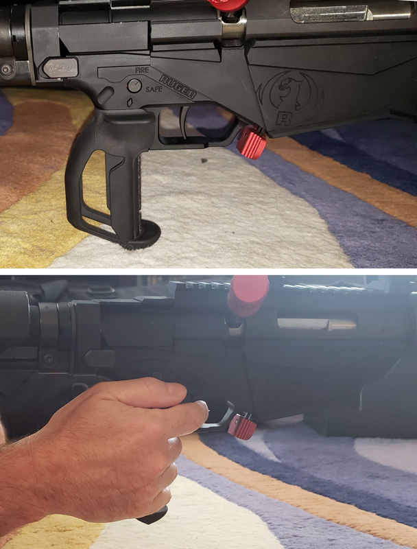

Many, myself included, do that with precision rifle shooting (centerfire). I did it today at the range with my Ruger Precision Rifle 6.5 Creedmoor.
Like this:
The advantage of it is that you're less likely to "milk" or "GI Joe Kung-Fu grip" and moving the gun when you press the trigger. Isolating the movement of your trigger finger without "sympathetically" moving the other fingers is a challenge. So, this minimizes that effect, because your thumb isn't wrapped around the grip.
Hopefully that made sense. This thumb around the same side (as seen above) is a more "relaxed" position, and less likely to move the gun during the trigger press. At least that's the theory behind it.

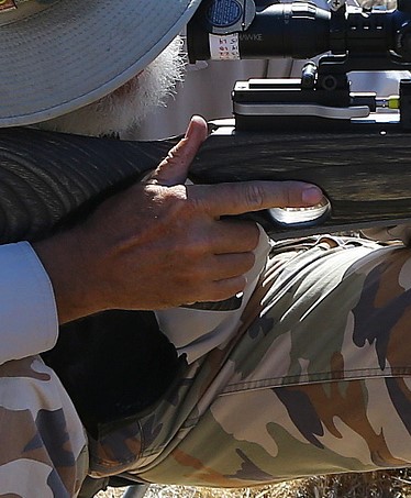

Observe nearly any competitive and successful Field target shooter you will see Thumb up nearly all the time !
Bench rest not so much as general grip is super light or resting on bags or a sled with the act of breaking trigger just a light touch.
OFFHAND shooting this type hold can really be beneficial so one can keep a light grip and not snatch trigger .... practice is key !!!!!!

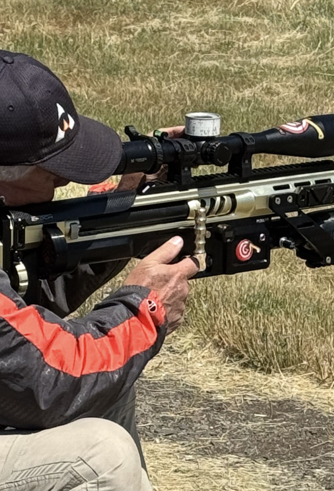

This is how I shoot EFT and Benchrest. Thumb up takes the “grip” out of play and minimizes the gun movement when pulling the trigger.
Shooting springers in benchrest competition I find it allows me to be more consistent as you do not torgue the gun with your trigger hand as much. In centerfire benchrest I shoot totally free recoil, only trigger finger touches the rifle. The more you contact the rifle the more things you WILL DO that is detrimental to accuracy. Now after all this, my wife lightly grips her D75 on the bench. And if your going to shoot her for your lunch money, you best bring a sandwich.
