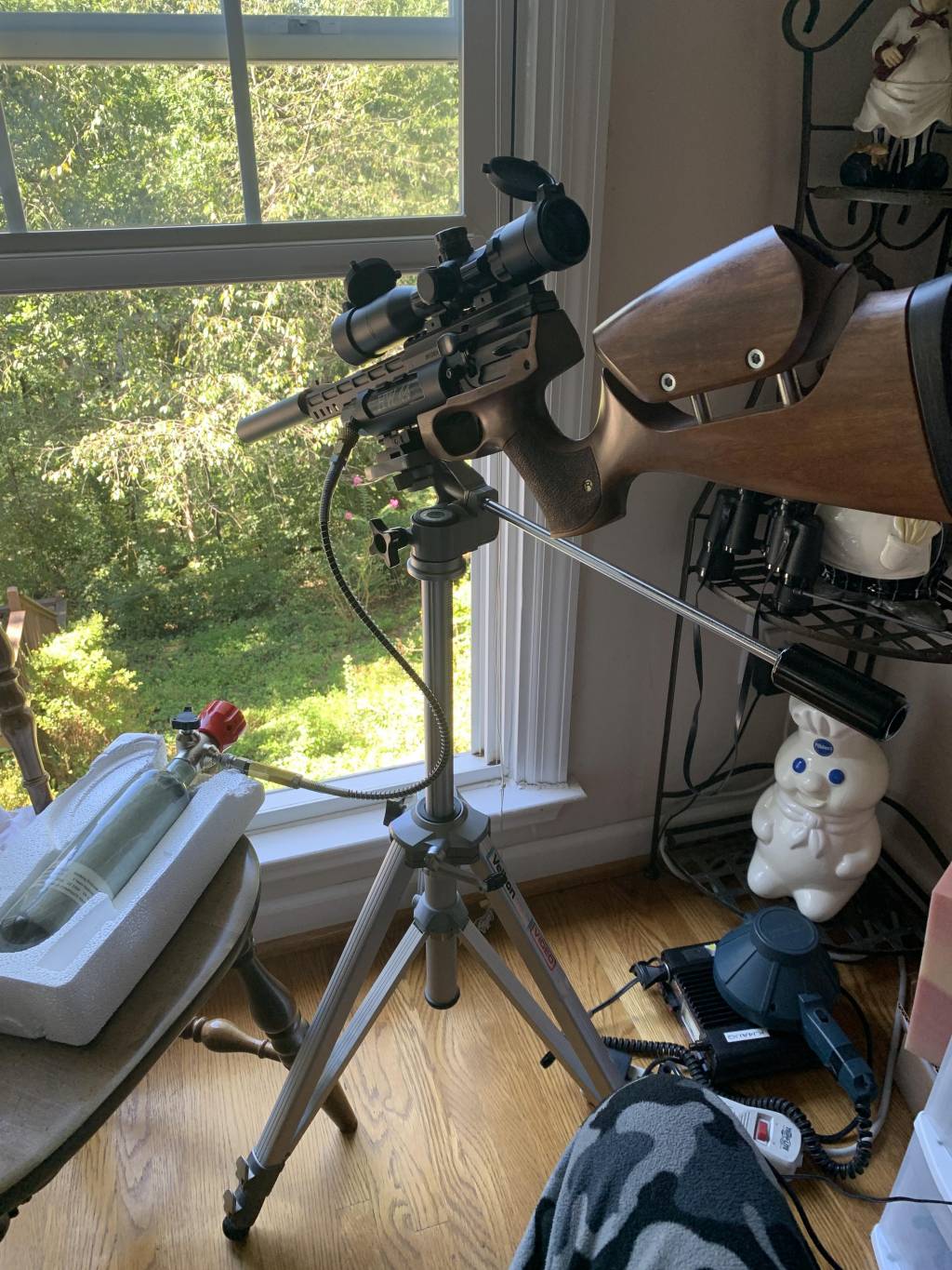

So I did this to my 2240 and loved it. It shot great this way for tens of thousands of shots.
Over a twenty year period it morphed into this. I secured the valve better and changed the tank and now run at 1400psi. Is it done yet?
