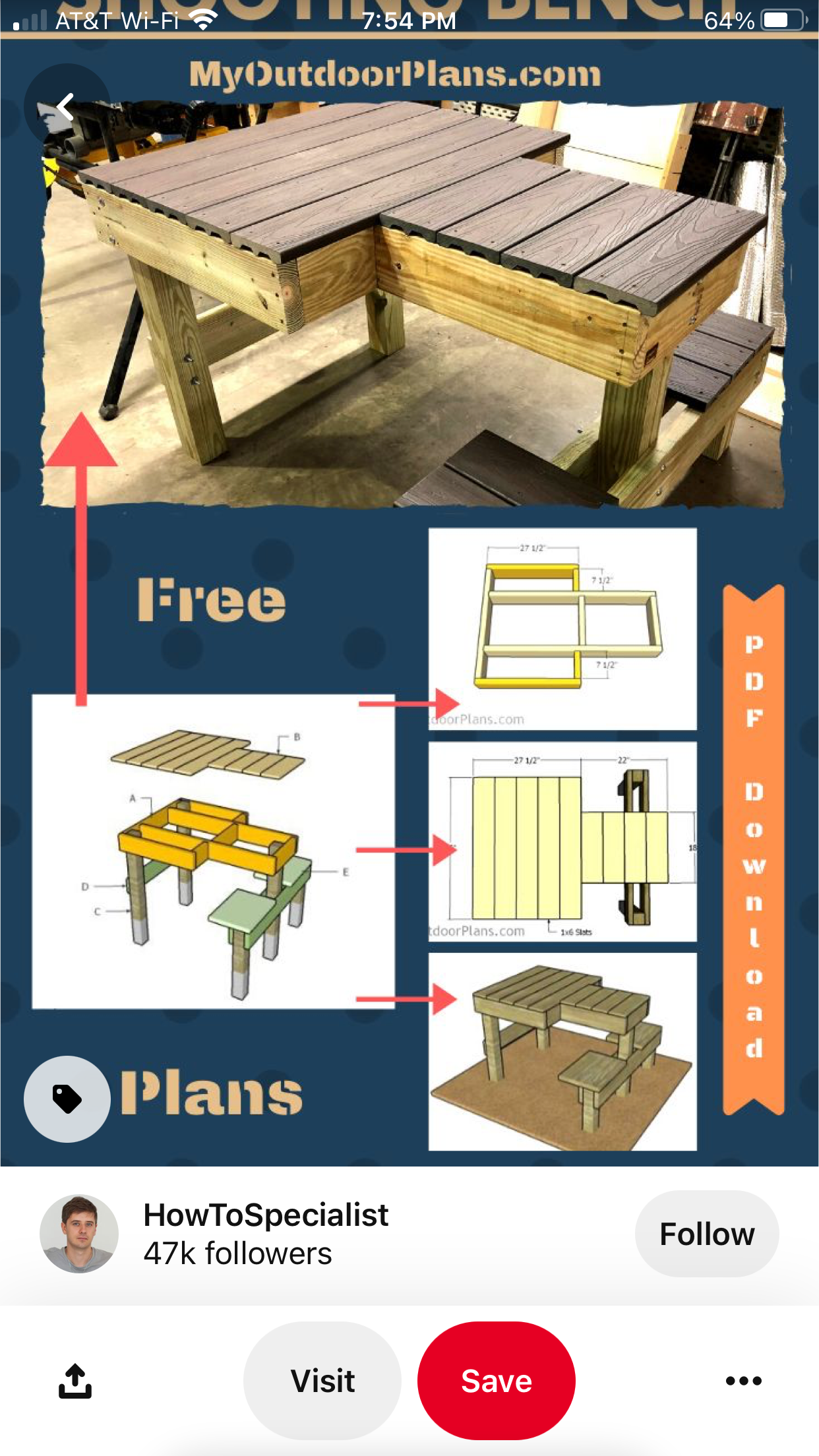

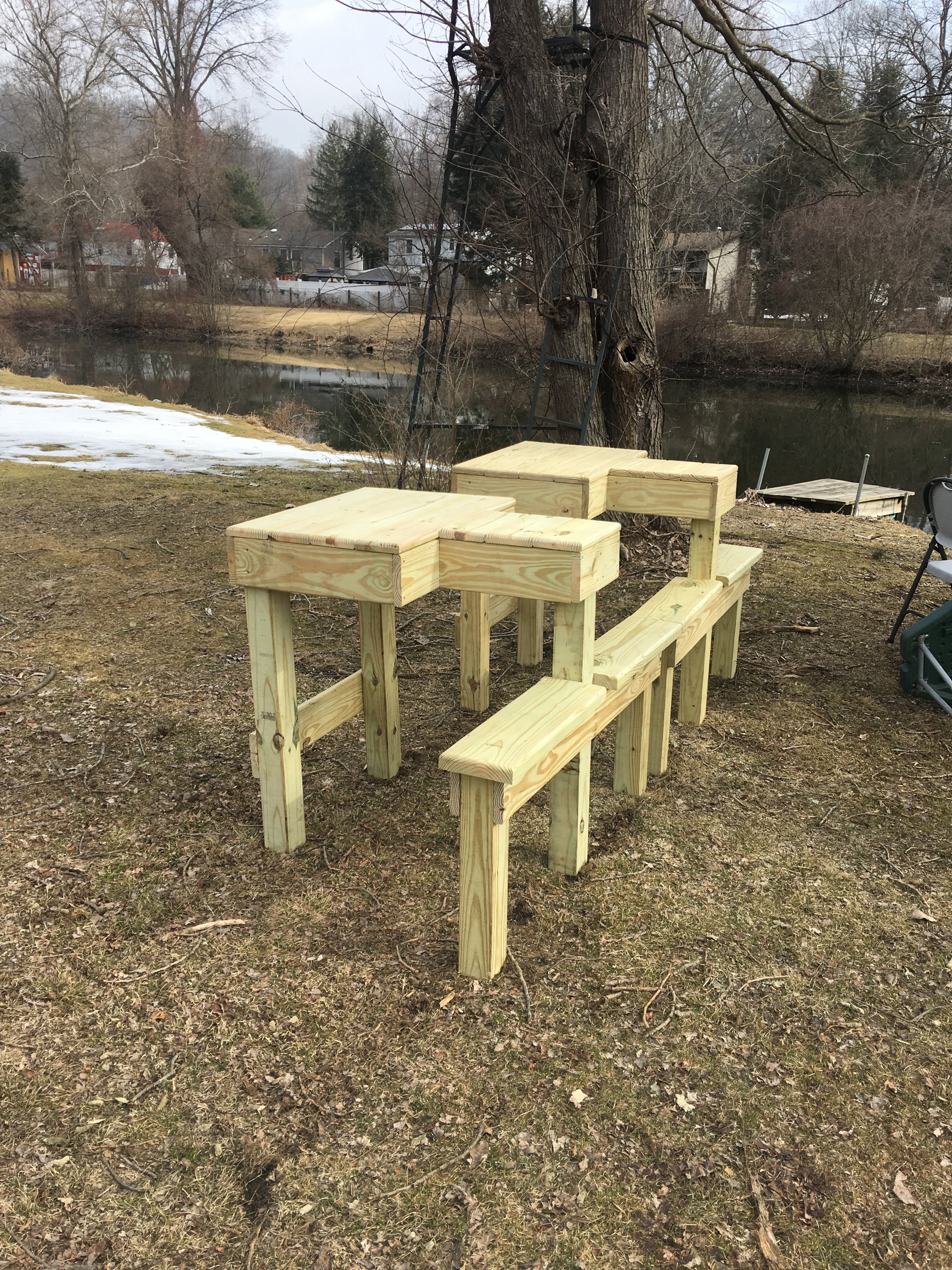

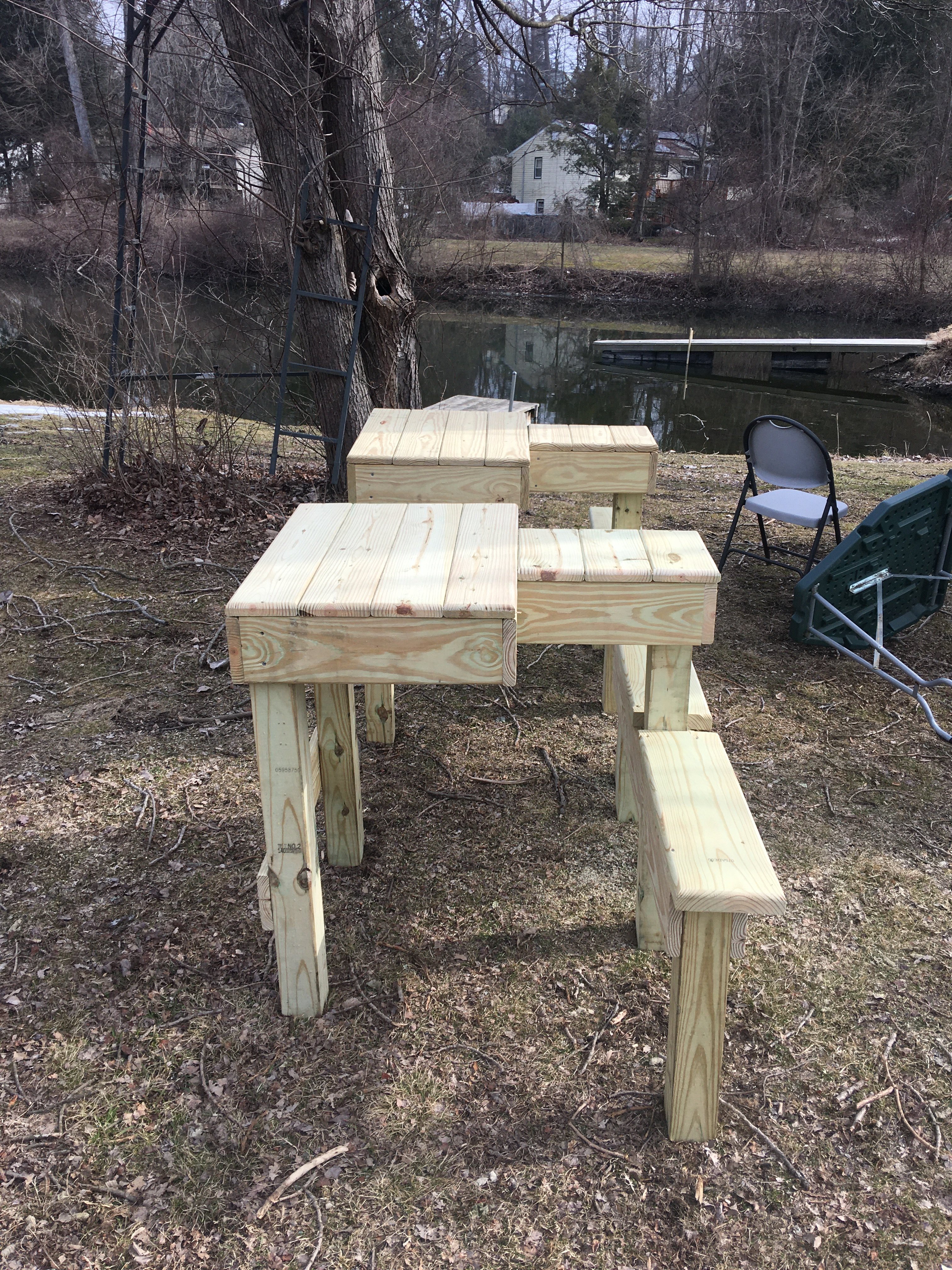

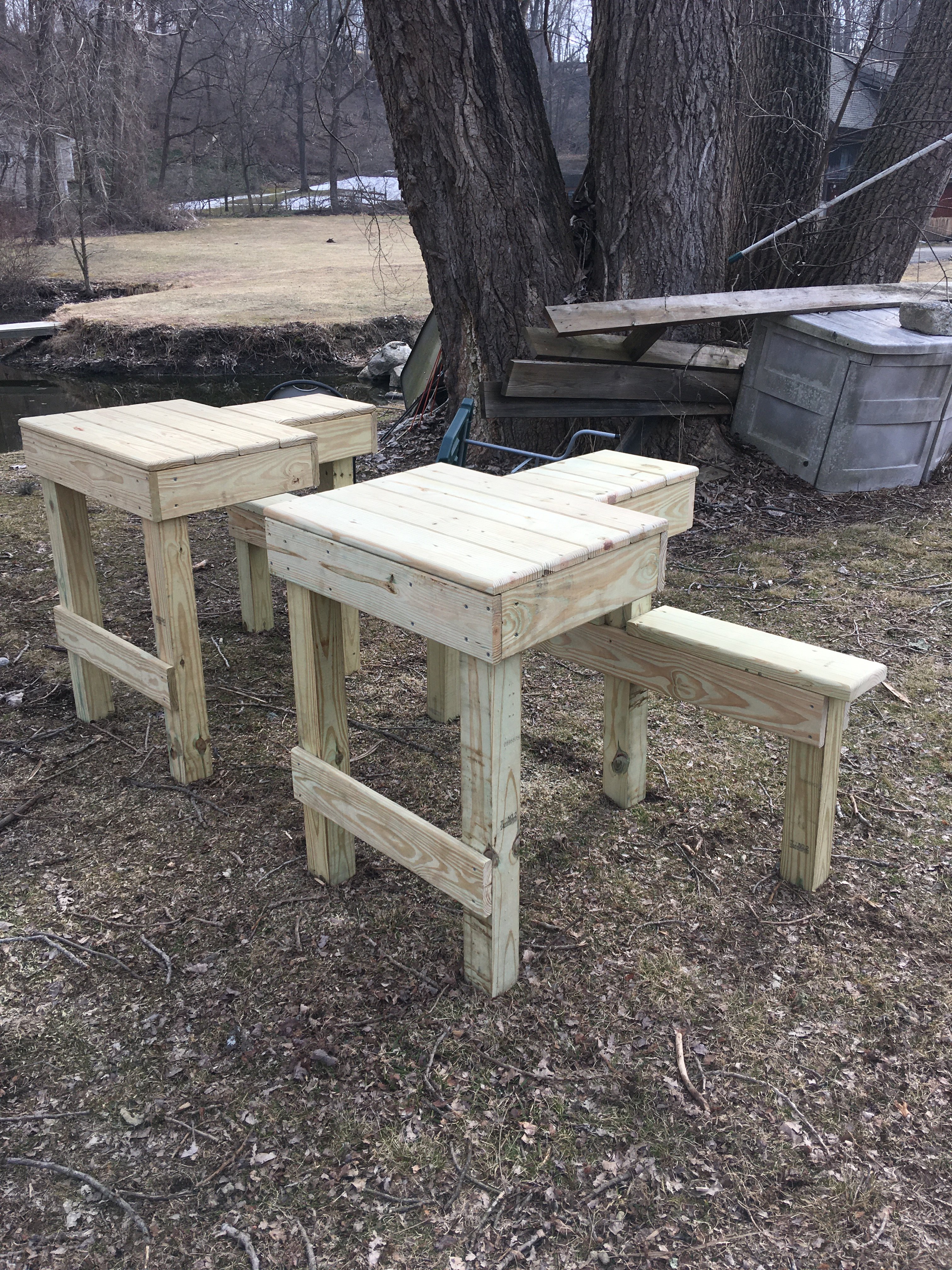

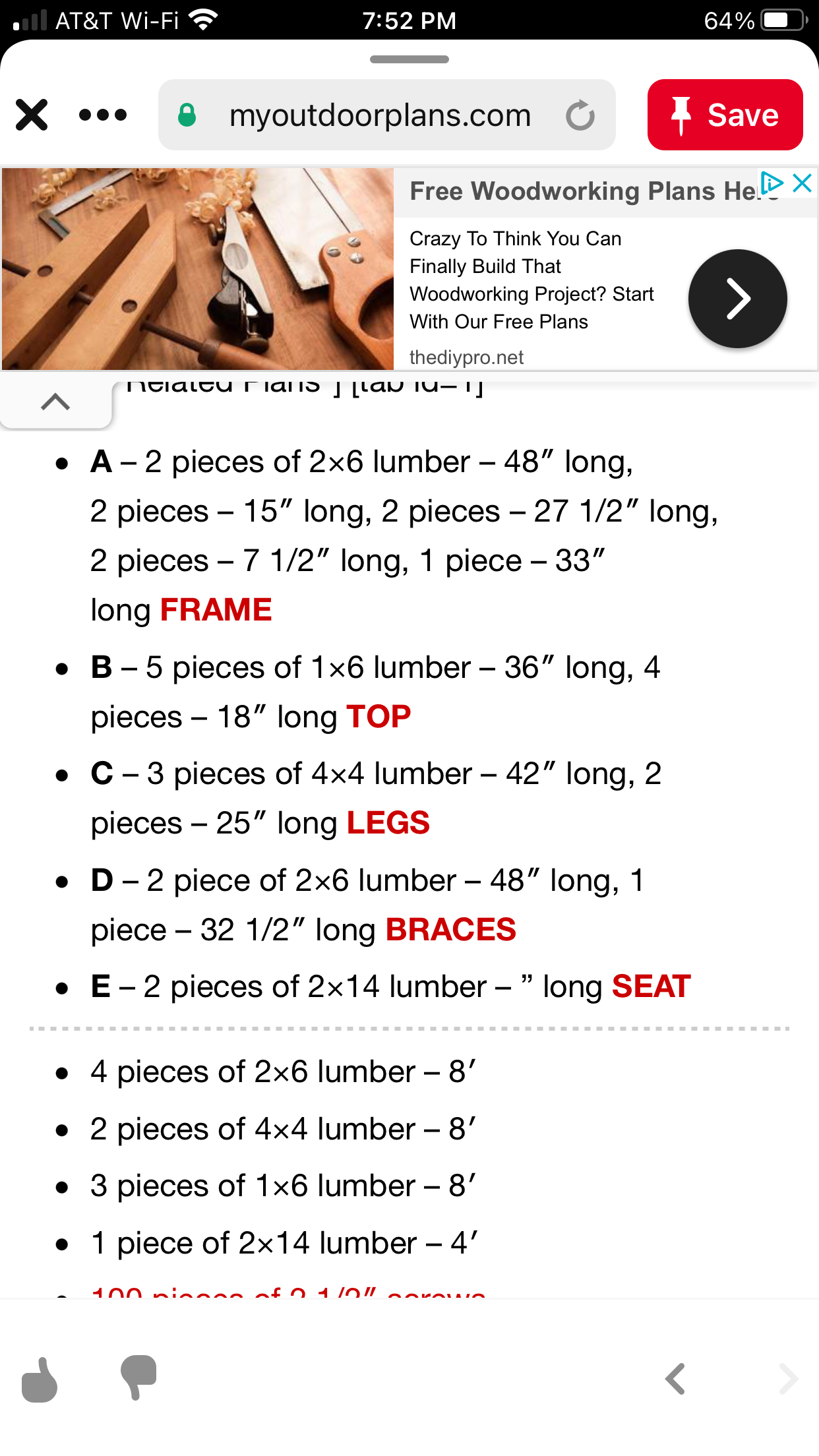

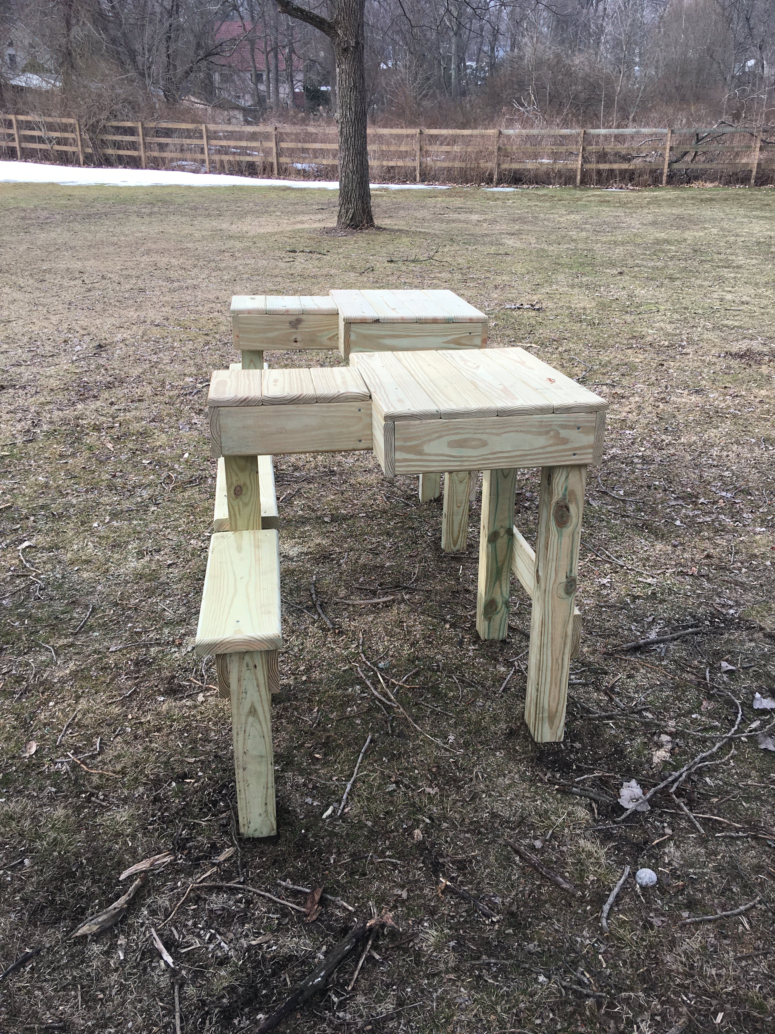

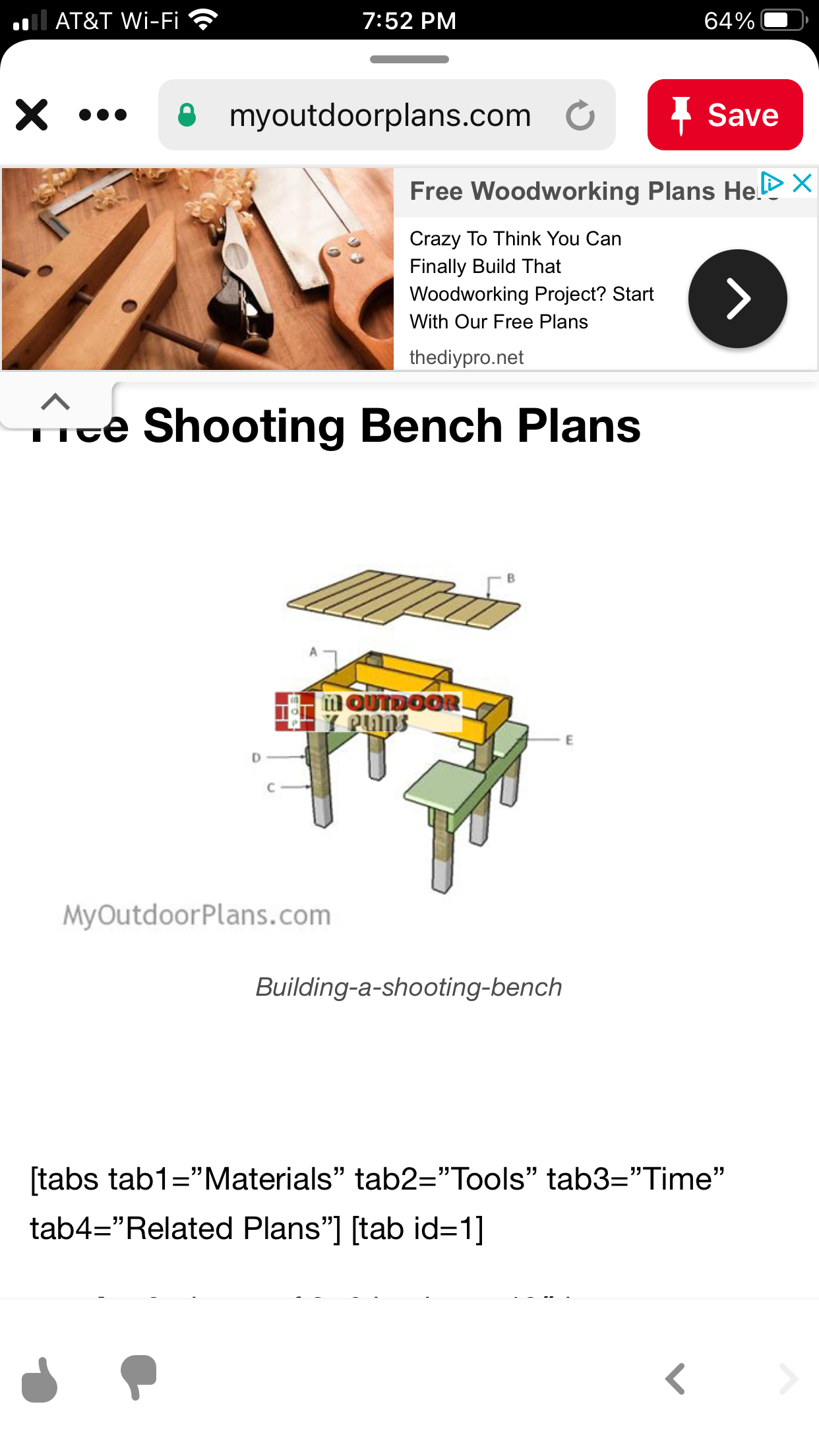

This worked good for me and wasn’t hard to build.
