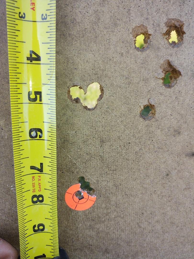

My limited experience with round balls has been with my Texan .308 and Sam Yang 909 .45. Neither shoots round balls worth a $#!t. The Texan is just too powerful and a) cracked the sound barrier, b) they were all over the place at anything longer than 50 yards, and c) they leaded up the barrel instantly. As far as the Sam Yang, they are not as bad but 35 yard groups were about 4" where as cast 158 gr. bullets were touching holes, and at 100 yards was about 1.5" to 2".
The pic below is four shots at 35 yards. the right side is round balls, the left is cast/sized bullets (the small red-dot group is a .25 pcp)
I have yet to see a case where round balls out performed a quality sized/lubed cast bullet. There's probably an exception, but that would it....an exception.
