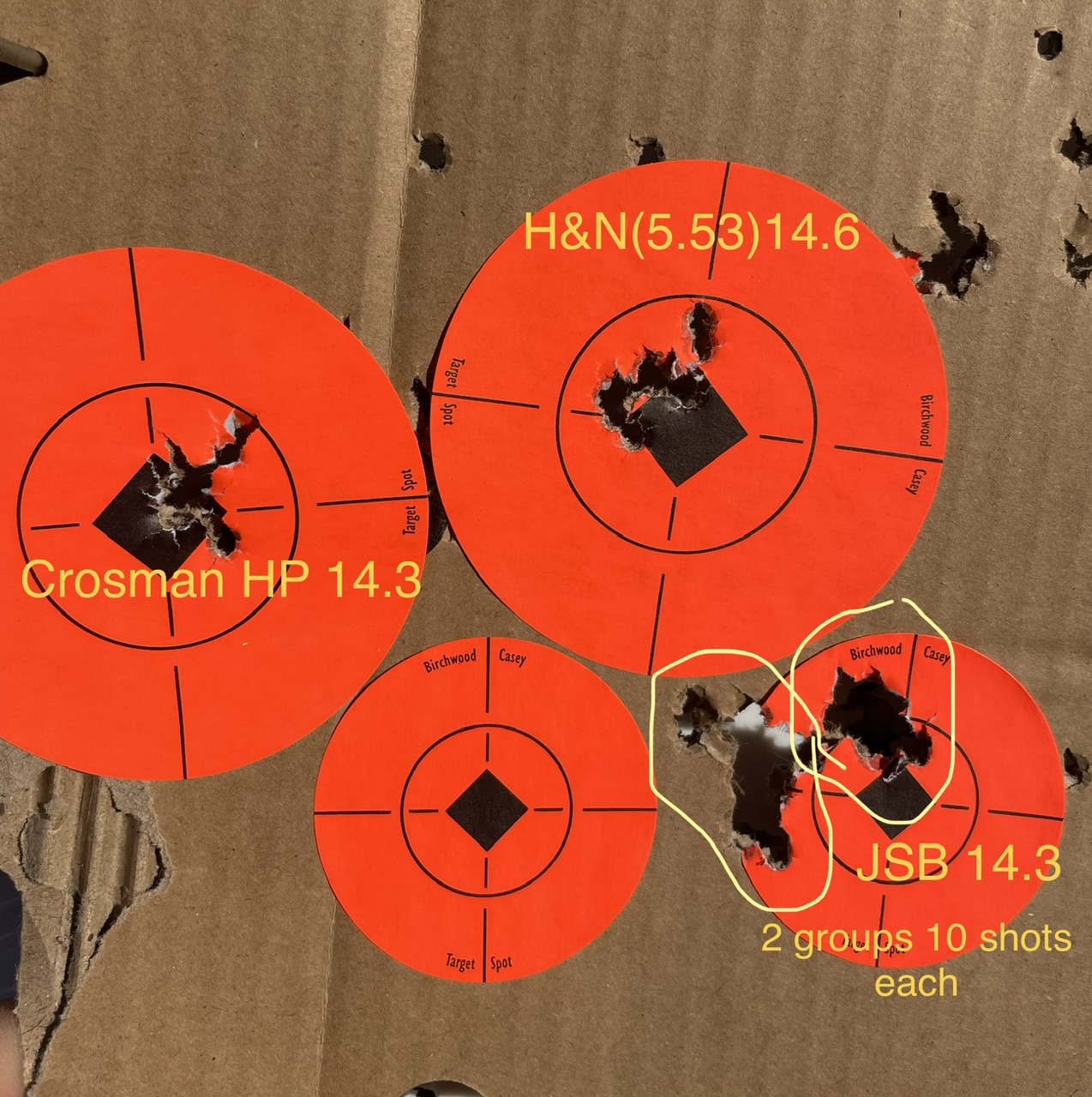

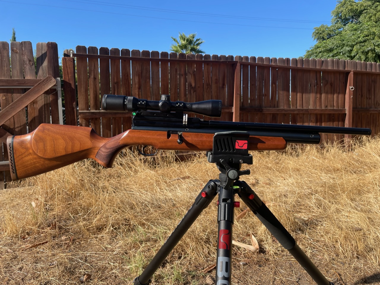

Finally got to shoot it today and oh boy is she accurate! Ragged holes at 25 yards with everything I fed it. The cocking is butter smooth due to the plastic ball bearings on the hammer guide. The trigger is light and predictable. The shot cycle is short and tame. It only shoots at 11.5 fpe and is very quiet due to the shroud having 4” of baffles. Not only does this rifle perform well but I like the traditional look. The walnut stock has nice lines and the finger groove on the forestock provides a secure grip. The blued tube is a nice touch. Shoots like a Daystate Revere, looks like an FX Tarantula
