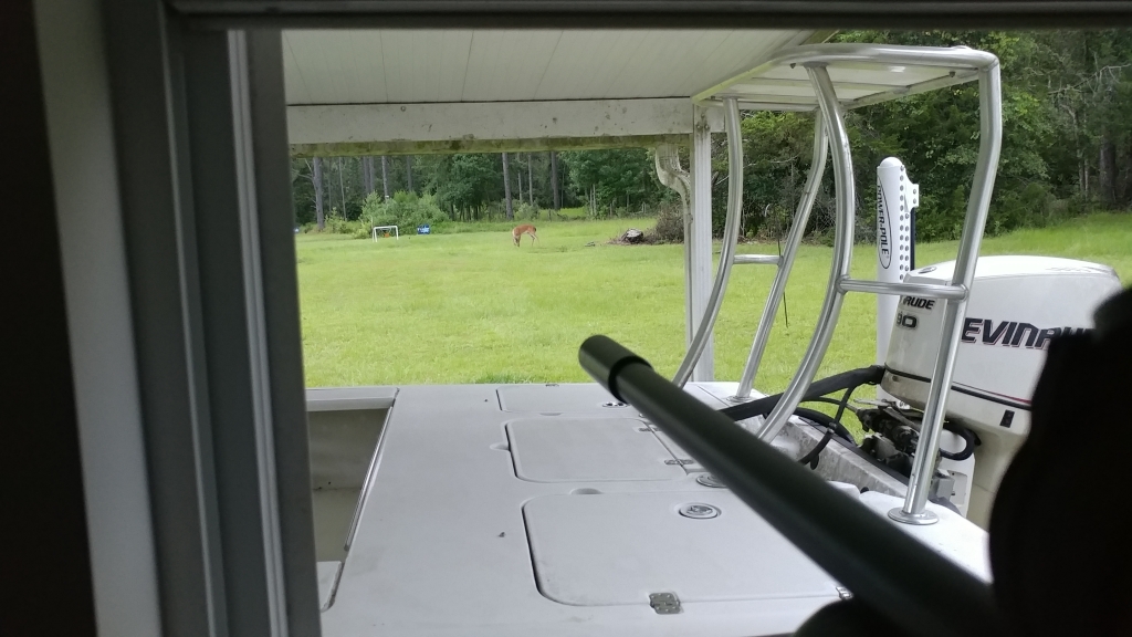

Or you could do like I do down here in Florida this time of year(every day over 90° with over 60% humidity) and open a window to shoot out of while AC blows on you.😜

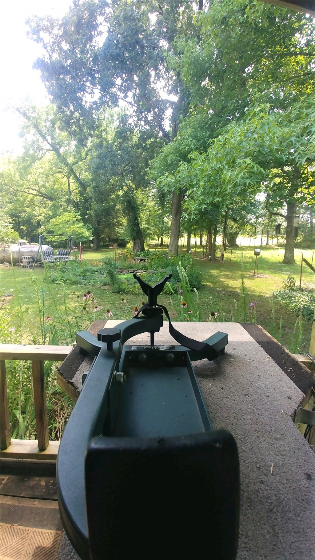

So after this mornings post on this subject I went out to shoot a bit. No hurry I put the rifle in the lead sled on the bench. Let it acclimate to the outside environment while I put out the spinners. By the time I was ready to shoot the rifle was dry and the outside glass on scope was not fogged. After shooting did the process in reverse. I did notice returning to the house that it doesn't to seem a extreme as going outside. I feel for you all to the South and South East of me. You all deserve medals or a trophy. I am blessed to live in the country and being able to shoot as I want and where I want. Have a nice range and bench is under the lower porch. 50 yards on the nose to end of the yard and then add another 70 yards on the farmers field side.
