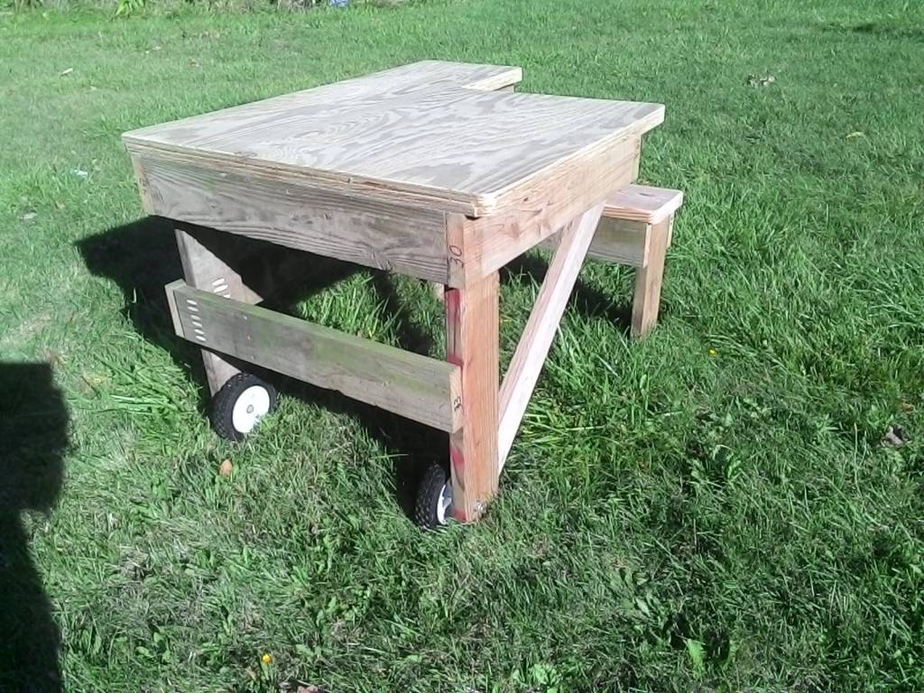

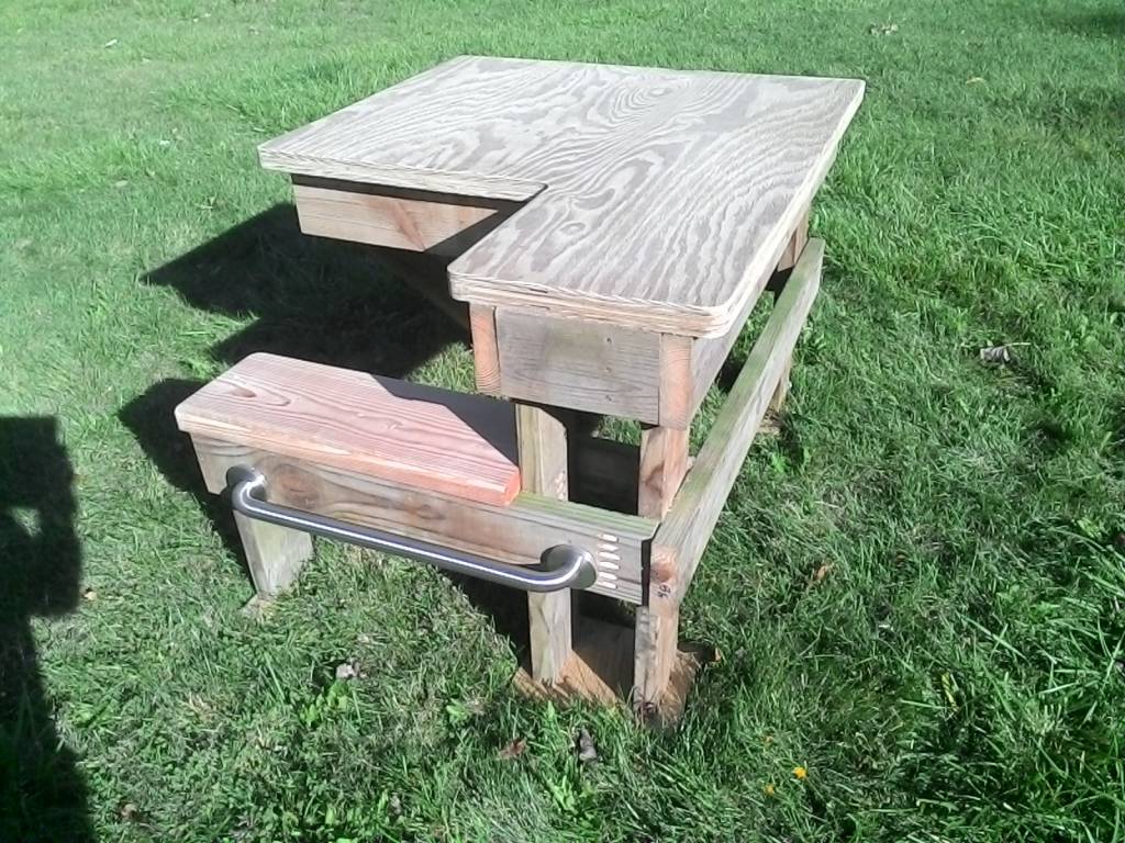

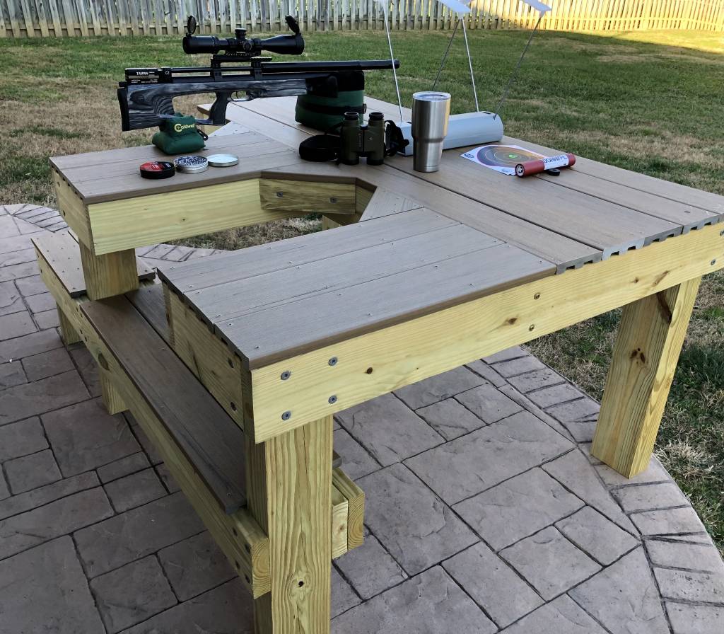

I can't imagine what it would cost new today! Built mine a couple years ago with with reclaimed and/or scrap PT wood except the top. Top is two layers of 3/4" PT plywood, bought new. HEAVY!!!
Framed as though it was a Deck. Very stiff.
Stainless shower grab bar for lifting and moving it around. Short distances! Like for mowing...
That's a good looking and functional bench BSJ. I like the grab bar and wheels, and that you have a platform under those rear legs. I could roll that up onto the gravel while not using it, or when I need to mow, and it looks sturdy as heck!
Thanks for posting it!
The front legs have 'feet' too. 1/2" PT to keep the end grain of the legs from direct contact with soil.
The wheels are barely touching the ground when its flat. They are set forward in the legs so that they make full contact with the ground when the rear is lifted. The front of each leg is 'notched' with a 45deg cut so that the corner won't drag when lifted too.
