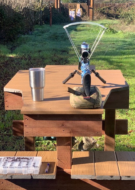

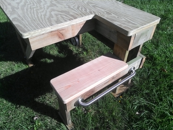

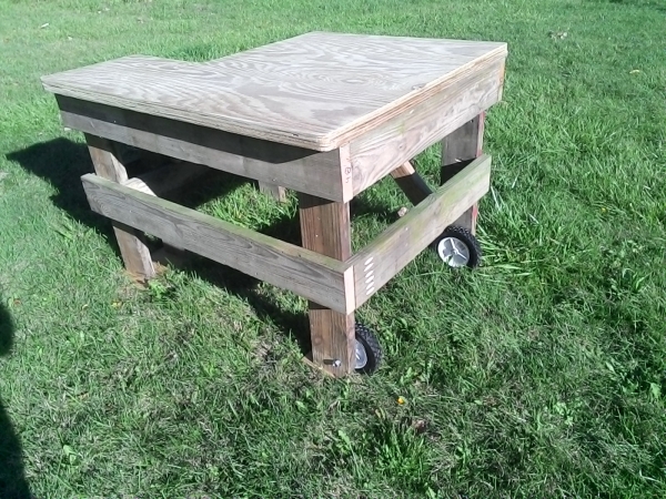

Yep, I had planned on using a router to round the edges and make it look cleaner. I also added a couple shorter length boards up front so I can use my chronograph without it being too close to the barrel... might need to add one more? Still trying to decide If I should attach the bench seat or just use separate chairs. It's already heavy so I probably will make a short bench and connect it to the rear. Merry Christmas, Stoti

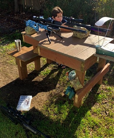

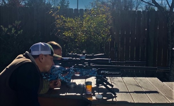

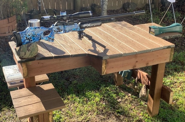

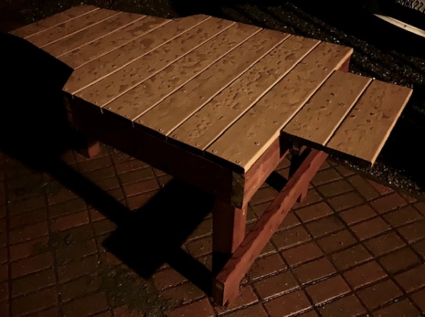

Finished our bench and got a chance to use it today. All pressure treated 2x6", a 4x4' and Trex decking for the top and seat. Will require no maintenance which is a big plus. I built it with the help of my 11 year old son. We had a lot of fun building it together. Hopefully we'll have many fun times shooting off it together too! My son's can shoot from the right hand shooter side and me from the left hand shooter side. Set up in the back yard... we have targets at 40 and 50 yards and love it!

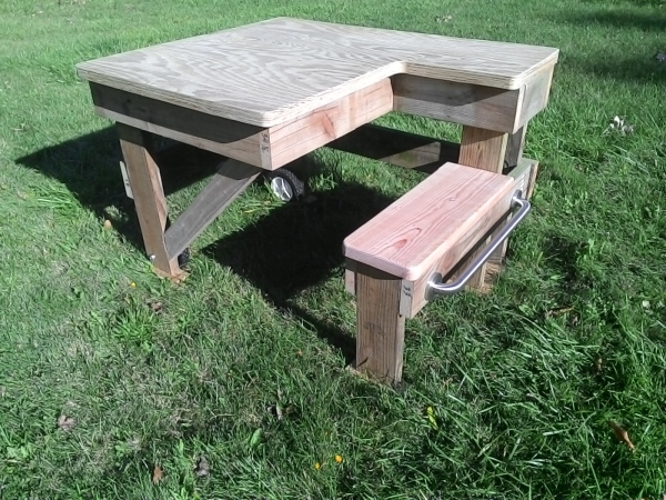

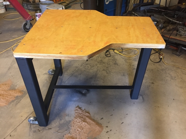

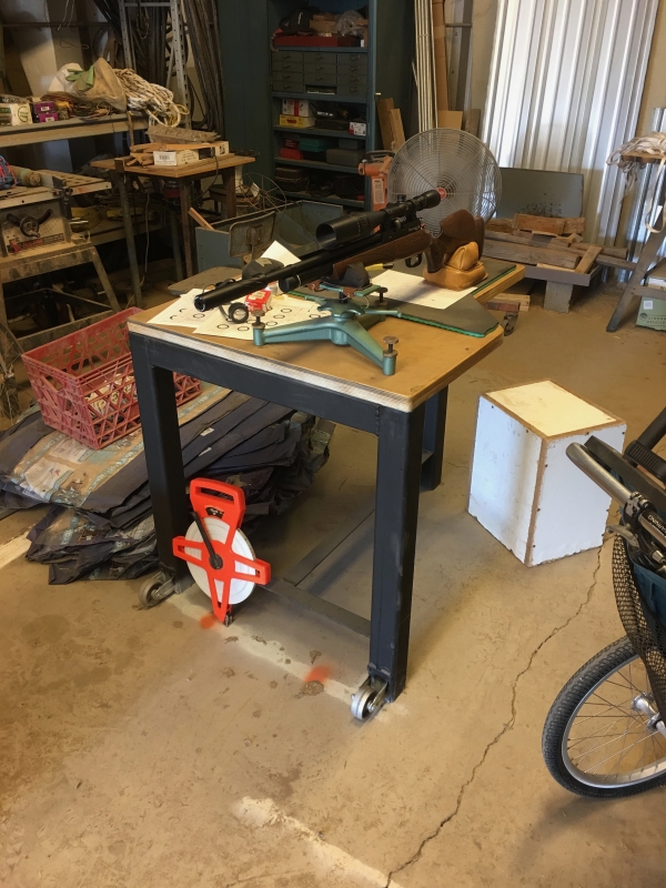

That's a really sweet bench! I don't have a welder or I would have gone that route for sure. Sturdy, maintenance free and clean looking. Would have been a lot less time to build and a heck of a lot lighter than mine too.

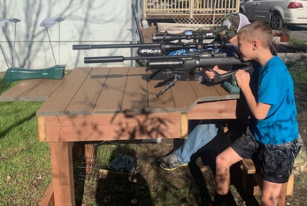

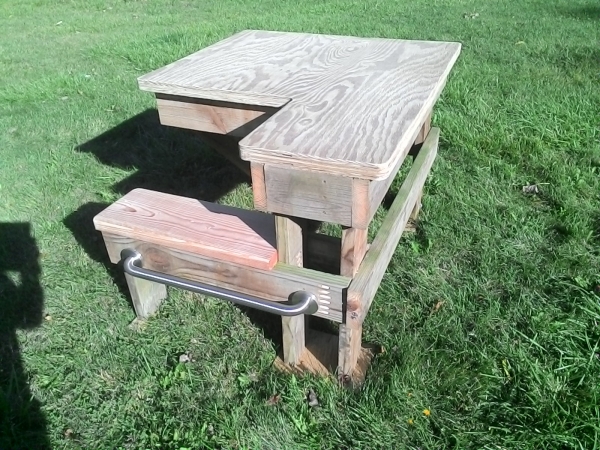

I do love the way our bench turned out. However, I went back and forth whether to use the bench seat with my shooting bench... I ended up building it and attaching it since I had the materials. After using it, shooting all day with my boys, I ended up taking it off. It limits our shooting positions, it was too low for my youngest son and it just wasn't comfortable. We pulled up a couple of cozy chairs from our outdoor furniture set and man is it comfortable to shoot from now! We also added pellet holders and a little basket underneath to hold our Chronograph, extra shooting bags, shooting glasses, etc. I'm so glad I built this table so I don't have to use a flimsy card table or shoot prone when I want to punch paper in our home shooting range. It's a lot more comfortable for my boys to use as well and if they're shooting with me, I'm happy! Stoti
I debated with not building an attached seat. Not having to add to the amount of equipment needed to drag out for a shoot won out.
Although I did shoot from my adjustable stool for a while to determine the exact height I wanted.

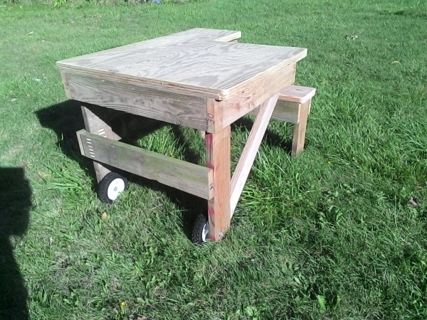

I like the wheels on the steel bench! It's hard to see in my pics, but my wheels are flush with the bottom of the legs so that most of the weight is borne by the legs. The front part of the leg is notched so that lifting the rear transfers the weight to the wheels. The $15 grab bar is nice and comphy for dragging it around the yard...
Thanks Jim, they're definitely my two favorite shooting buddies. Once we got the gun situation sorted out and they both got good PCP's to shoot(Brocock Bantam Hi Lite and FX Streamline), we've been having a blast. They were both good shots before we got the PCP's for them but we shoot a lot more now, since we have a range in our yard. We also have vineyards and National Forrest all around us when we want to go hunt, which is about every weekend. We had a blast building this bench together and hopefully we'll have years of fun shooting off of it too. Happy New Year! Stoti
