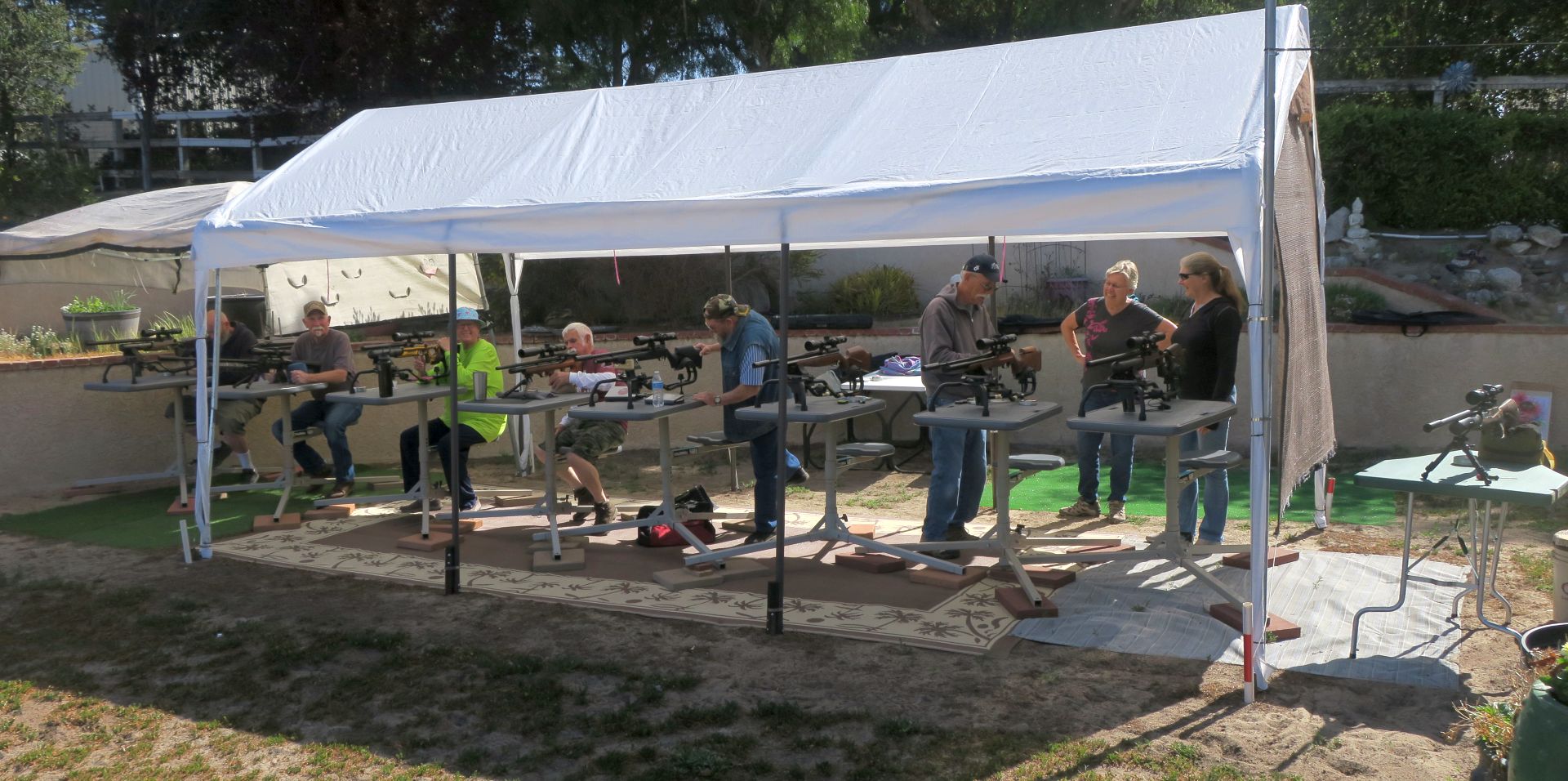

you sure got it going on at your place Tom. love layout great fun with all your buddies im sure. how often you guys shoot
Hi Douger,
We've had weekly shooting sessions for almost the past year (since I've introduced a bunch of fellow Cowboy Action Shooters to the joy of airguns). I've tried to keep it interesting for them with new and different reactive targets, including holiday themed targets for the different times of the year. And now most of them have started designing and making targets on their own for the group to shoot. These include things like dressmaker's pins mounted on a wine cork - drilled out and mounted on a rod so that the cork spins to a new pin when you hit one), and target boards which are hung so that they move in the wind and spin when hit, or are mounted on old rotisserie motors and spin. Even one placed on an upright motor, which spun like a carnival ride - a large "T" shaped bracket with strings attached to each arm, and on each string were glued Necco wafers to shoot.
We've got some pretty creative folks in our little shooting group.

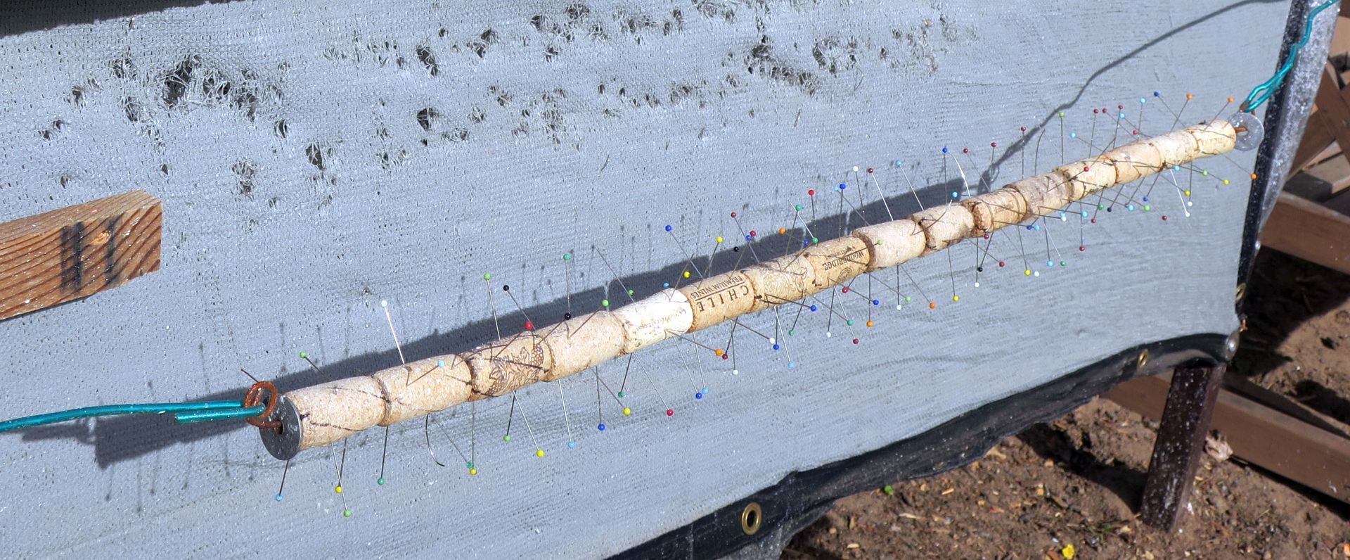

The 'Pin Wheel' in its first iteration:

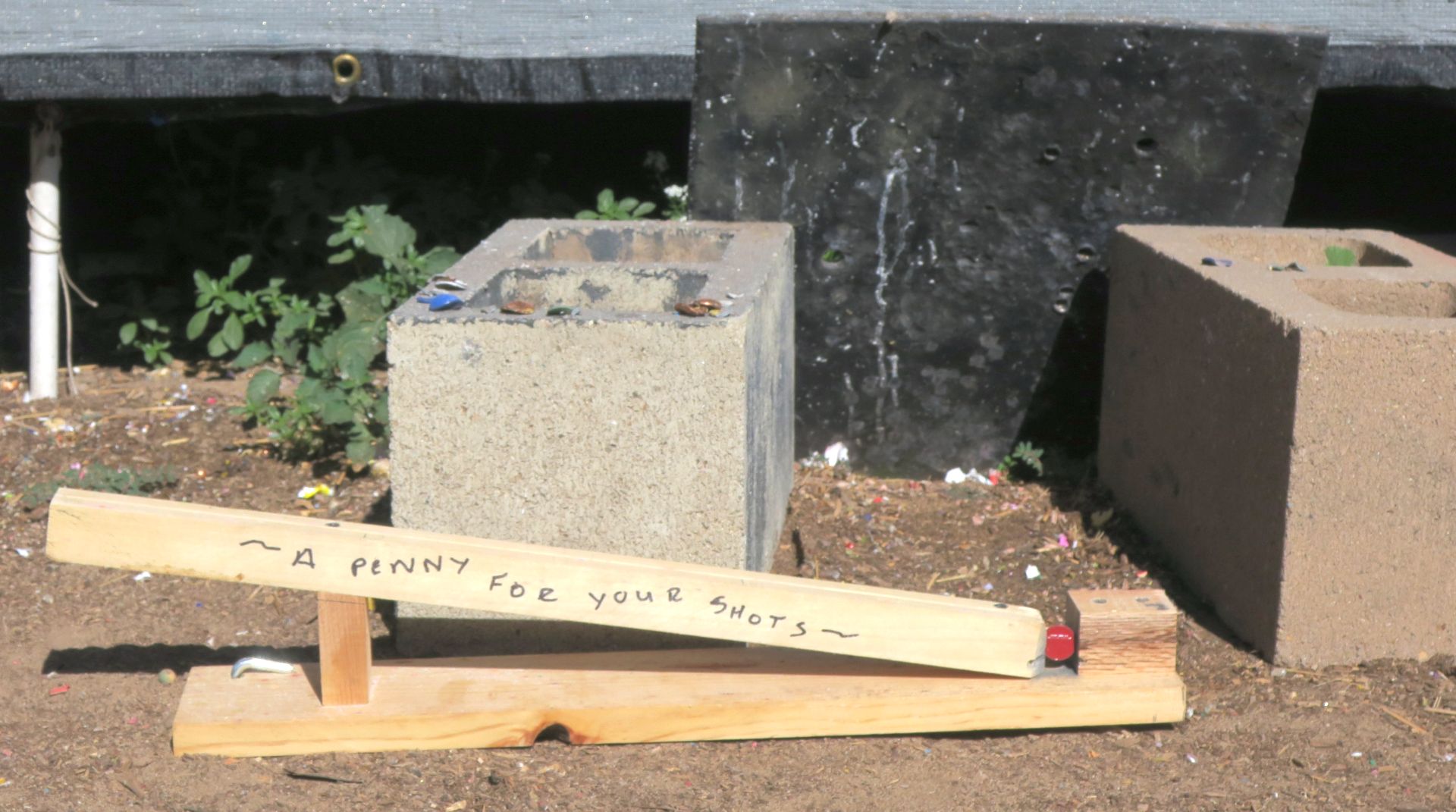

The penny dispenser in its first iteration:
