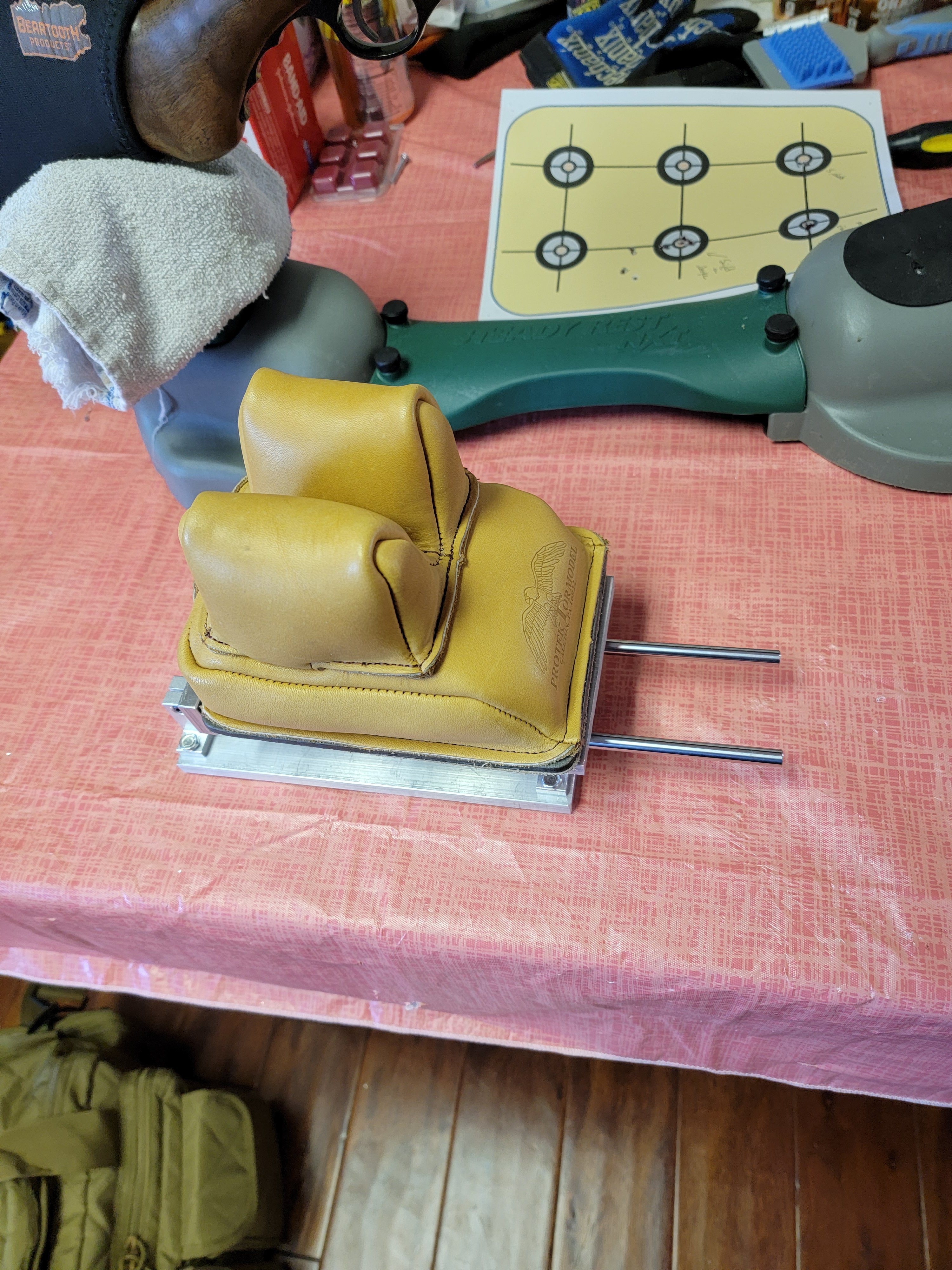

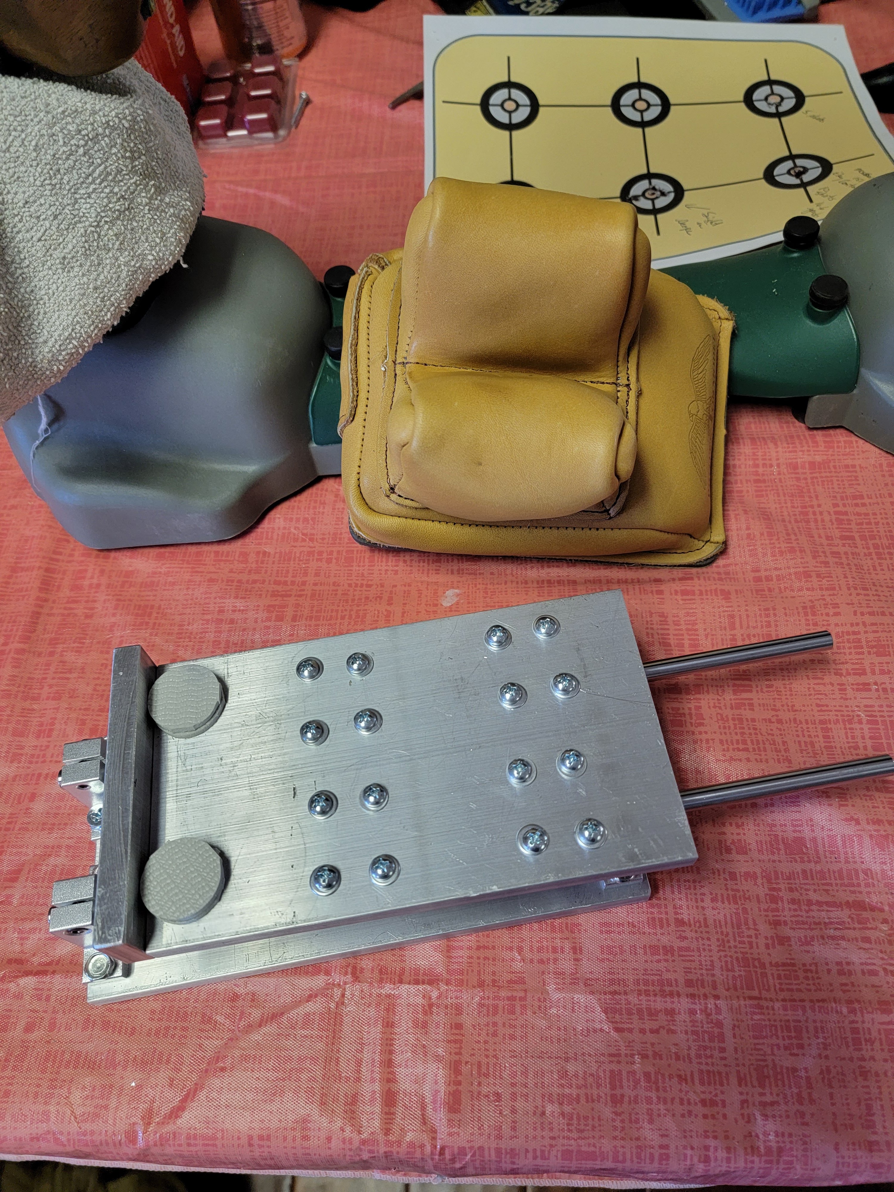

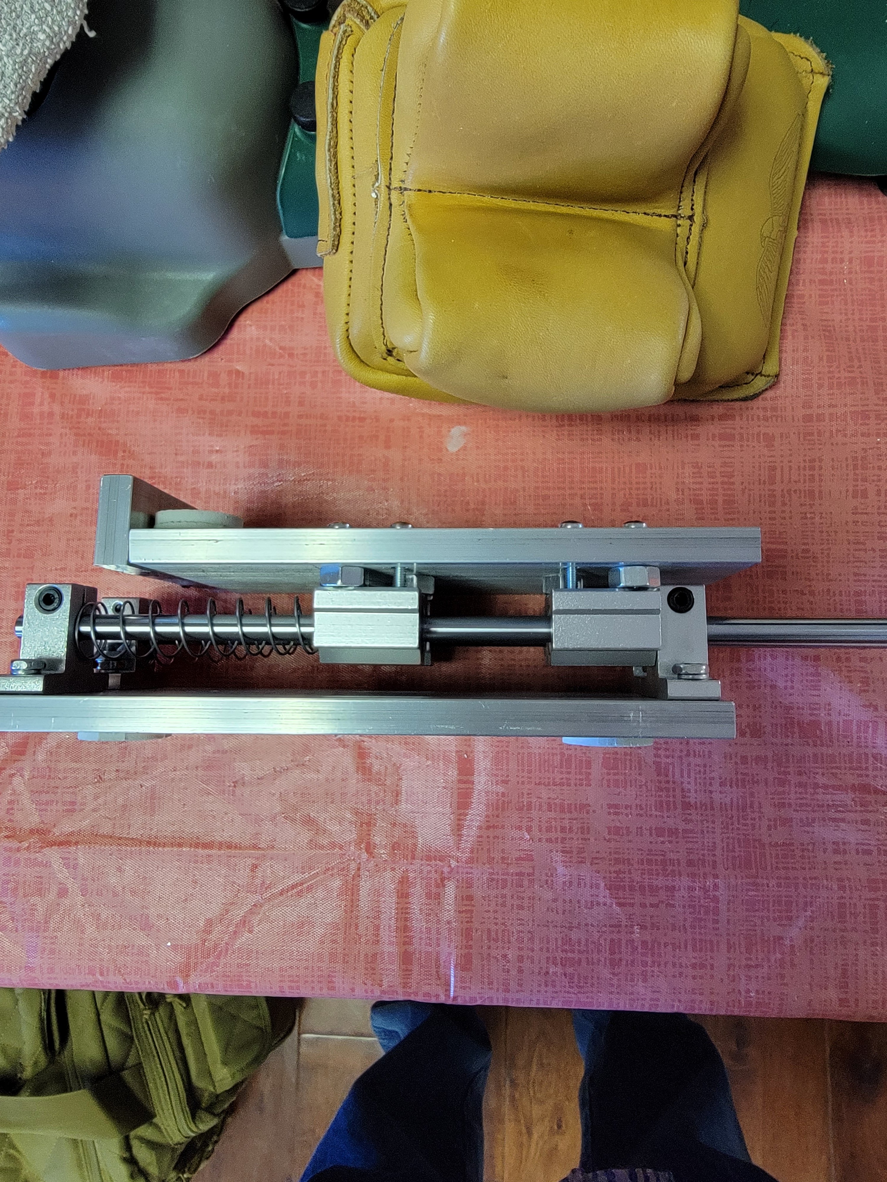

Really enjoy watching your videos. However, I haven't come across one the describes the contraption that the shooting bag sits upon...
Is that your design? The "sled" allows the rifle to freely recoil by sliding towards your shoulder? It looks like the spring compresses and then the rifle and bag return to the same position?
Tried to find your "sled" on the internet, but had no luck.

Yes, this is a one off design. It is a variation on spring dampener rests that have been around for years. Hyskore's has a version.

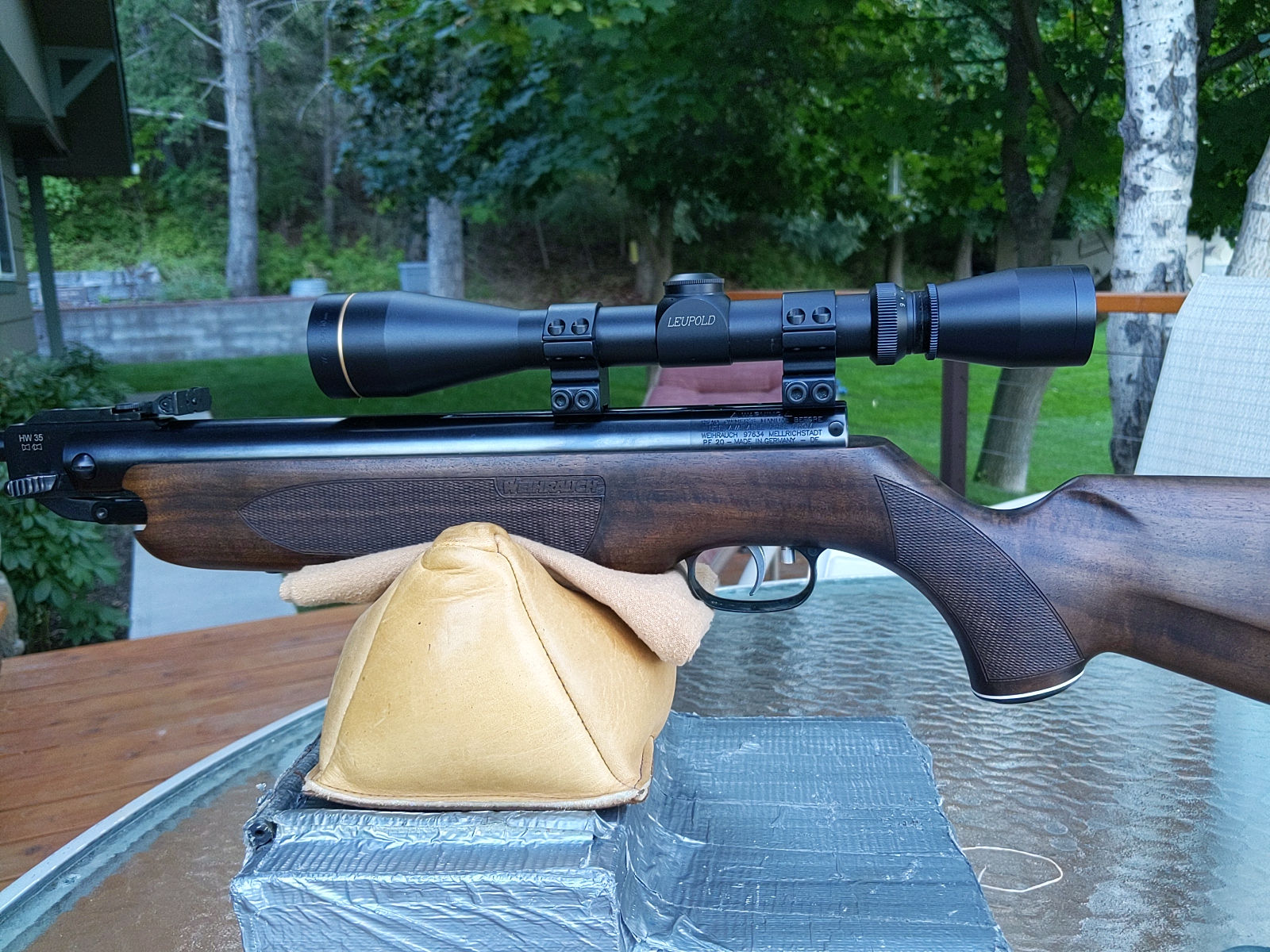

I have tried to rest the gun on my palm on my shooting bag. I get to much heart beat movement when I do. This is what I came up with. My 20 year old duct taped phone book rest, leather bag and a piece of flannel cloth.
Cheers
Zut
