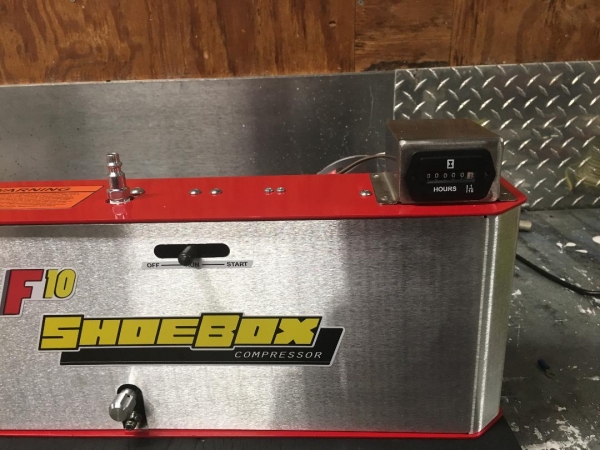

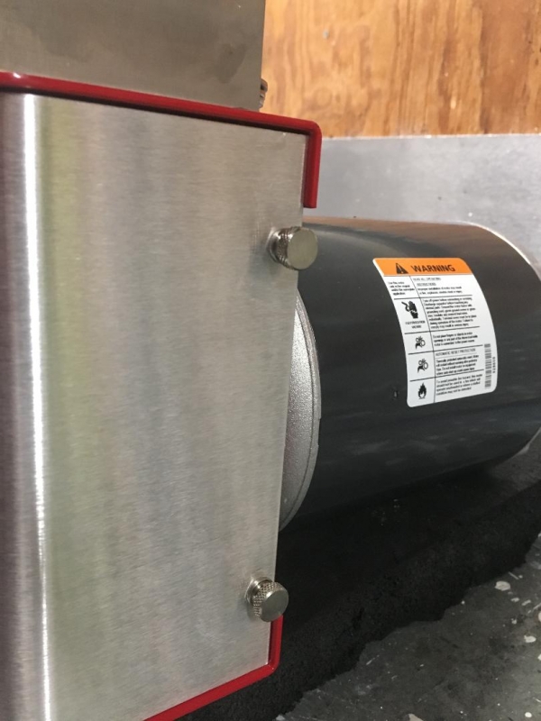

I have my shop compressor at 125 psi its a big compressor it goes to 150 psi but it does not kickback on untill it hits 100 psi. That could be why it took a little longer than expected. I didnt like those allens to take the cover off so i bought some thumb screws and an hour meter off ebay and wired it up today and made an enclosure for the hour meter to upgrades for $24 .
