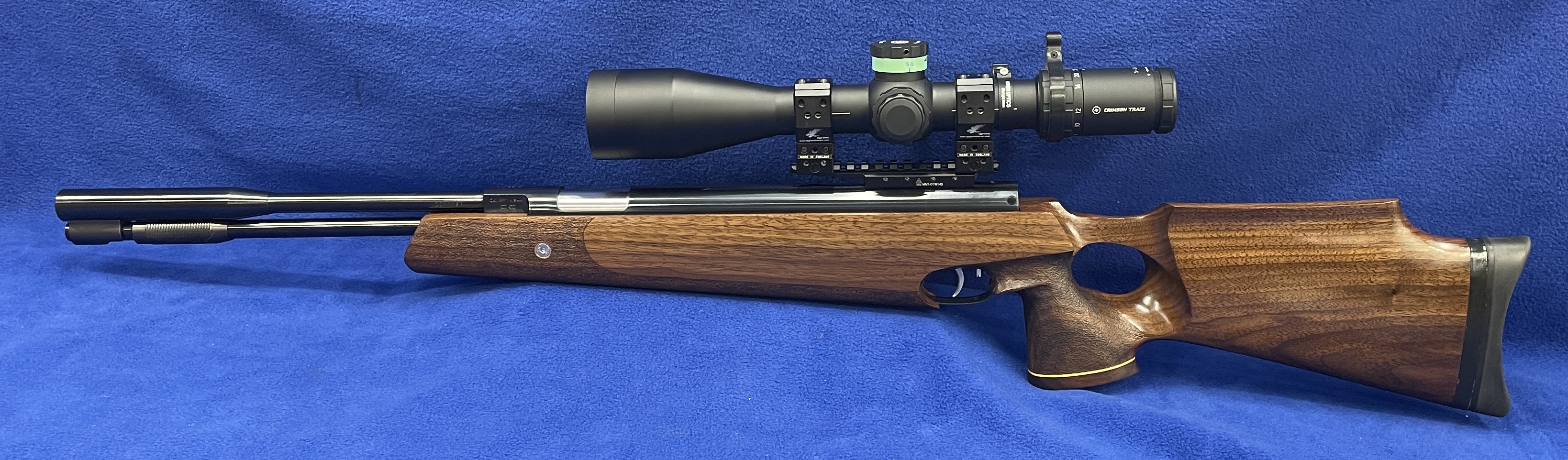

Start with a couple of pictures of the gun itself as proof of condition prior to boxing.

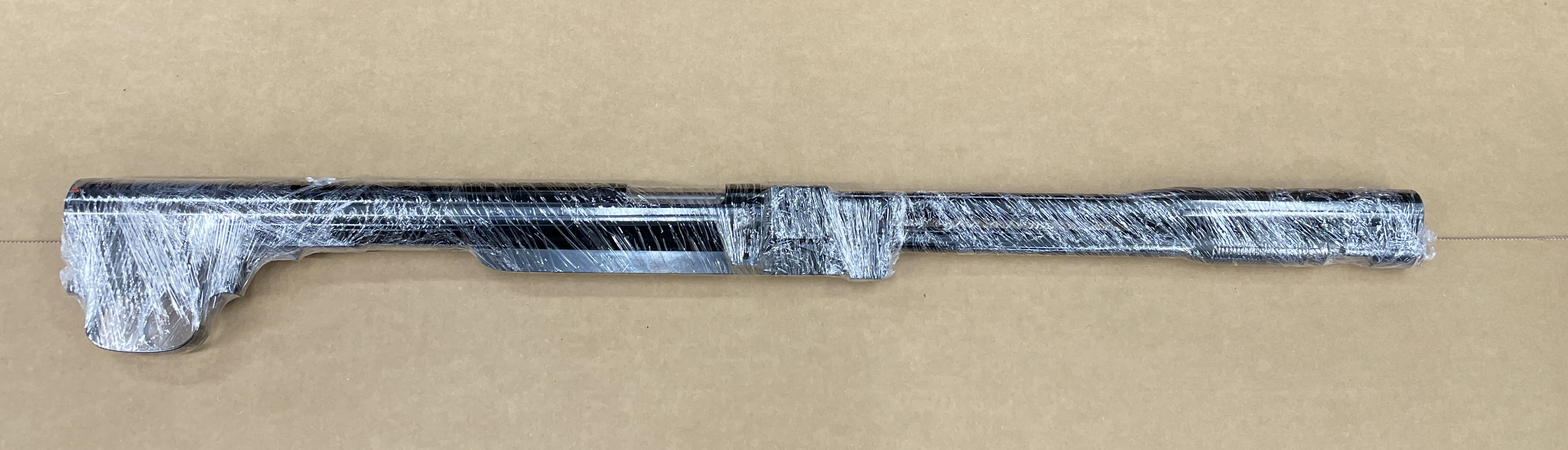

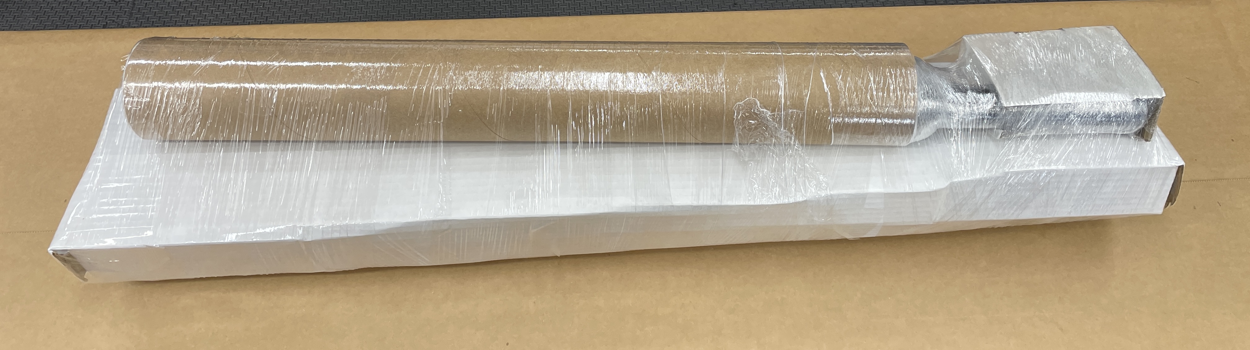

Next apply a light coat of oil and cover the action with shrink film to seal it from the elements during its travels.

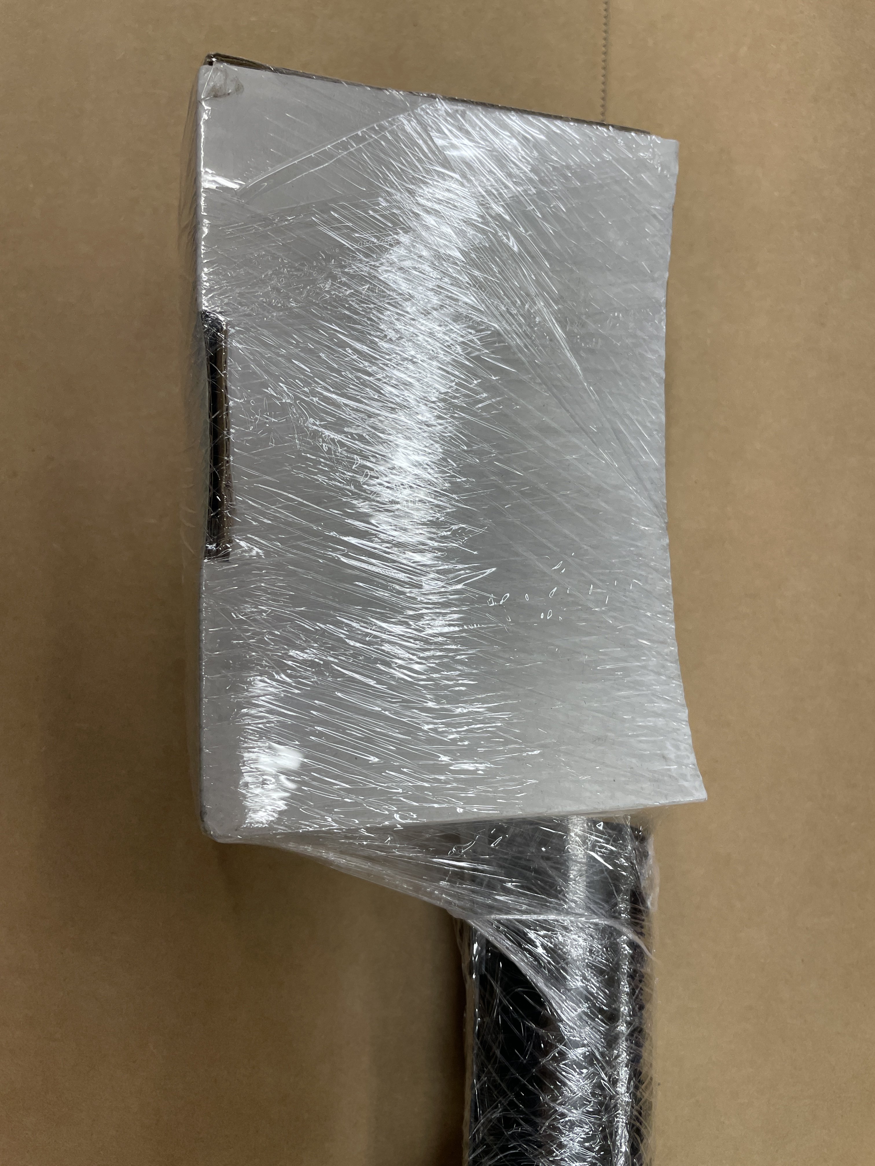

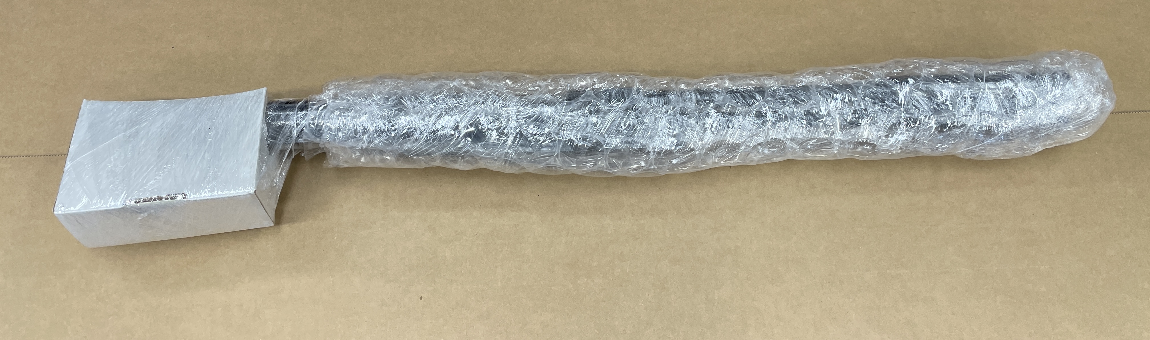

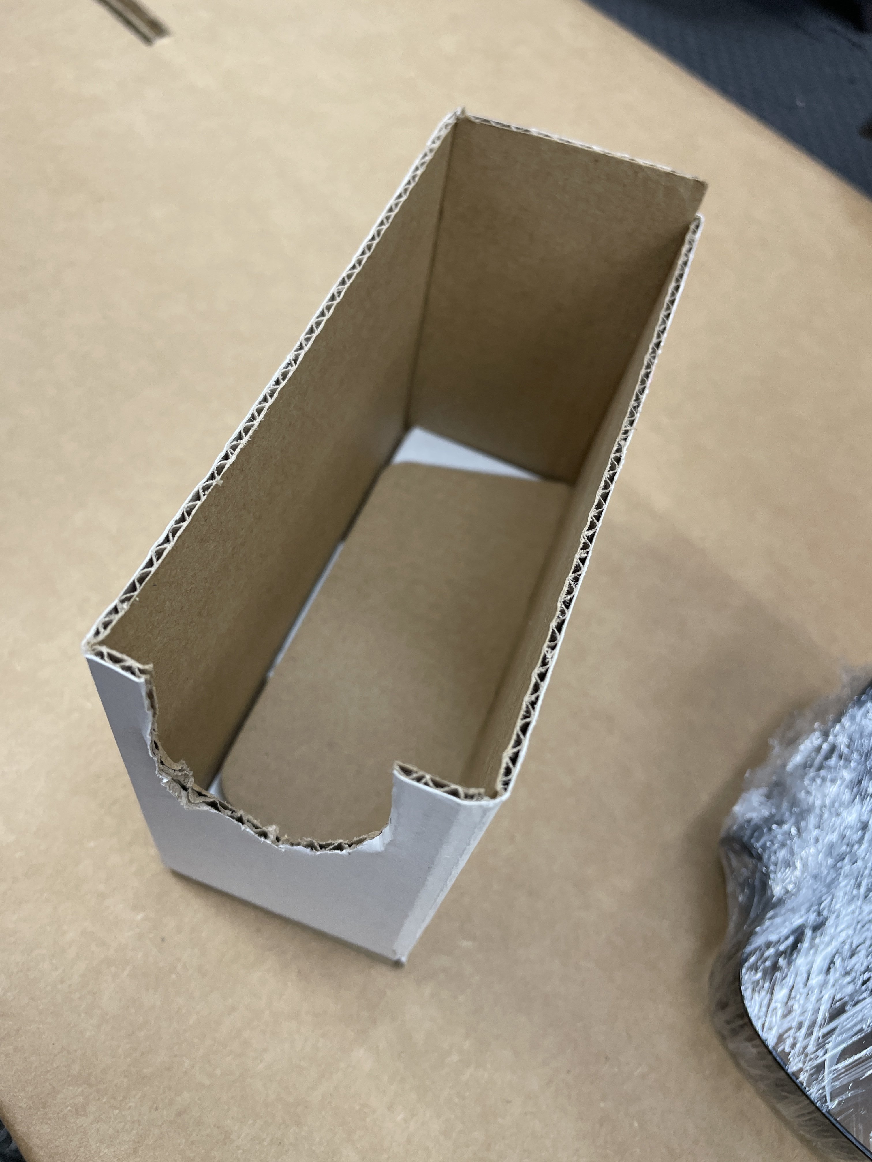

Build a box to pad and protect the trigger mechanism.

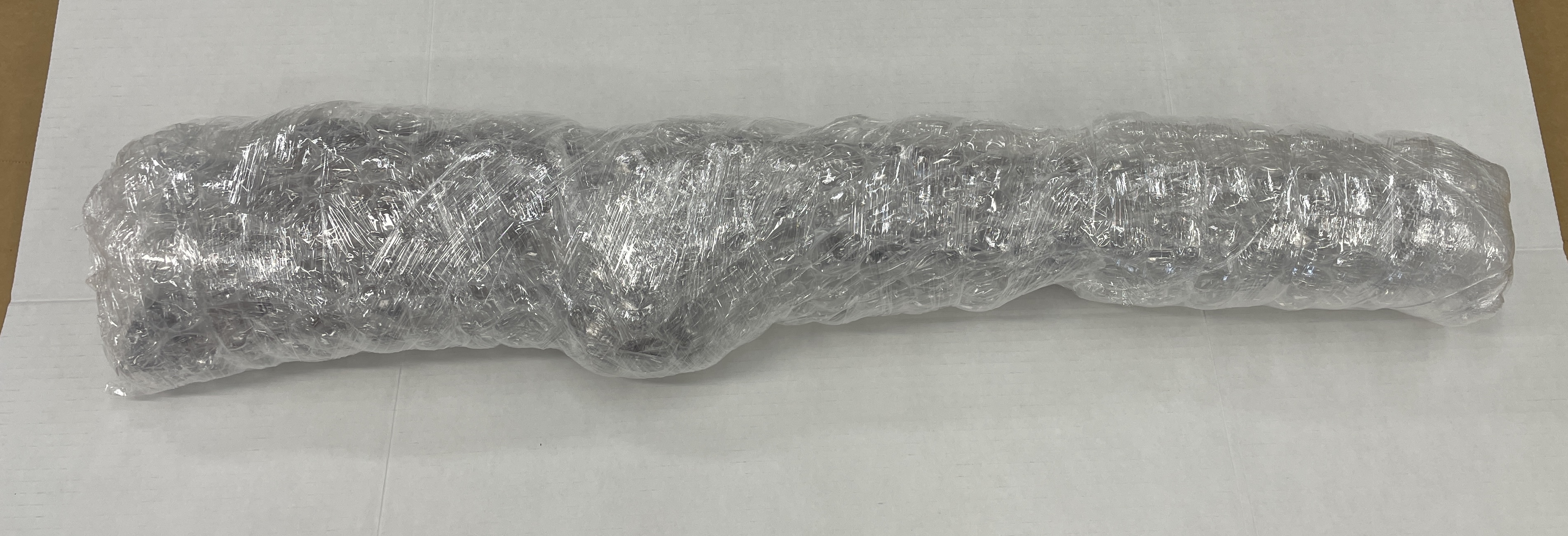

The rest of the action is covered in bubble wrap and shrink wrap.

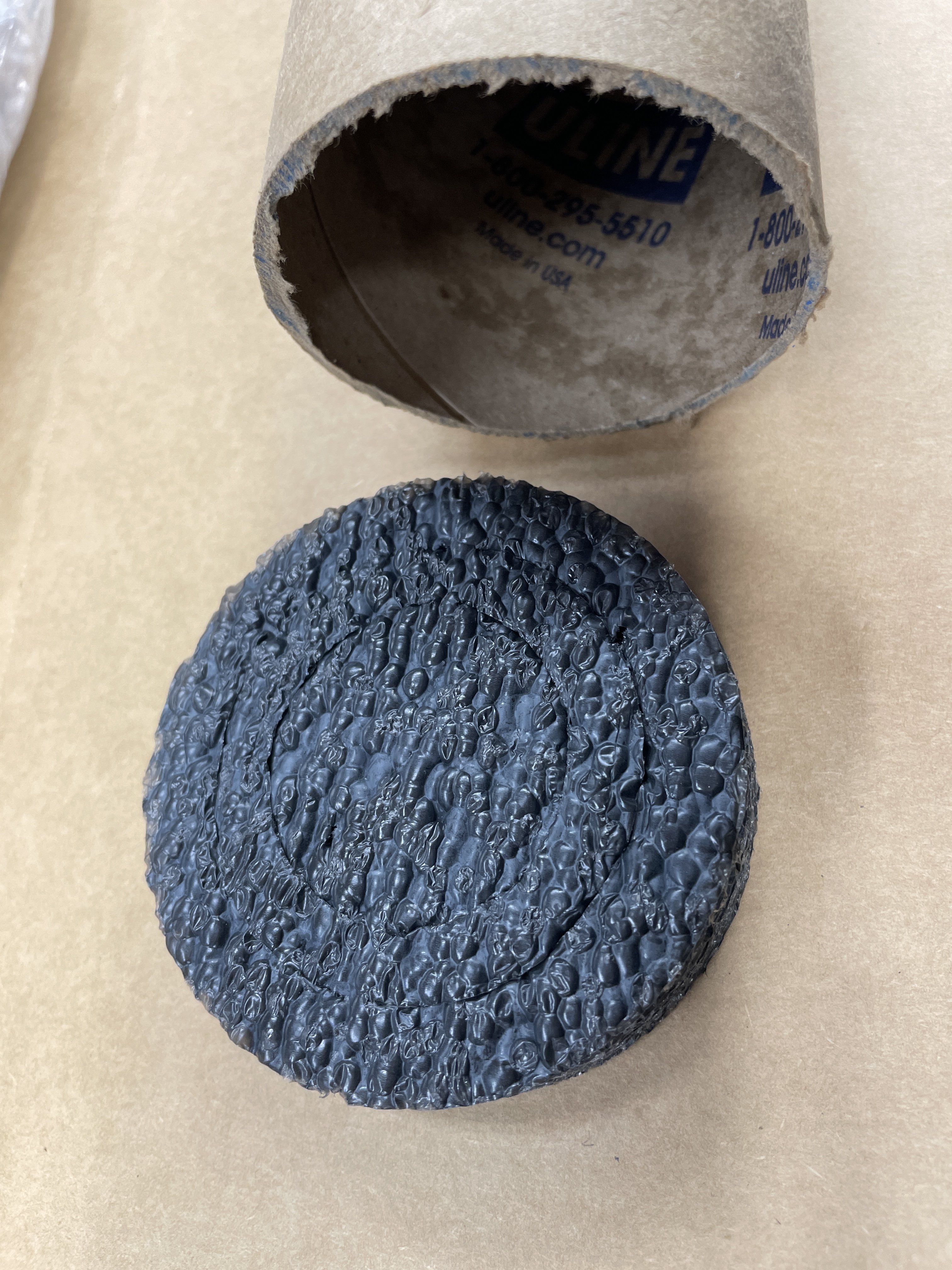

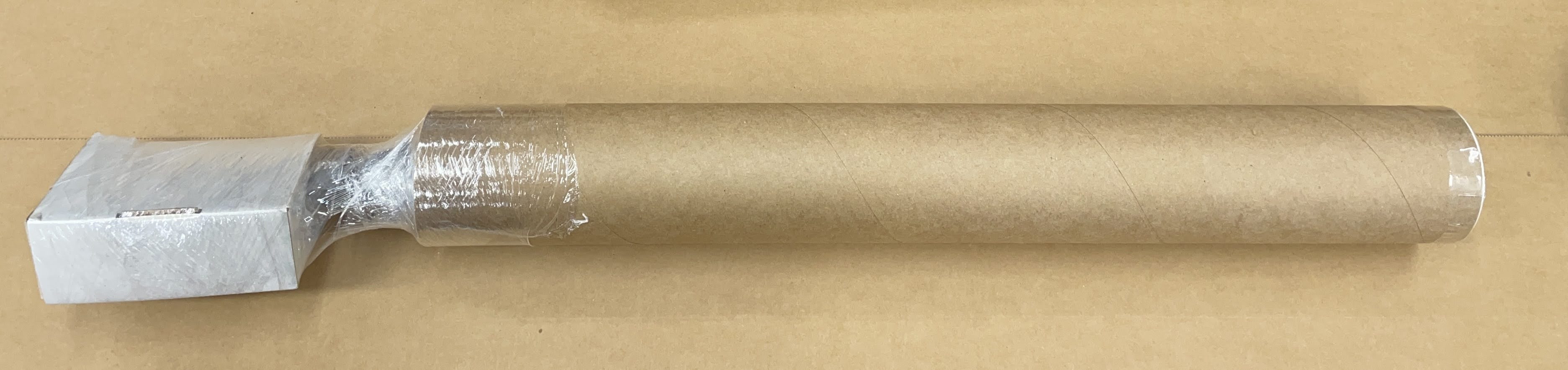

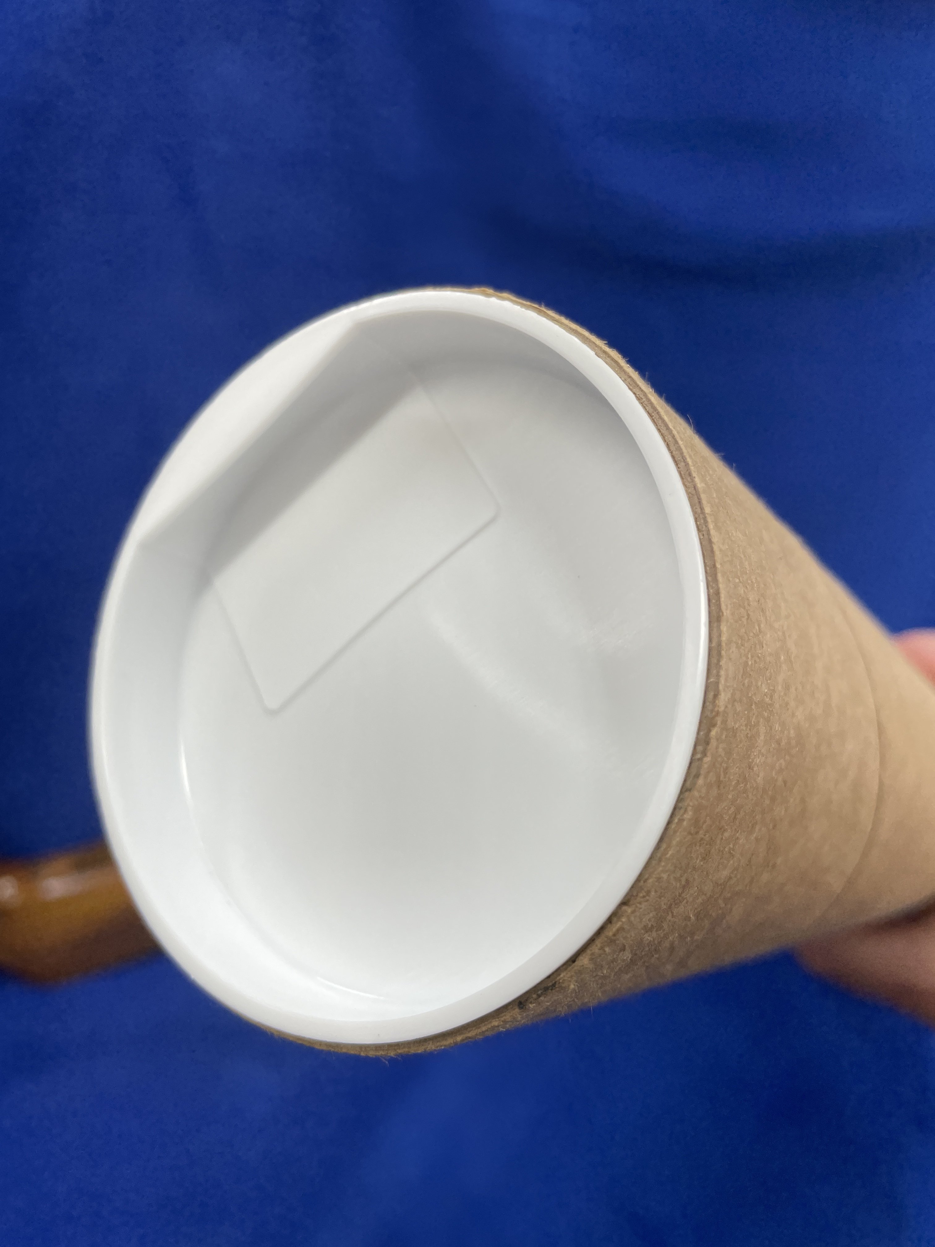

Then placed in a cardboard tube protecting the ends.
Action complete.

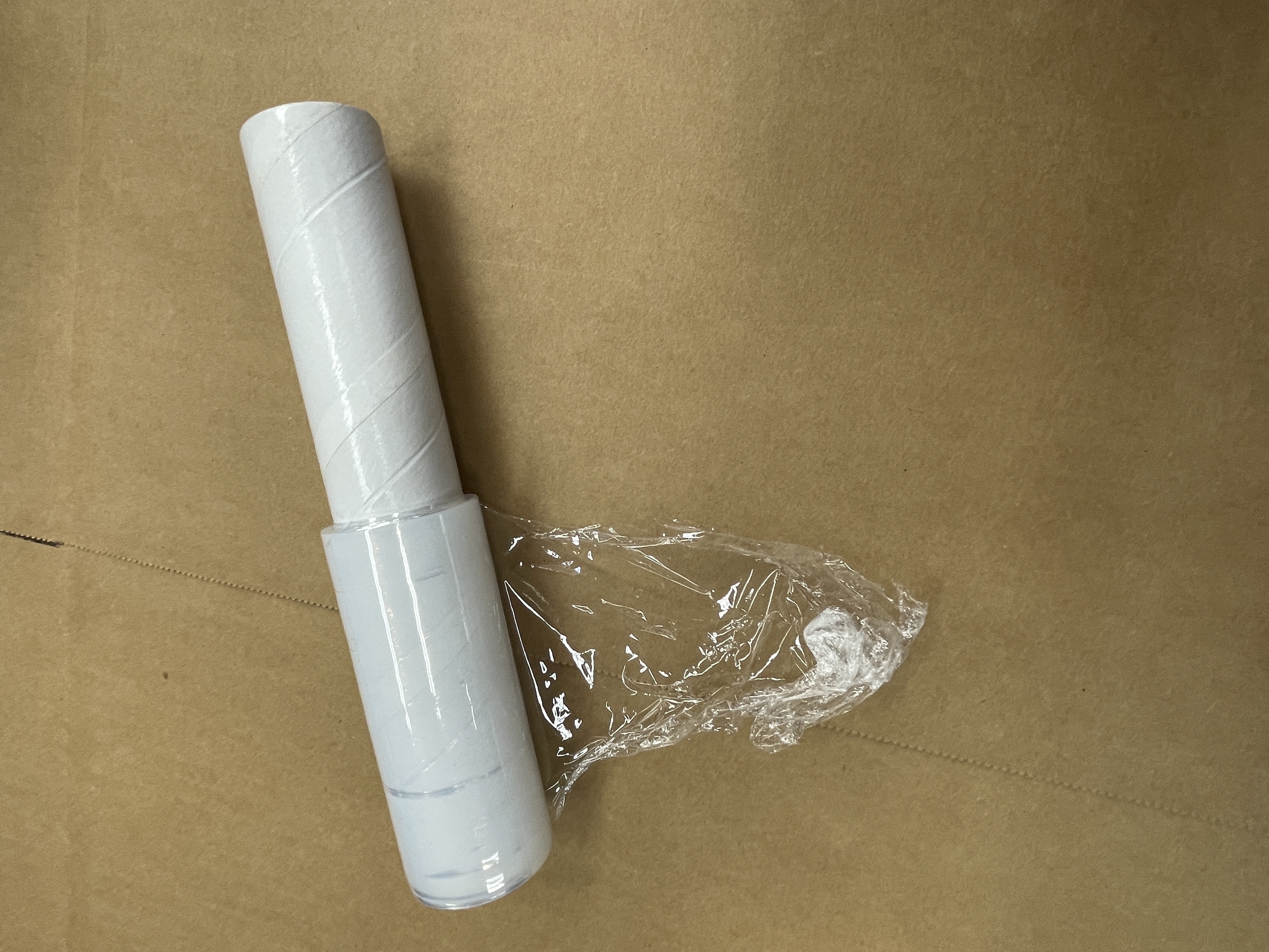

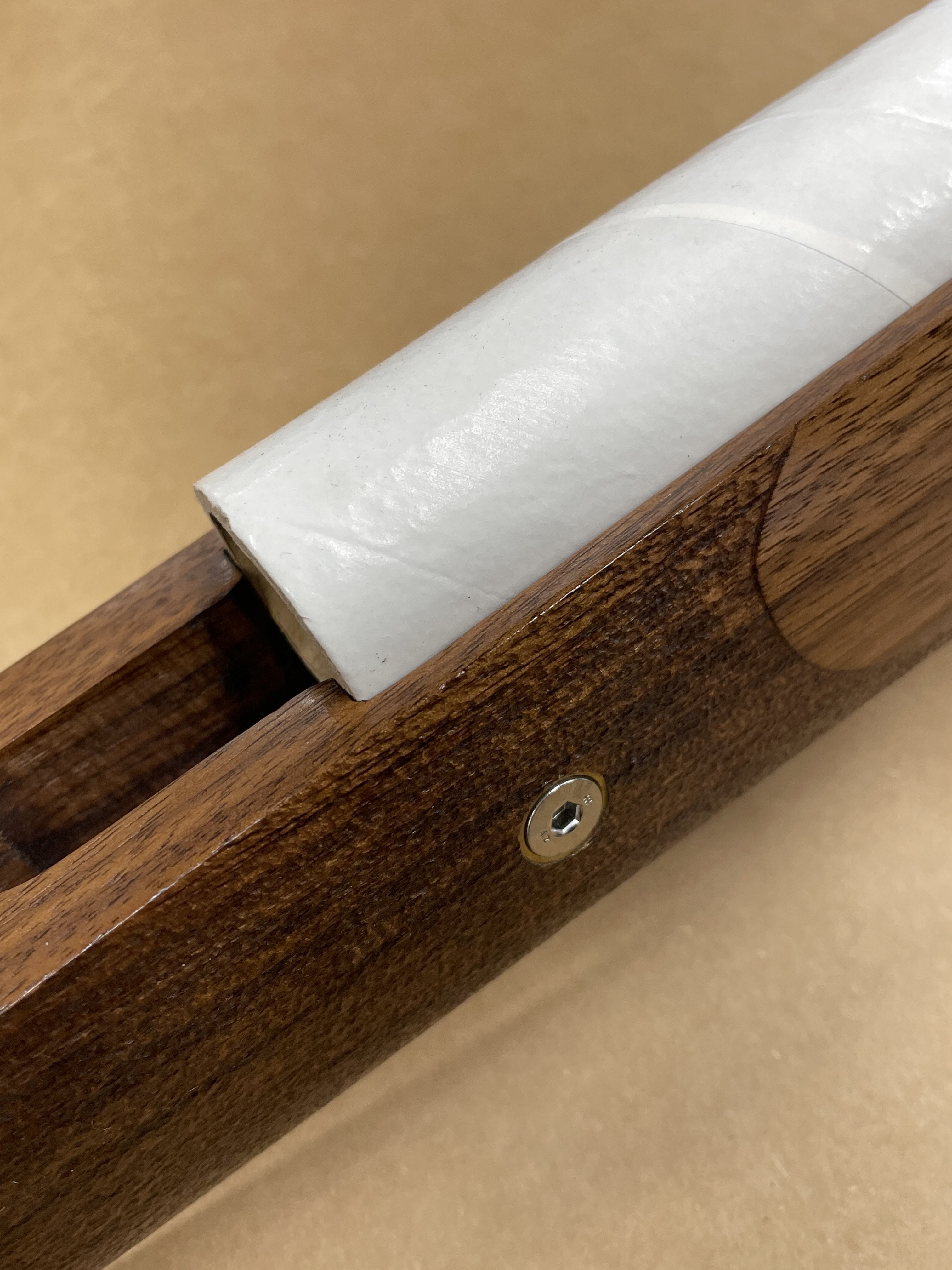

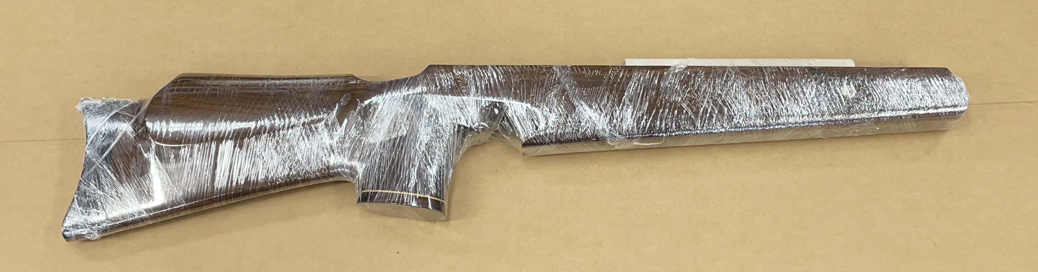

Using a VERY strong cardboard tube or piece of wood, strengthen the forks of the stock (in the case of a springer).
Once again apply a safe oil and shrink wrap.

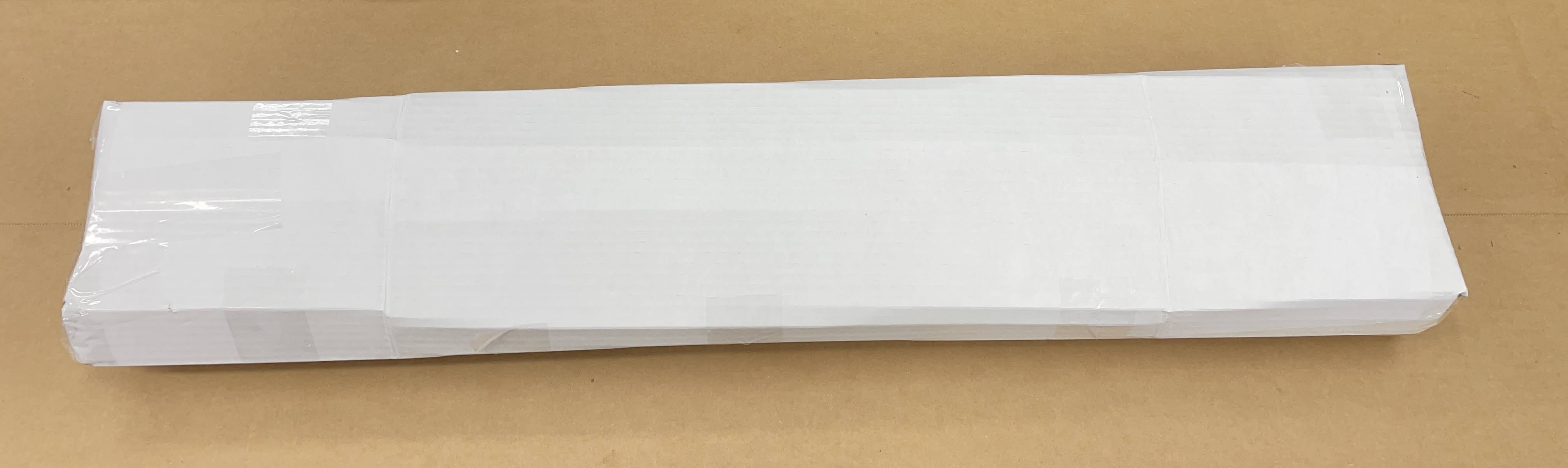

Then cover in Bubble wrap and cardboard, making sure to protect the ends.
Wrap these two packages to each other securely. This prevents any damage from the action rubbing against the stock and also provides rigidity .

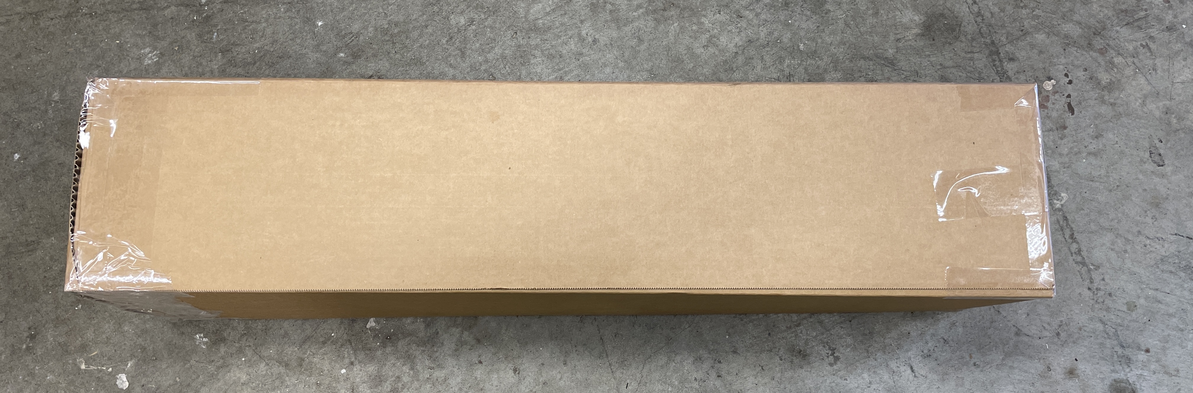

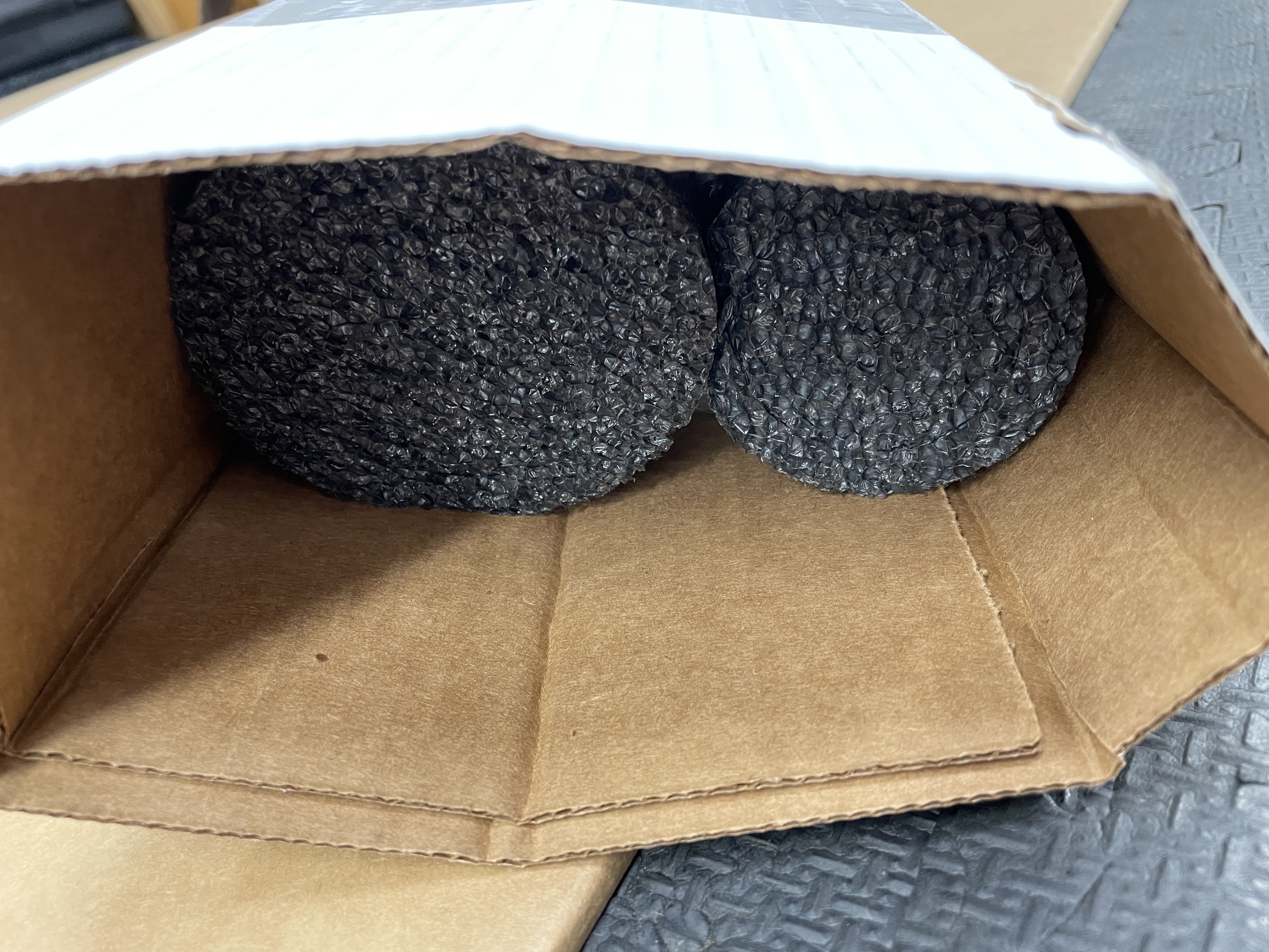

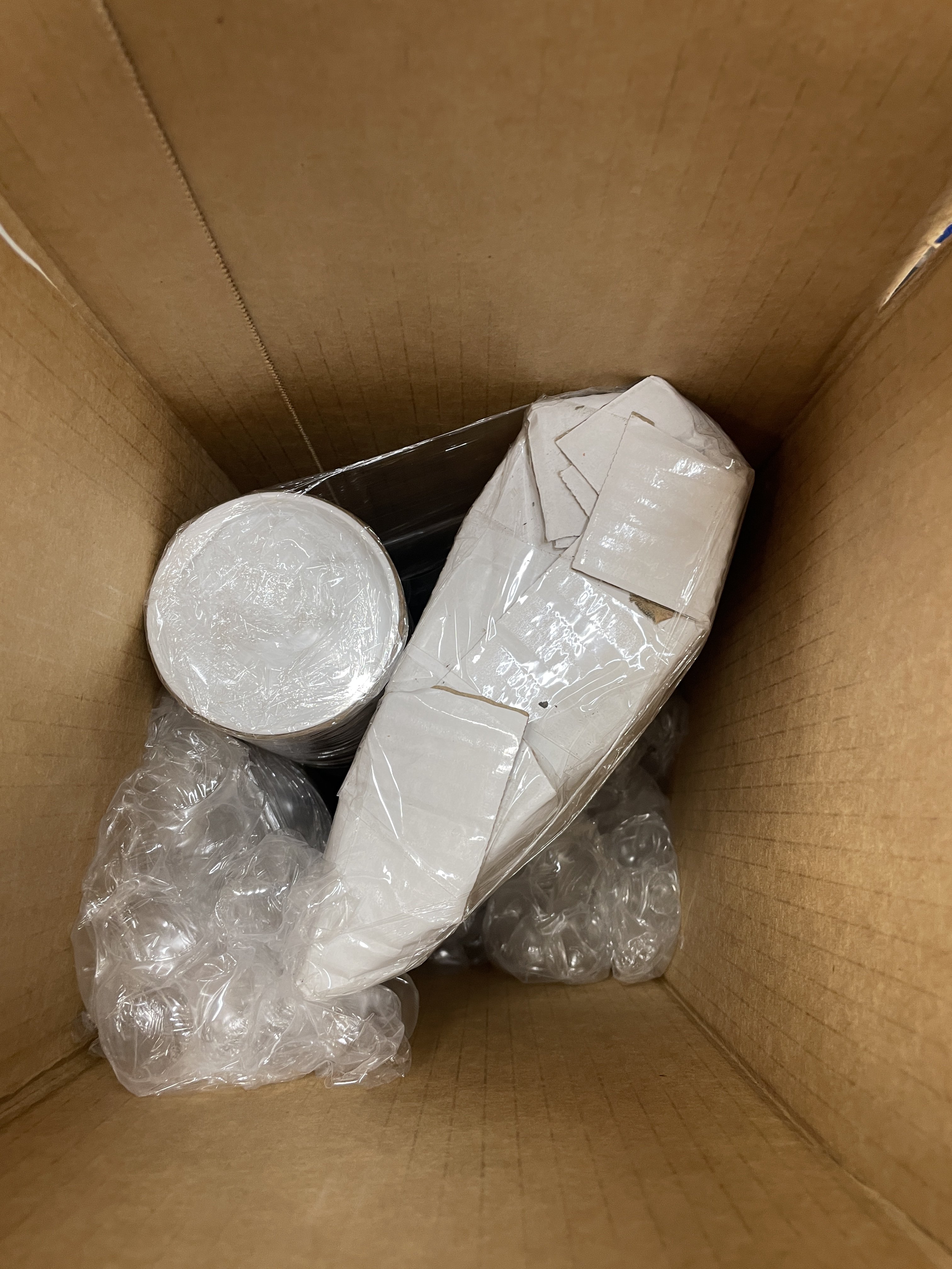

Finally place this into an outer box, fill with packing materials, protect the ends (yes, again).
Now it's ready to go.
Unwrapping is a chore for sure but there is no sticky tape touching the gun and it will survive any commercial shipper.

BTW the shrink wrap has no adhesive. I also hate tape. This stuff isn't bad at all.
