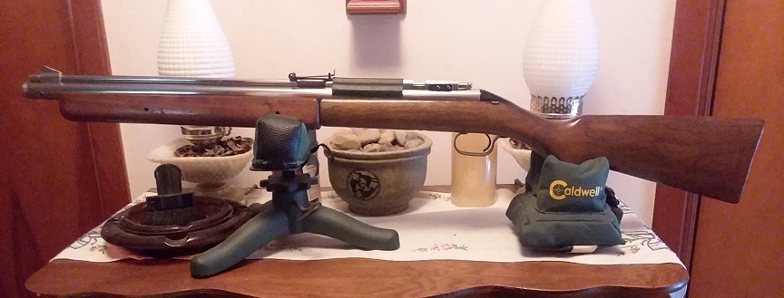

Pretty sure I need a Blue one to go with my Silver so I have the pair. Got mine from a winning Gunbroker bid. Everyone should own one :)
trying to think of just one subject at a time here , usually about 3 different things going on in there .
Mr. dv8 there has tried a couple times to get me to part with my Silver Streak. Not gonna happen :ROFLMAO: . Spotless 1973 that's never been tinkered with and still shoots like new 50 years later :)
