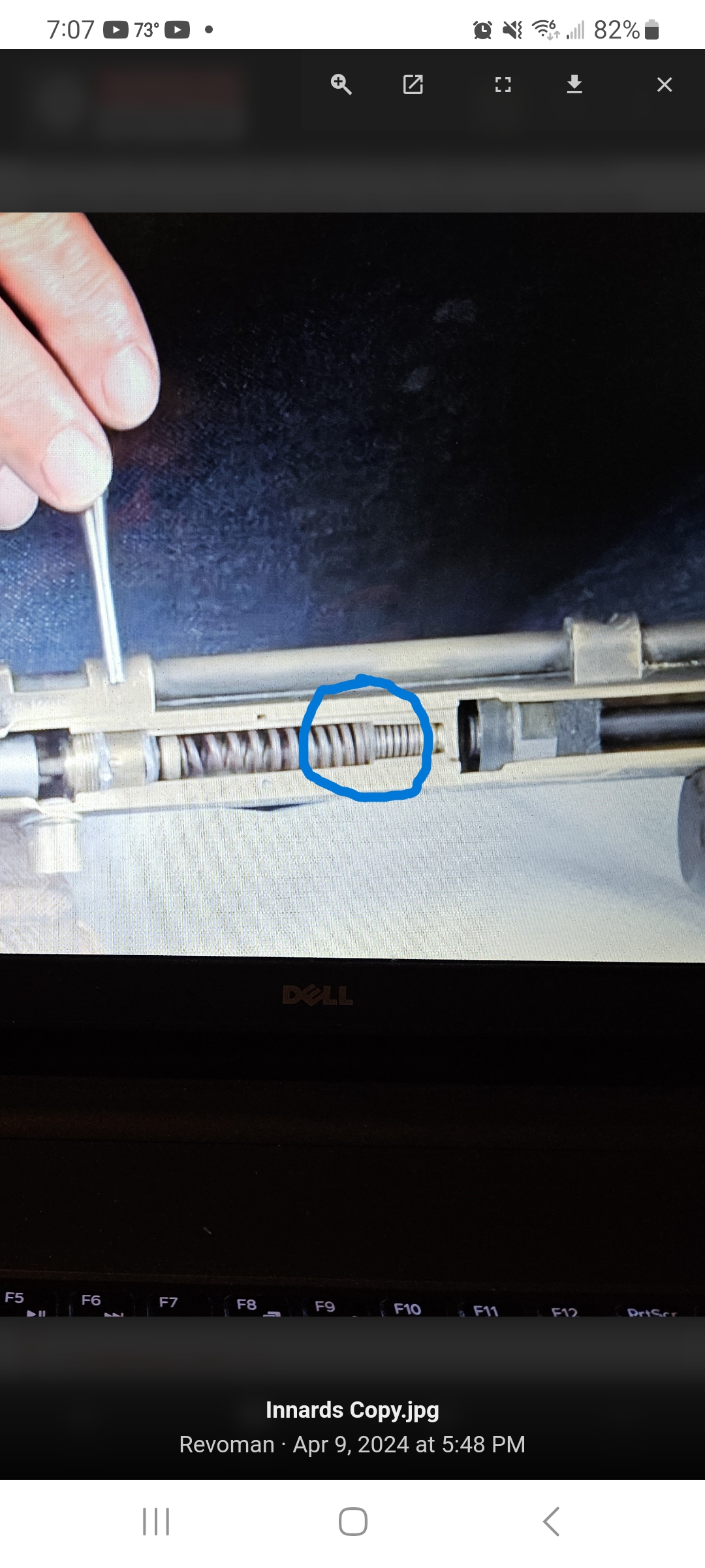

Do you have the washer that seperates the springs installed?
A freind sent me a pic asking me the same question.
Lol
