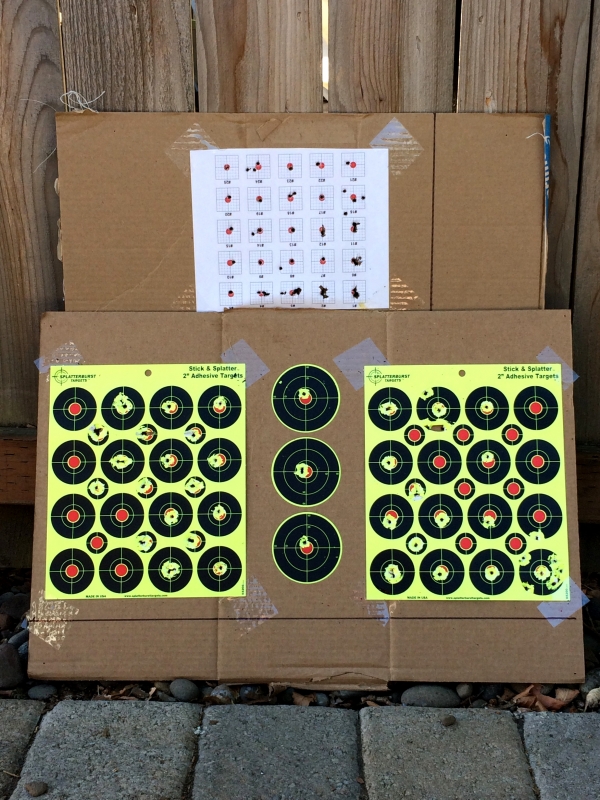

My 50yrd shots from last week. One shot at the target for most of them... if I had a flier or two, I'd try again. The bottom right was sighting in.
75yrd groups were pretty decent ... however, the cardboard was repurposed for our next shoot. Towards the end of the day, 300 pellets, the groups started opening up. She's overdue for a good cleaning.

Great shooting buddy!

I shot quite a few sub 1/4 inch 5 shot groups at 50y yesterday.
Notice how flat the Mid row is, just a little R to L breeze.

Michael... wonderful groups.
Did you change settings on your scope when you changed power levels or did everything remain the same except changing power levels?

I adjusted the turrets when I changed from 75y to 100y. And made a couple clicks here & there. But I did not change between low medium and high on each card. On hi power I did hold under half a mil on some of them.
