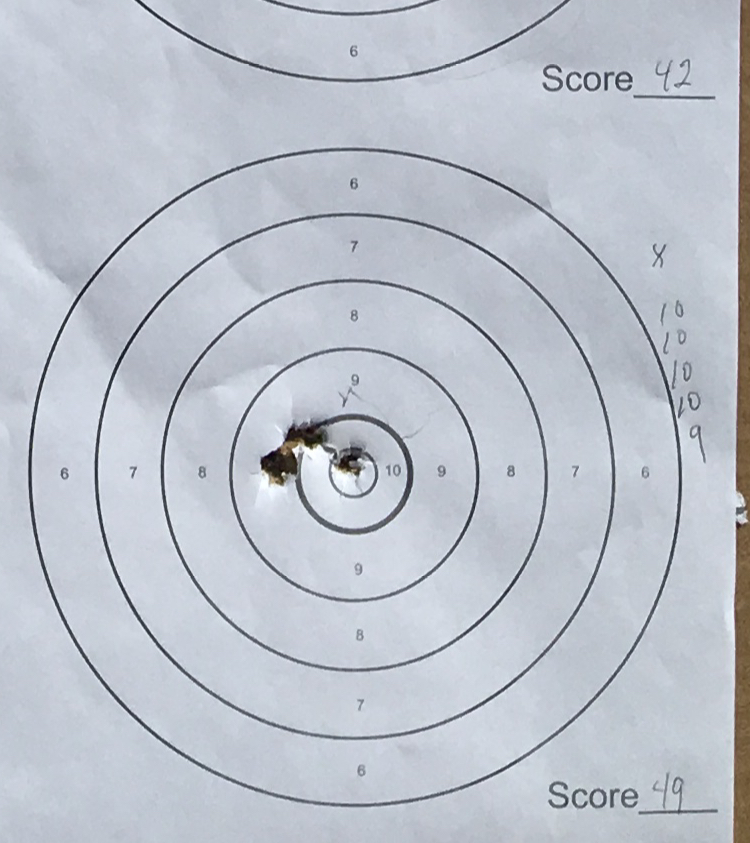

FYI, here’s my best group in actual competition, in the wind at the Saguaro Classic just south of Tucson Apr 28, 2019. We shot ten of these targets, five shots each, 100 yards. Wind was 10 to 12 mph fairly steady. Just inside of an inch 5 shot group. Didn’t measure it… Targets were EBR-ish size.
1572018127_21349662455db317cfebef64.17809737_AE9299A2-A4B3-4EA4-B947-E3D28FC86FCC.jpeg
Fuss, I’m pretty sure you and the Boss would do just fine in the EBR winds. FYI, here’s my best group in competition, in the wind at the Saguaro Classic just south of Tucson Apr 28, 2019. We shot ten of these targets, five shots each. Wind was 10 to 12 mph fairly steady. Just inside of an inch 5 shot group. Didn’t measure it… Targets were EBR size.

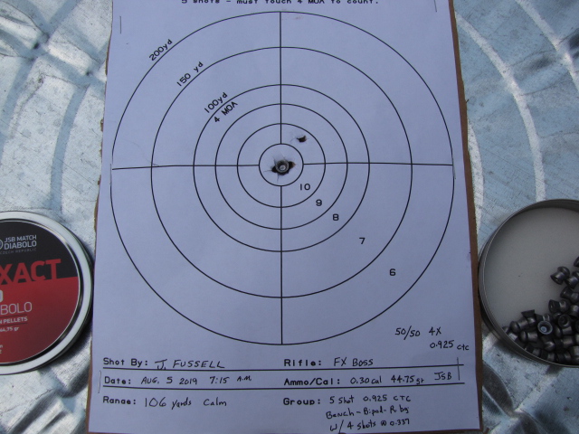

I do zero at 100 yds. I set up two targets at a time and my first target is my sighter. Just six huge 1.5" circles on paper. Then when I feel I've got a decent group zeroed in I move to the first NUAH target. The key is to try and get as many shots in the x ring so yes my POA is usually dead center of that. If my score looks bad on that first NUAH target I go back to the sighter target and make adjustments.
For instance one morning I shot this target on the very first attempt after sighting in on the sighter target. First shot was dead in the bulls eye. Second shot was high, then three more shots in the bullseye. It scored a 50/50 with 4x's and measured 0.925 ctc. To me that was my best target ever even if it was a 0.925 ctc because I had 4 x's.

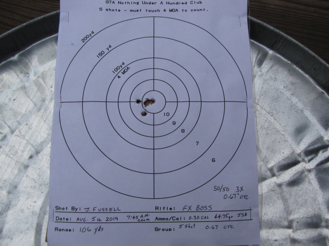

That particular morning on my second target, the group was even tighter at 0.67" , but only had three x's
If my group seems to be moving to the left as in this photo, sometimes I will aim a pellets width to the right but not much, because if the pellet does go where you aimed you're screwed? So yes I am moving poa just a fraction inside that x ring from time to time. So I guess I'm more concentrated on trying to get that ever elusive 5 x's than actually shooting for group size.

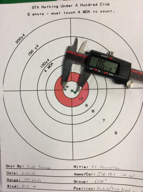

The only person I know of who has shot a 5x in NUAH challenge is Brett Peterson with a .22 FX Streamline shooting the 18.1 gr Jsb's. Now if I had shot that same group with .30 cal it would have probably been a 4x?
1572109151_13995911035db47b5f9b9ef7.33216417_50 50 5 x .651 ctc best score at GTA NUAH.jpg

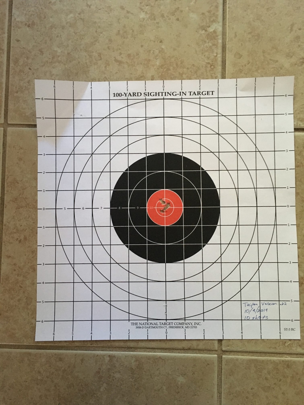

Oh and here's a killer 10 shot group indoors with my friend Chan and his .22 standard Taipan Veteran. This is the type of group that makes me drool!
1572109519_16250536505db47ccf704dd7.87343600_chans 10 shots at 100 indoors.jpg
And that is why I wish there was a such thing as an indoors EBR ;-)

B-t-w: that perfect 50/50 5X group with JSB 18 is spectacular Brett!
