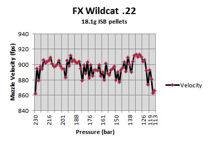

Hi Paio -
For your reference, my stock .22 Wildcat has an extreme spread (ES) of 36 fps or 4% variation for 66 shots. Your 15 fps ES seems pretty good compared to mine.

"parallax"Hi Paio -
Thanks parallax. Your regulator has the same pattern as mine. The initial velocity is lower than the average ones and similar to the last shot. Assuming the regulator is 120BAR I think I have to stop shooting at 130/125BAR so the first shot speed will be higher. I don't believe FX regulators cycle properly when we refill the gun. It cycles when I shoot. I wonder how the Huma regulator works.
