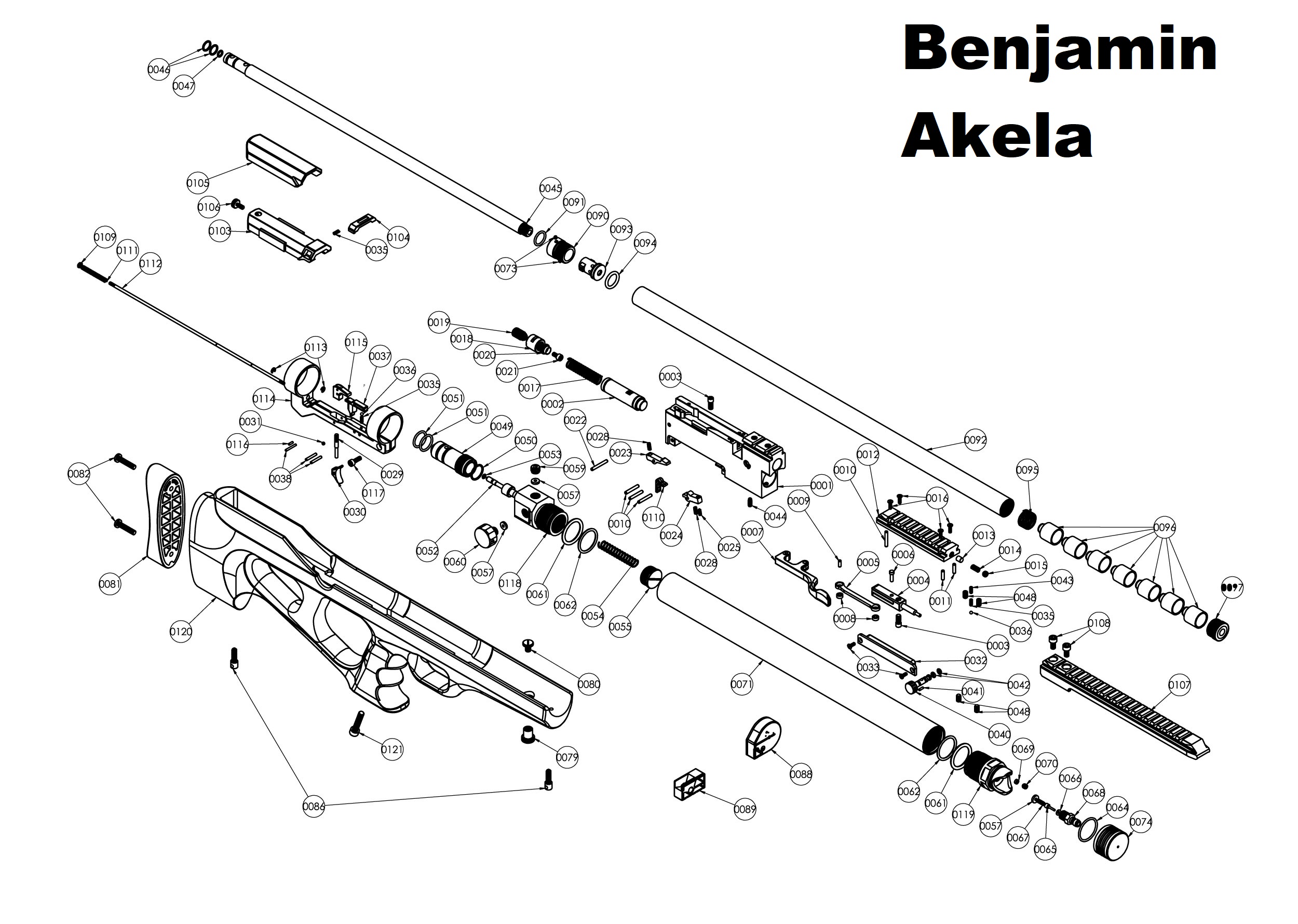

Sent an email to Benjamin and they replied with an email including a parts diagram and parts list with a number to
contact Crosman/Benjamin service dept. I contacted them and ordered the set screw. It is an M3x2 for anyone who is curious
about that. Due to shipping cost and added order fee, I decided I would get an extra screw, just in case, and the trigger
that the set screw threads into. Total cost $22.26
I will attach the parts diagram in case anyone needs it. Prices are not listed.
Customer Service Crosman Corp. 1-800-724-7486
