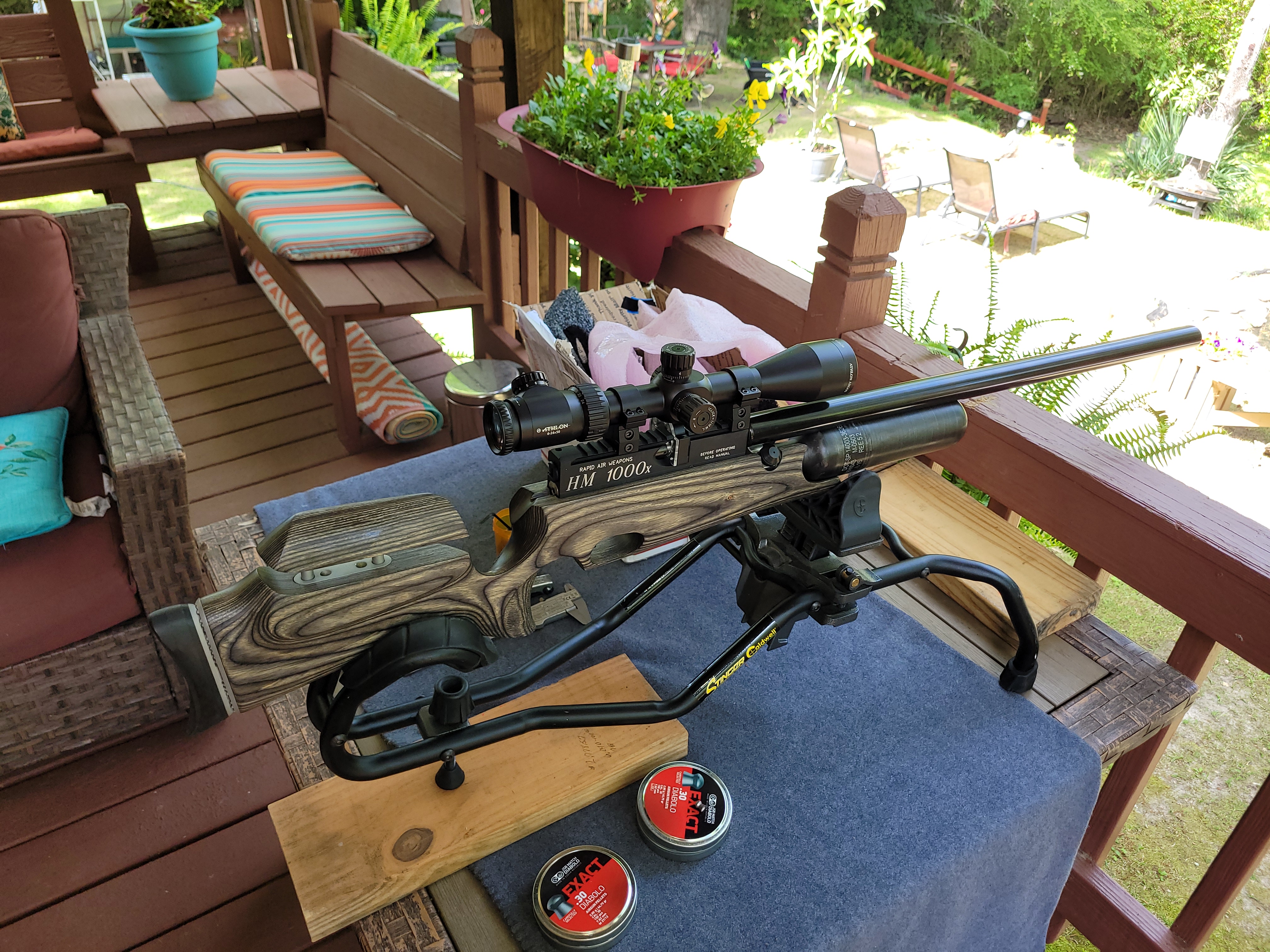

I just got a new Raw hm1000x Blue laminate .25. Just got is all set with an Arken 5-25x56 and a Impulse Air 1325 moderator. I shot 5 Magazines and all of a sudden the pellet probe is just flopping around loose. WTF? Is the fix for this tightening the little grub screws? I can’t find an allen wrench that small in my tools. I’ll have to pick one up.

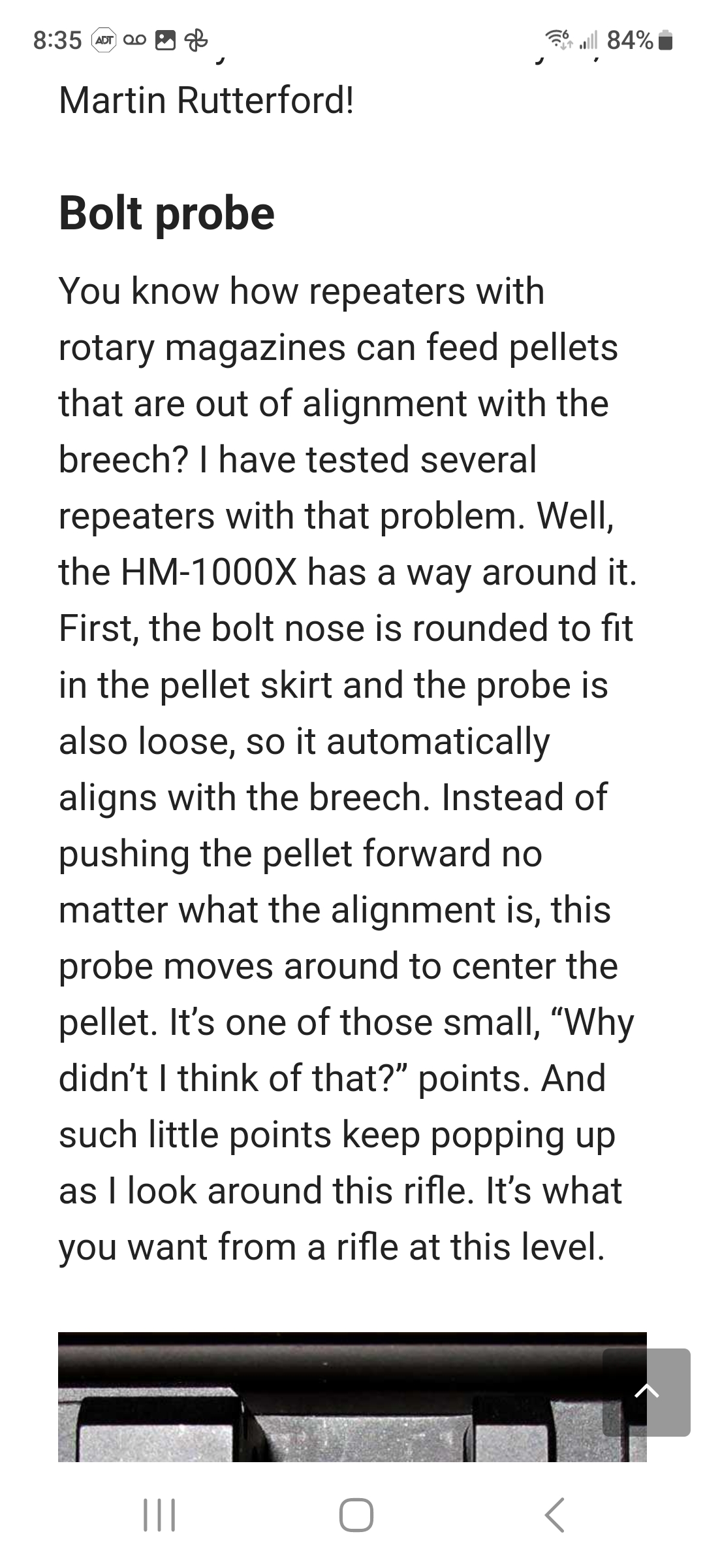

I’m pretty sure it’s a machine steel to steel sealing surface with no rubber. At least the 3 HM1000X’s that I owned were that way, unless something has changed in the latest iterations?
Note from Martin: No oring on probe/barrel. The tolerance is that good.
In some of the older versions of the probe, there was also a grub screw to lock the probe length adjustment thread in place.
But these days all that’s used is locktight.
There is no oring or rubber seals in the raw probe assembly. Simple tight machining to seal the air out of the inner probe. And the steel on steel tapered seal at the breach.
Imo, the best probe assembly I’ve used or seen in an air gun. Always the same, no scraping or scratching…it just feels good. That snap…when it goes home..just awesome.

That being said, if that pin bends it will jam up the probe inner and outer movement.
It shouldn’t make the whole probe assembly fall out of the carrier…
