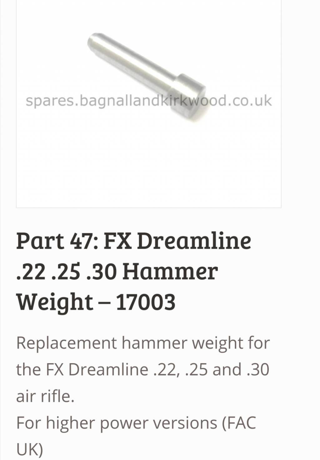

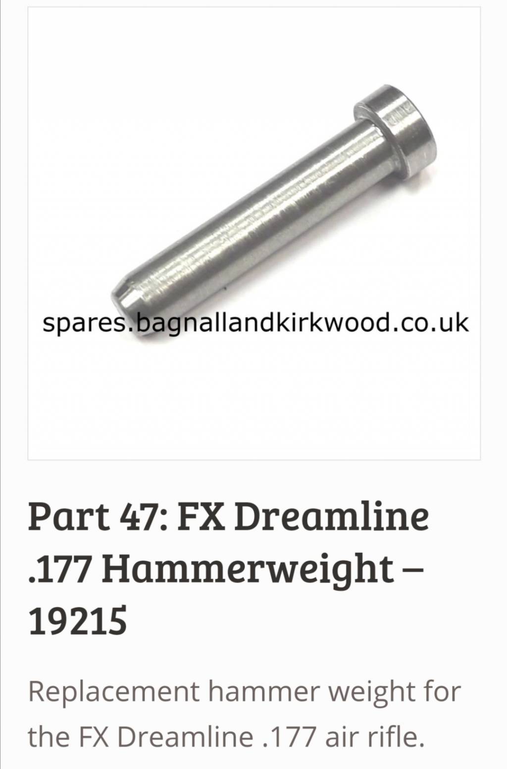

Searching in internet i found that there are two different hammer weight
This is the one that i have
This is the one that i should have
Could this be the problem?

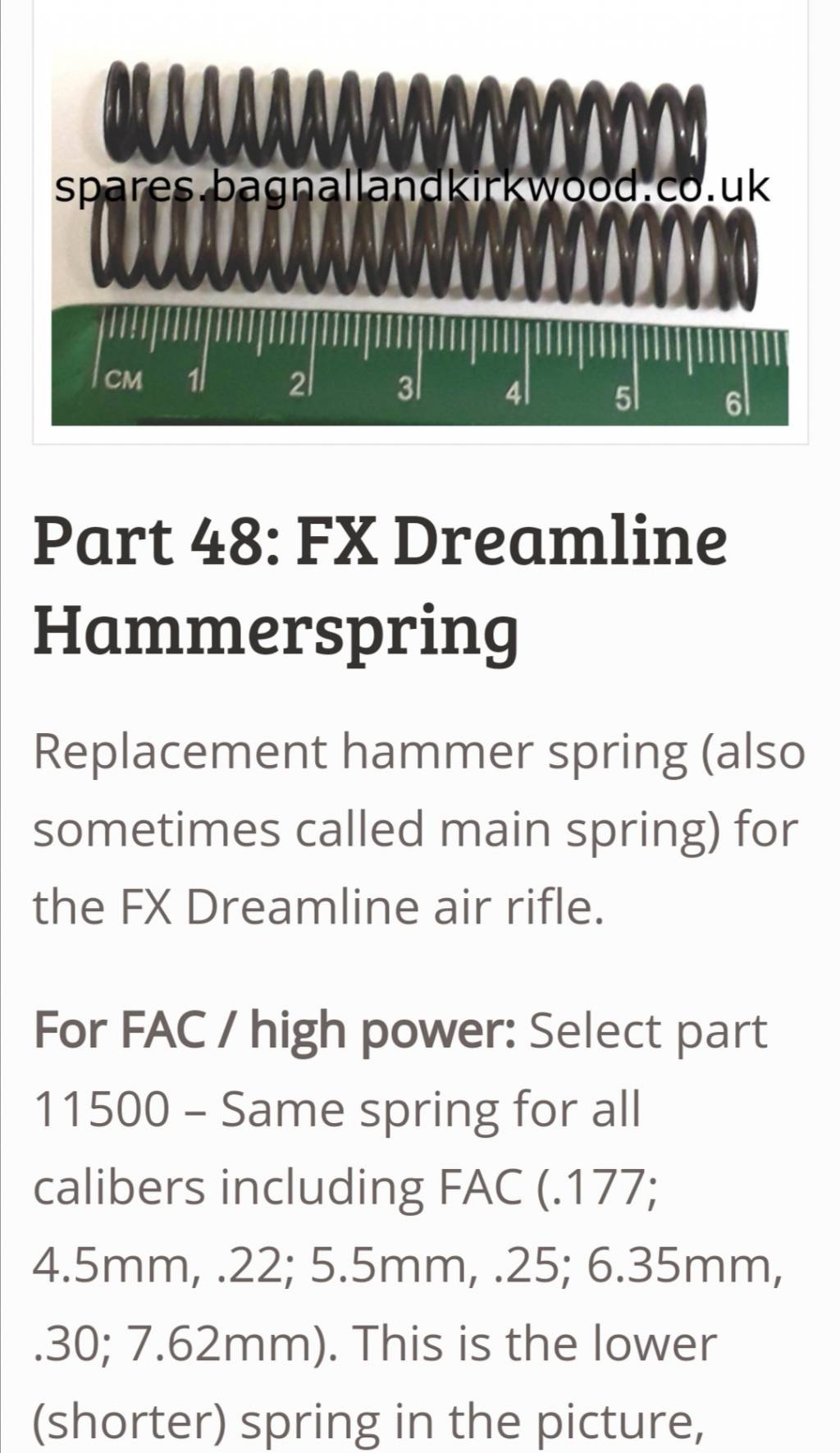

I measured my spring and is correct
